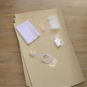

  1. 2 mm felt (outer shell)
  2. Non-elastic cotton fabric (like Muslin of Calico)
  3. Polyester fiberfill (and optionally micro-granules for bust filling). You can also use leftover batting, fabric scraps, etc.
  4. Boning strips or Rigilene (5 mm & 10 mm or ½" & ¼")
  5. Bias tape, thin satin ribbon (3 mm)
  6. 4–5 mm corrugated cardboard (inner frame)
  7. Metal or plastic pipe to fit on the stand (optionally)
  8. PVA glue, Hot glue gun, scissors/knife, sewing machine (capable to sew zigzag)
  9. Printer (capable to print “real size”), pins, iron, tailor’s ham (optionally)
