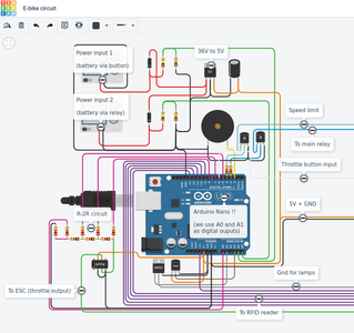

Here is a document with the electronic circuits of the e-bike :
Step 4: The Main Circuit
The main circuit board was the most complicated thing to do in this build. The circuit must be able to lock and unlock the bike, control the throttle output from the motor, control the speed of the bike (to be legal on the road), power the lights, prevent an over-discharge of the battery and turn off the bike at the end of a ride.
The main component of this circuit is an Arduino Nano. Most of the components here come from old electronic projects or old electrical devices. I even used a triac from an old kitchen robot as I didn’t had a mosfet laying around to control the lights.
Here is a more detailed explanation of how the circuit works :
(see the PDF of step 3 for the exact layout of the circuit)
(click on the first picture to see to which area of the electronic circuit the numbers below refer)
  1. Power input : There are two power inputs. To start the bike, the user must press the power button which powers the card through the first input. The Arduino waits for the user to present the RFID card before activating the main relay (see point 6) which powers the card through the second input. The user can then release the button. The card is only powered by the second input during the ride. The diodes prevent electrical current from flowing back into the unpowered input of the circuit. The resistors form a voltage divider bridge which allows the Arduino to read the supply voltage (this allows the Arduino to cut the power if the voltage is too low).
  2. This part contains two step-down converters. The input voltage (between 30 and 42V) is first lowered to 12V by the first module. This voltage is used to power the lamps of the bike. The second module lowers the 12V to 5V, which is the operating voltage of the rest of the circuit.
  3. We find here a buzzer, a capacitor and a triac. The buzzer makes a noise when unlocking the bike and makes an alarm when the voltage is too low. The capacitor smooths the 5V voltage at the output of the step-down converter. The triac controls the power supply (and thus the lighting) of the lamps (it would have been better to use a mosfet here but I did not have one at hand)
  4. The Arduino Nano takes a lot of space in this part of the circuit, but there are also some connectors, for example for the RFID reader, for the relay and for the gas button. The relay is controlled with a transistor because the Arduino can't deliver enough current to activate it.
  5. The last part of the circuit contains many resistors, forming an R-2R circuit. This is the throttle output, which comes out of the Arduino in binary on four digital outputs and is transformed into an analog signal by these resistors. This analog signal passes through an operational amplifier to avoid a voltage drop. This signal can then directly be interpreted by the ESC (Electronic Speed Controller).
