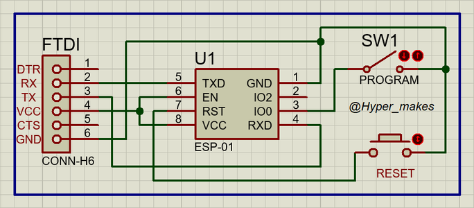

Step 3: Wiring Schematic
Follow the wiring schematic provided in this step and do all the wiring connections accordingly.
I have used thin enameled copper wire for all the connections. It is my personal preference as it keeps the project wiring clean.
Remember: We are using the latch switch as our "programming" button whereas the momentary switch to "reset" the ESP-01 WIFI module.
