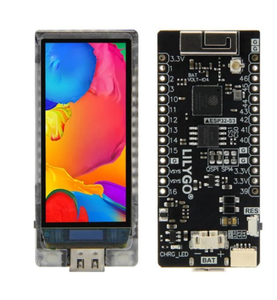

  1. ESP32 Lillygo- Amoled t series display

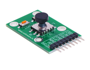

  2. 5D Rocker joystick

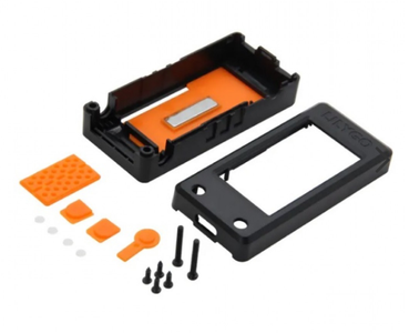

  5. lillygo case
Step 1: Desolder the Joystick From Module
desolder the joystick from the board

Step 3: Connect RDA5807M to ESP32
44-SCL
43-SDA
Step 4: Solder the Joystick
Step 5: Connect the Joystick to Esp32
BTN_UP 13
BTN_DOWN 11
BTN_LEFT 12
BTN_RIGHT 15
BTN_ENTER 14
