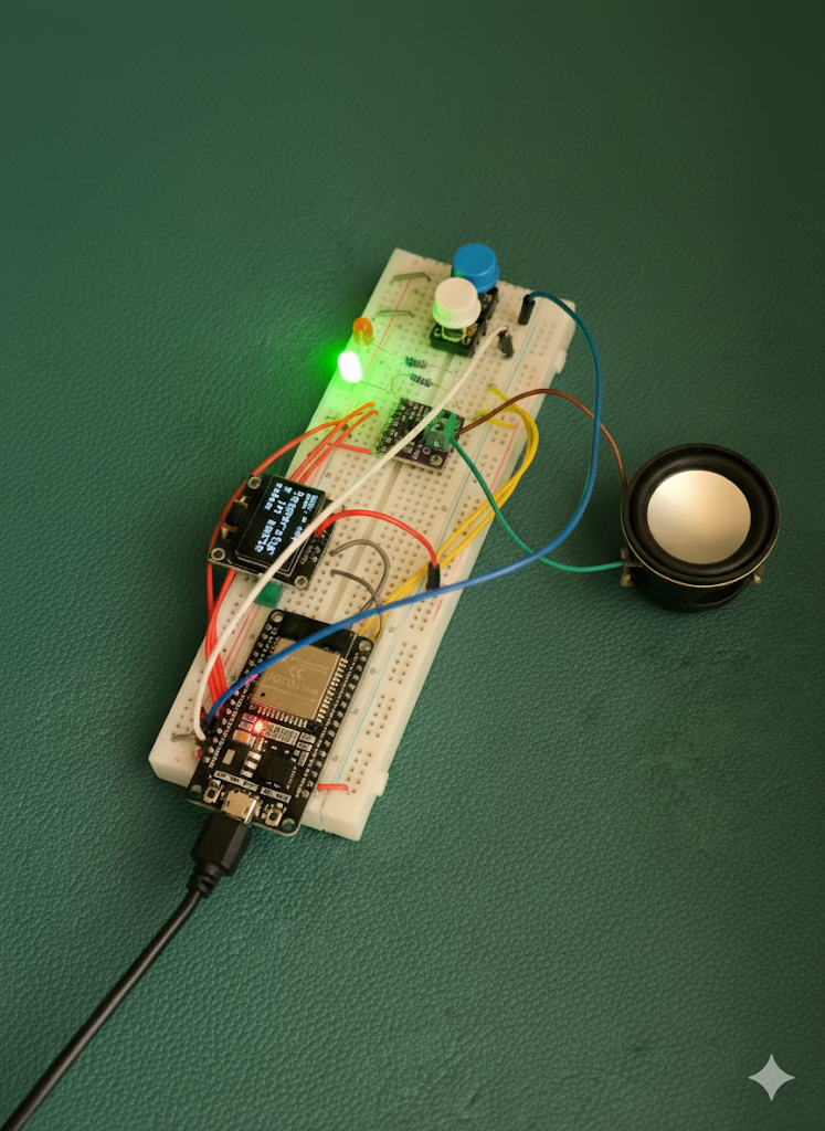

Step 1: The Wiring - Connecting Everything Up
This is where the physical build comes together. Take your time, double-check connections, and ensure your ESP32 is powered off while wiring. All GND pins from components should connect to a common ground rail on your breadboard.

Step 4: Testing the Voice Assistant
Operation: Your AI Assistant Is Ready!
  1. Status Check: The OLED should display "Ready" and the inbuilt RGB LED should show the "idle" color.
  2. Start Recording: Press Button 1. The inbuilt RGB LED should change color (e.g., to green) to indicate it is listening.
  3. Speak: Ask your question!
  4. Stop/Timeout: Recording will stop after 6 seconds or when you press Button 2.
  5. AI Response: The OLED will show "Thinking..." and then the response audio will play via the speaker.
