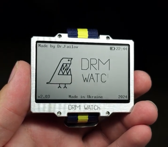

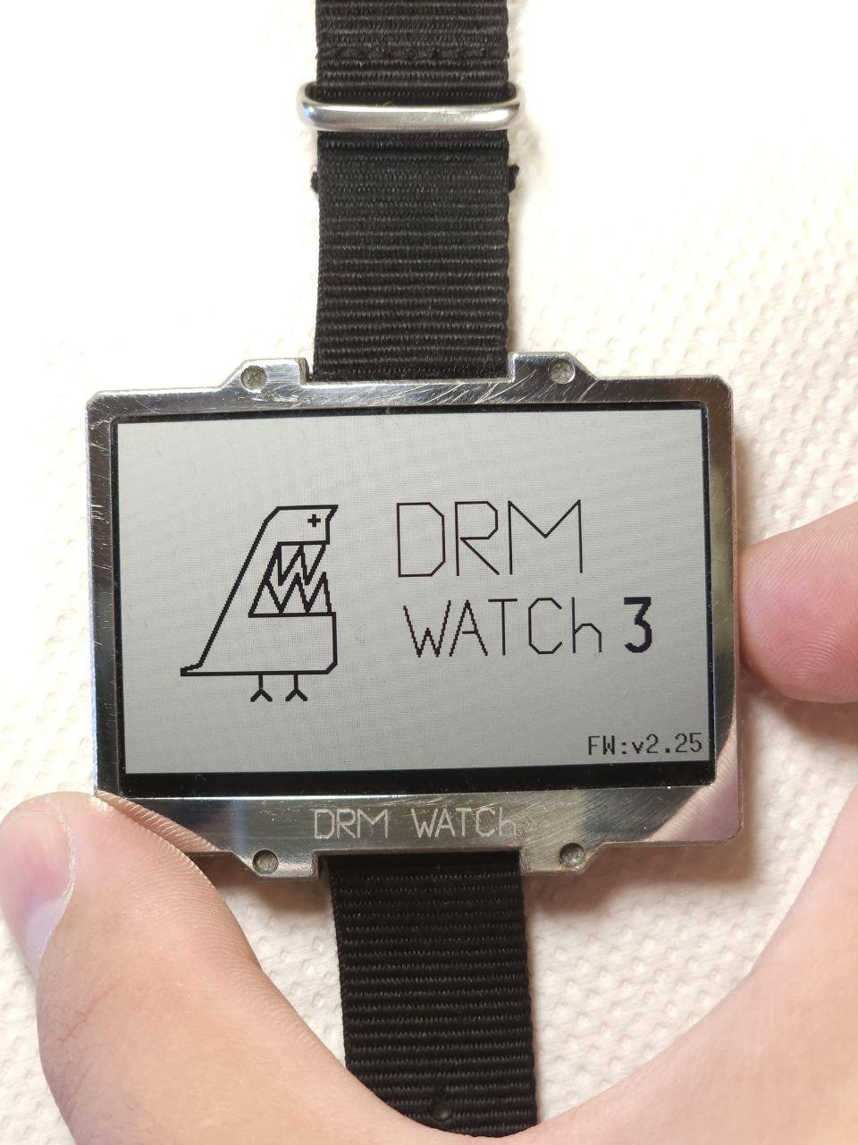

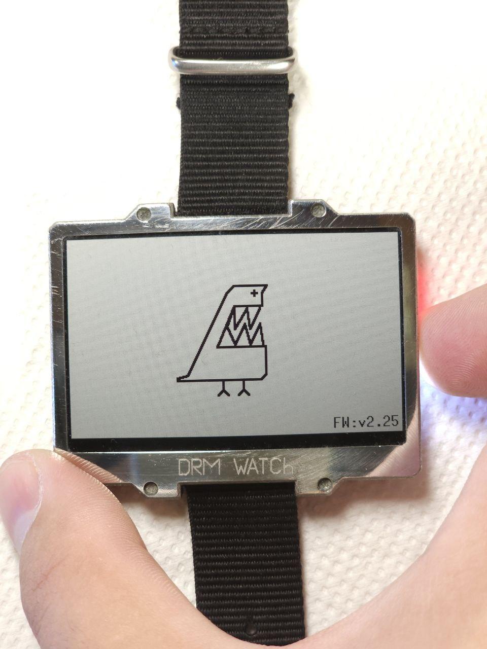

DRM Watch 3 is my self-made wristwatch based on a Sharp Memory LCD display, ESP32-S2 and the desire to wear it on my hand :)
This is NOT a "Smart watch" ! This device in its functionality is close to a regular electronic watch, with several additional features, and you can add them, reprogram the watch to suit yourself.
Currently, the firmware has all the features inherent in a typical watch and allows you to fully use it on a daily basis.
Watch parts cost about $70 in total.

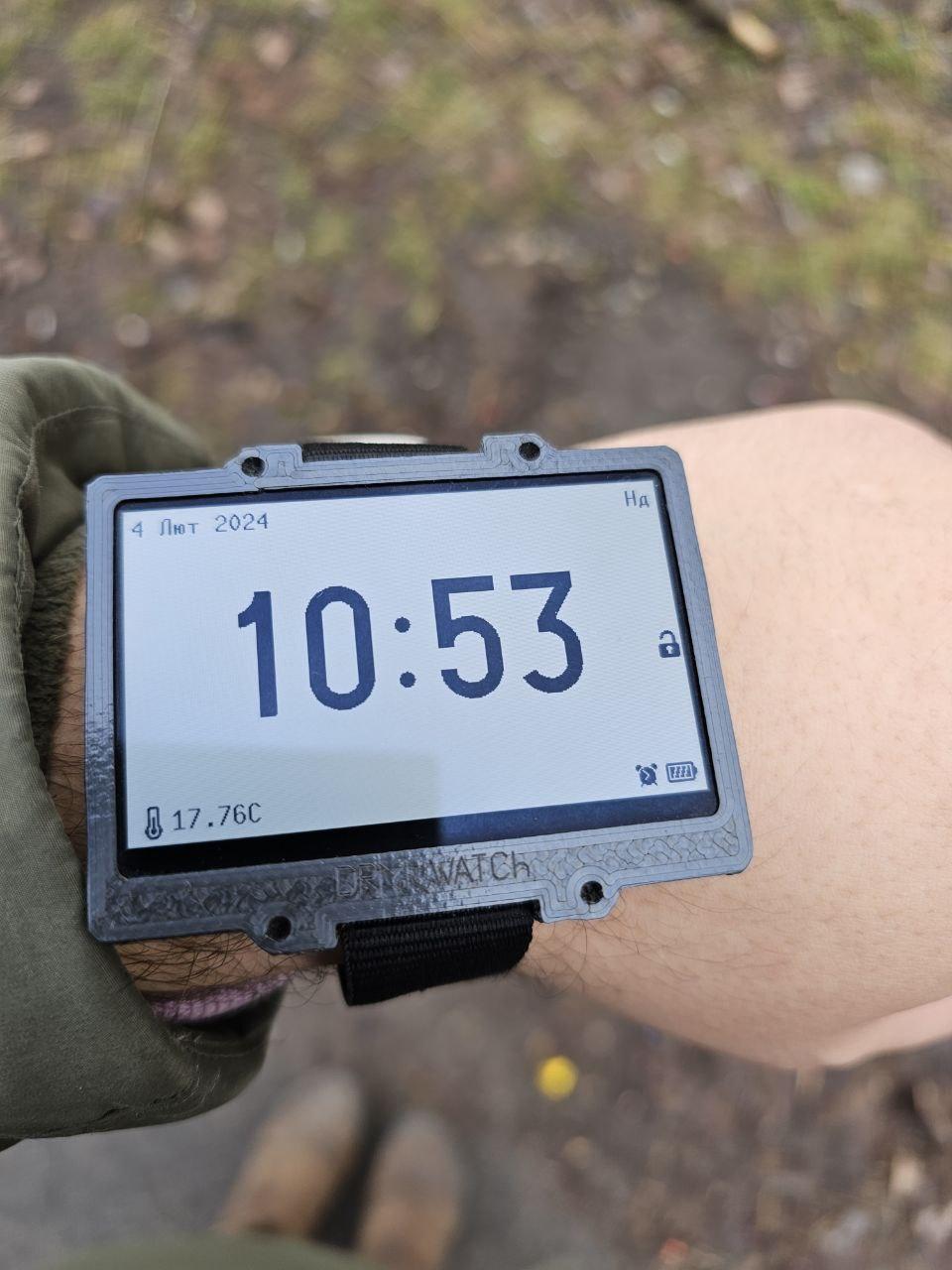

  1. Works stably and is suitable for daily use;
  2. The display always shows the time;
  3. The battery lasts for more than 14 days, there is a charge indicator;

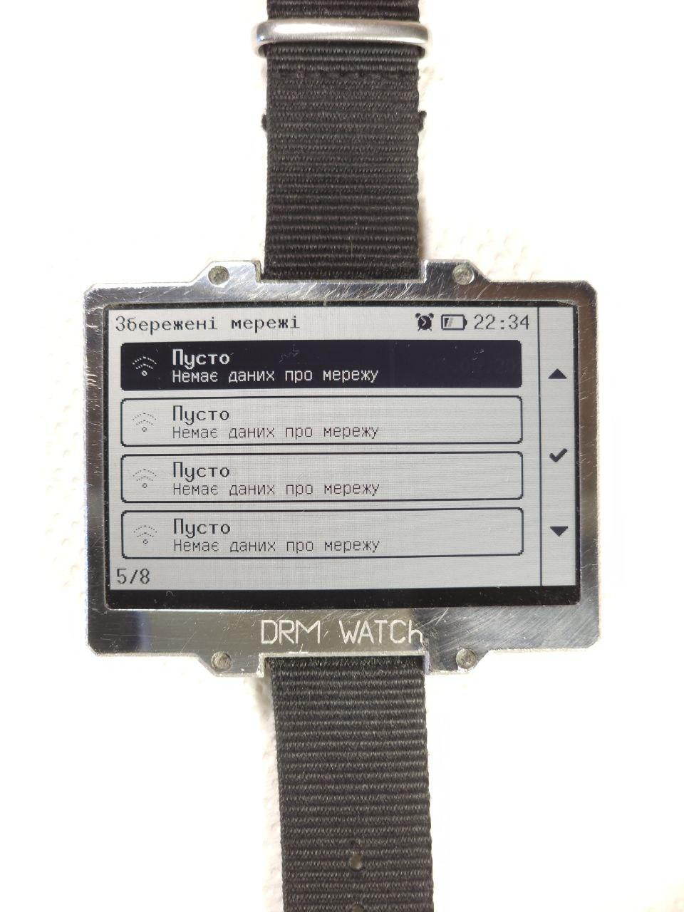

  15. Availability of Wi-Fi, you can save up to 8 networks in memory;

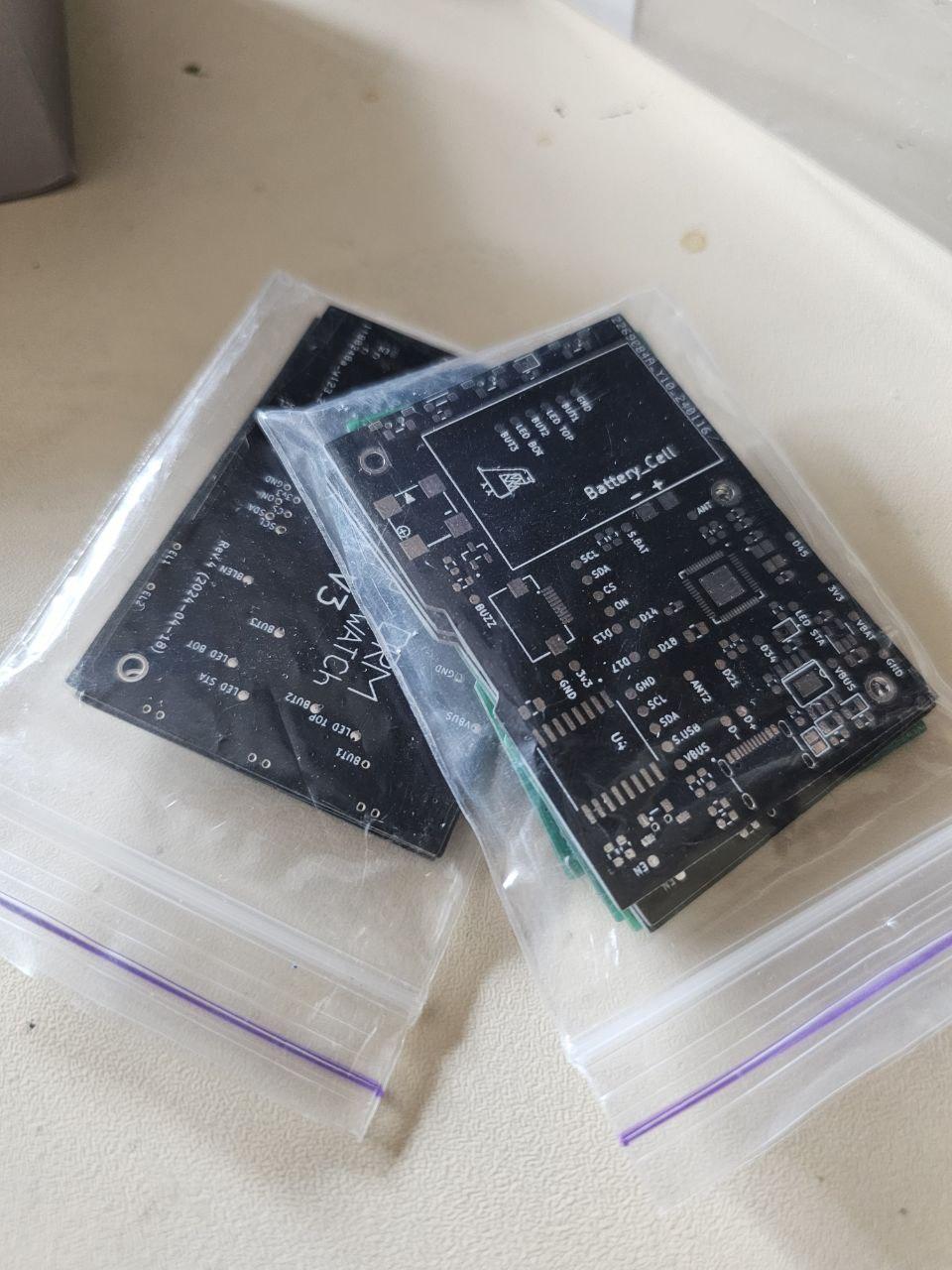

Step 1: Order Board
Use gerber files to order board. I ordered on JLCPCB.
Download GERBER here .

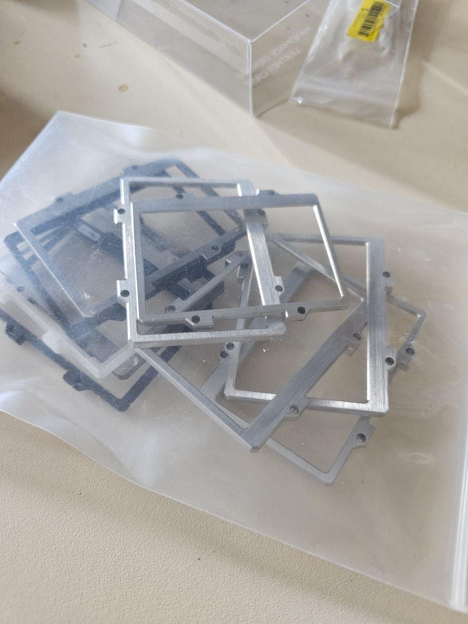

Step 3: Order Machined Front Panel
The best looking front panel is CNC machined. You can order CNC mchining using STEP files included.
If you don't want to order CNC machining, you can 3D print this panel, result is still very good.

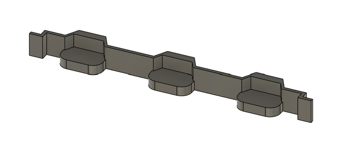

Step 4: 3D Print Back Parts
Any plastic. I used PLA.
Print back part - any color you want, I used black.
Buttons part - transparent color to make flashlight visible.
Step 5: Assemble the Board
Solder all parts according to its places. You can follow pdf soldering plan, or download KiCad project here.
There's a lot of micro soldering.
Also add 24mm wire to ANT testpoint. It works as Wi-Fi antenna (really bad antenna but it works).
You also can order PCBA service to get assembled board using BOM and GERBER files.
Optional testing semi-assembled watch: after soldering resistors, capacitors, USB connector, buttons, voltage regulator, ESP32 chip and quarts. Battery not connected. Short jumper on up-left corner of board (it will bypass charger to let ESP be powered from USB). Hold UP button and connect USB. Device should be recognized. You can flash it with flasher. Press reset button - watch should start. Don't forget to remove jumper before soldering battery!
After assembly i'd recommend cover components side of board with B7000 glue to cover all the contacts. This will protect this side from water and moist.
After assembly i'd recommend cover empty side of board with captone tape. This will protect this side from water and moist.

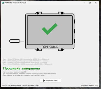

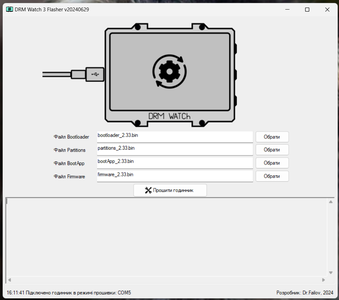

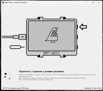

Step 6: Flash Board
To make assembly process as easy as possible, I made flasher to flash board by one button.
Here you can download flasher (download any version you want)
Here's how to use it
1) Open flasher
2) Connect USB cable to board
3) Hold "Up" button
4) Press "Reset" button
5) Release "Up" button
6) Press "Прошити годинник" (flash watch)
7) Wait while flashing complete
8) Disconnect watch
9) Press "Reset" button.
Watch should start now.
Firmware update process is the same, user data will not be deleted.

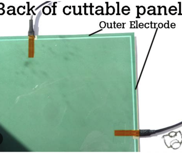

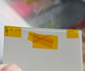

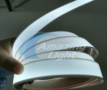

Step 7: Prepare EL Backlight
The electroluminescent panel (EL panel) is an integral part of the lighting system. This is a panel that glows under the influence of high voltage and frequency. They are also called light-emitting capacitors (LECs). These are just interesting facts to better understand what it is.
The trick of this type of backlight is that the panel is very thin, shines very uniformly in a pleasant blue color, and it can also be cut into pieces of the desired shape. But after cutting, the task of connecting to the panel is difficult. I used single core wires and conductive glue for the connection.
Cons: being located behind the display used here, it is barely visible, but it is enough at night. It also squeaks a little while working. And for its operation, a rather complex driver scheme is required.
I advise you to buy the blue color, because the EL panel is naturally of this color, and it is stupidly painted in other colors, and the paint absorbs part of the light. If a painted panel has arrived, it can be cleaned of paint with a blade.
In dark night you will be able to see big clock.
EL panels is cuttable, and on its edge is located 2 electrodes - outer and inner.
1) Cut panel in pieces which fits screen size
2) Use very sharp knife to gently cut back side of EL panel lamination. Make 2 cuts (over outer and over inner electrode)
3) Push thin wire under lamination to somehow contact the electrode.
4) Add condictive glue to make better contact.
5) Place thin wires for comfortable connection to EL1 and EL2
6) Add captone tape to back side of EL panel to protect thin wires.
7) Solder EL1 and EL2 to panel. Polarity doesn't matter.
8) Check if it works.
9) Fix EL panel on board with small pieces of scotch tape to prevent damaging this wires.

Step 9: Assemble the Watch
When all parts are tested and works, it's time to assemble watch.
At first connect LCD, then isert buttons in back panel, then screw back panel to board, then screw front panel to back panel.
Pay attention to LCD+Backlight thickness! If frame is pressing too hard on the display, it can brake instantly or start degrade slowly over time.

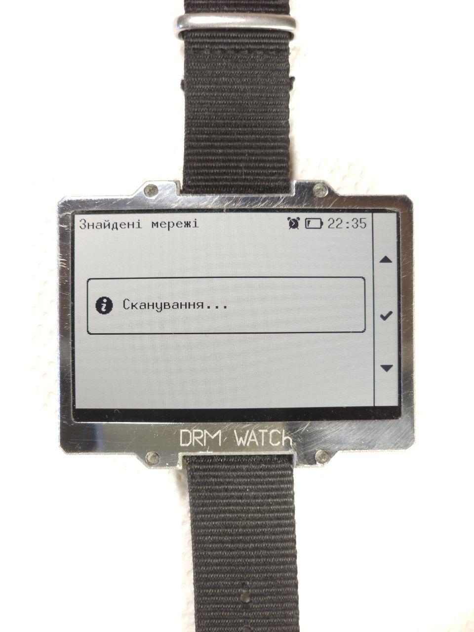

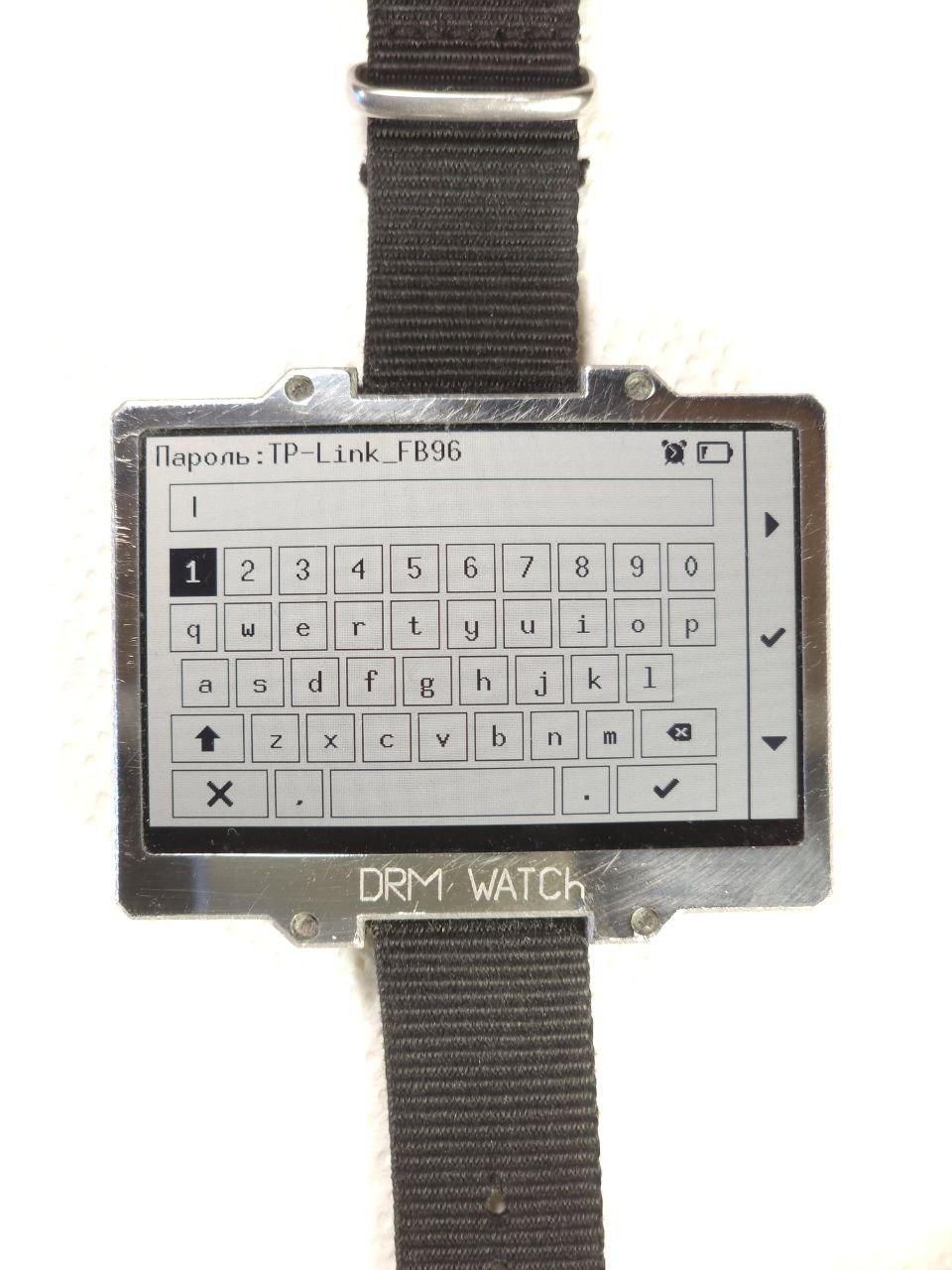

Step 10: Set Languare and Sync Time
To set language to English follow this:
1) Menu
2) "Налаштування"
3) "Дисплей"
4) "Мова"
Press once and language english set.
Then go to wifi settings, add your wifi network.
Then go to time settings and run auto sync.
Then go to timezone settings and adjust timezone to yours.
Now watch should be ready to use!

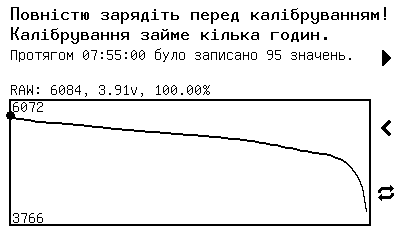

Step 12: Calibrate Battery
To make watch measure battery level as good as possible, I made calibration procedure.
It takes much time, but it improves battery indication a lot.
Fully charge watch. Go to settings-display-battery calibration. Start calibration.
It will take 5-10 hours. Watch will not respond for any buttons. Do not touch watch until it fully discharges.
After watch is turned off, calibration is complete. Charge it. After this watch can be used and you will see most accurate battery level indication.
