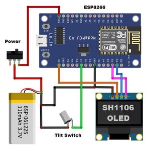

The device presented in this project is extremely simple to make and consists of only 3 components.
- ESP8266 microcontroller board
- SH1106 Oled display with resolution of 128x64 dots,
- and Tilt sensor
A single lithium cell is used to power the device.
The tilt sensor is essentially a switch that is in the open state when the legs are facing up, and in the closed state when it is rotated 180 degrees.
This component offers the simplest way to display both states of an hourglass while avoiding the use of additional sensors and libraries.

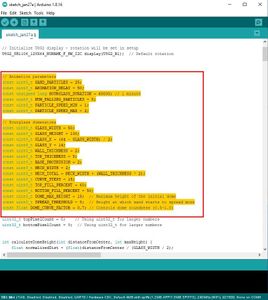

Now a few words about the code. Namely, you can immediately see that it is not completely optimized, it is divided into several parts, but all in order to be easier to customize.
Very simply at the beginning of the code by changing the constants, you can change every parameter, starting from the size and shape of the glass container, the amount of sand, the duration and speed of the sand leakage, dome parameters, up to the intensity of the animation and the number of falling particles.
