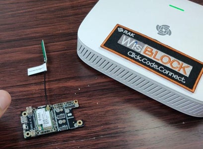

For this step, we will require only the RAK4361 Wisblock Core module and a LoRa Antenna from the Helium Developer Kit. Apart from that, we will require the RAK7268 WisGate Edge Lite 2 Gateway to configure that as a hotspot. First of all, we need to connect the LoRa Antenna to the RAK4361 board and connect the board to or Laptop or PC and with this, we are done with the Hardware Part. Now all the things need to be done on the Software end i.e. on the Arduino IDE and the Staging Console. For that, we need to follow the below steps.

After we are done with the code uploading. We are also done with the Helium node Configuration part. Now we can open the Serial Monitor. In the Serial Monitor, we will see that there are some join requests and those requests are accepted by the Hotspot. To visualize this more effectively, we can head back to the Staging Helium Console. Here you will see that in the live data Visualization, the data is moving towards the receptor. Below that you will also see the join requests for these messages with their Serial numbers, which are accepted by the gateway. You can open the Debugger as well to see that what message is received in the data packet. The message that is received is encoded and not in human-readable form. So for that, we will use the Base64 decoder which you can access from here. We will open the debugger of the staging console here in the data packet, you will see a field named payload copy the data of that field and paste that in the decoder. After decoding you will see what the original message was. As we are using the Staging Console that's why we need to use this decoder otherwise in the Main Helium Console we do not need to do all this.
