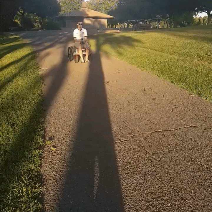

Step 8: Testing the Chair
As part of our project, we needed to prove our chair met the specifications we outlined at the beginning of our project. We also participated in a Senior Design Showcase put on by our school where all our classmates also showed off what they had worked on for two quarters. Everyone at the showcase was impressed with the maneuverability and ruggedness of our chair and we didn't shy away from showing it off. Attached are some videos of our initial benchmark tests along with footage from our showcase. By the end of our project, we were happy to have something that actually worked and had a fun time showing it off and playing with it.
