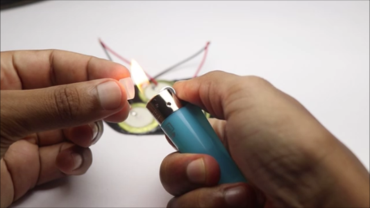

Step 1: Preparing Piezoelectric Plates

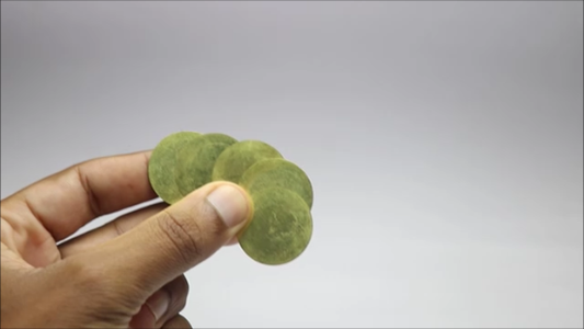

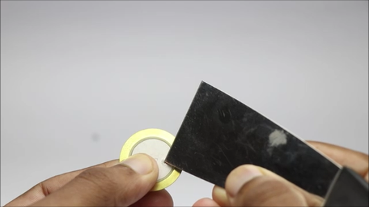

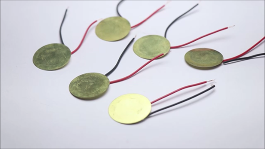

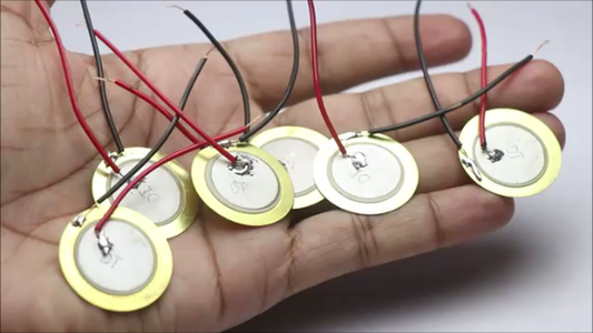

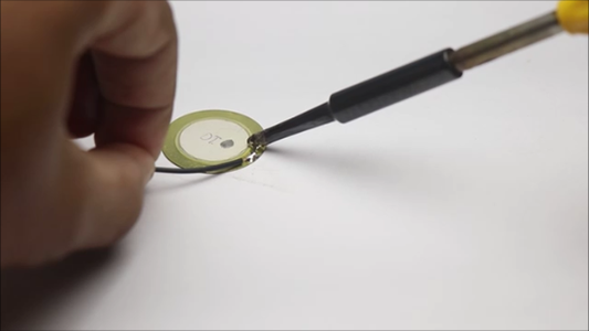

These discs generate dc power when some pressure is applied on them, The concept here is using more discs so that the setup will generate more and more power.
The discs can be found in buzzer, on the other hand if external power is applied to these buzzer it will act as a sound making buzzer.

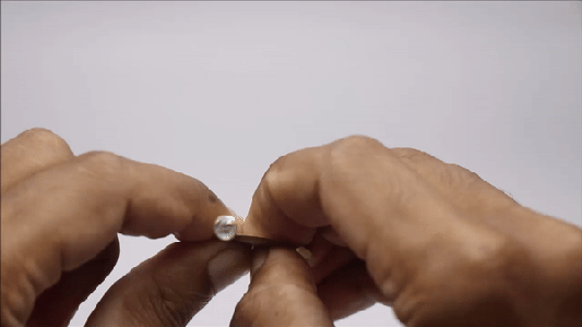

I have made splits of the cable that i will be soldering later to these Discs, The center part is positive and the golden plate is negative and these may change if negative force is applied, On the first image of this step you cna see that when i connected an LED and applied some pressure it immediately glows up the LED.
The power generation is not stable since we are applying varying force and not the steady one, To fix this i will use diodes more on this in the coming step

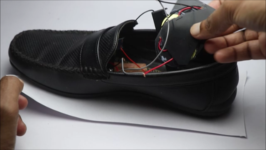

Step 2: Adding an Extra Sole

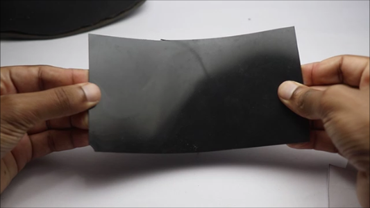

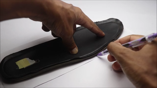

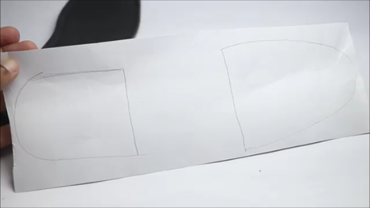

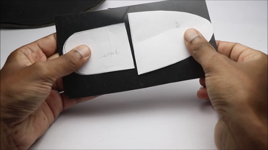

The pressing part below the sole needs to be the size lesser than that of the sole, I have placed the white sheet of paper under the sole and traced a outline with my pencil.
Now after the tracing is done, outline a line smaller than that of the original line of the sole, After this is done trace the same line on a semi flexible sheet of plastic.
The thickness of the plastic sheet that i used was very thin, so for me scissors served well the purpose of cutting and the other advantage here is it will adjust to the movements without causing any harm to the user and the internal parts of the shoes.

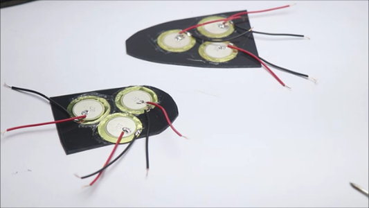

I have made 2 different parts here, the pressure points that has more impact on the foot is the front and the rear part. So adding discs to these 2 will help us to have the most advantage.

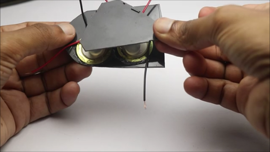

Step 3: Testing the Energy

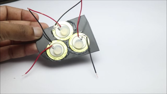

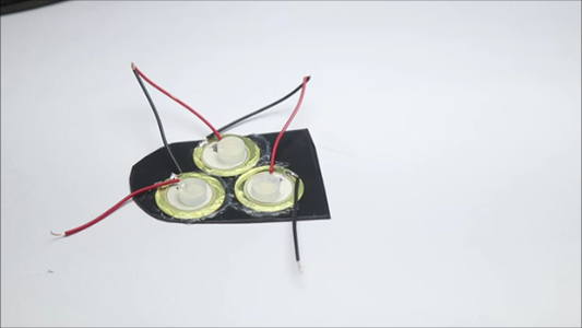

I have made 2 divisions here, one is for the front part of the foot and the second is the rear part of the foot.
Here i added 3 discs for each part and i will connect them in series, Later these 2 will be combined to that we have 6 discs connected in total and because of this design we can tap out continuous energy.
I have made series connection and to get most out of the disc i made a small cushion thing from glue stick, i have glued this to the center and upon this i have added a plastic plate.
Repeat the same step for the other part too and now we can head over to tapping the alternating power to the stable DC power

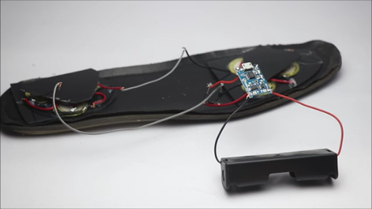

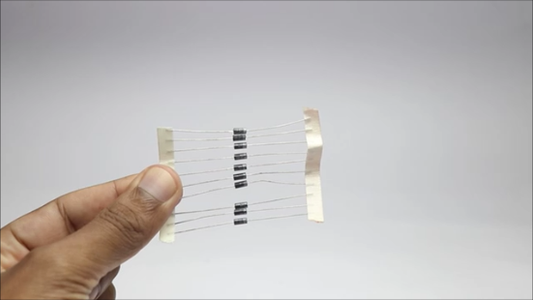

Step 4: Circuit Arrangement

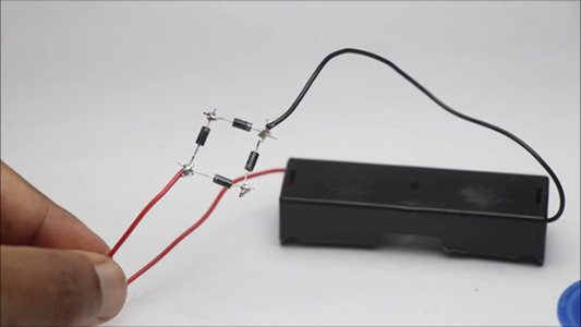

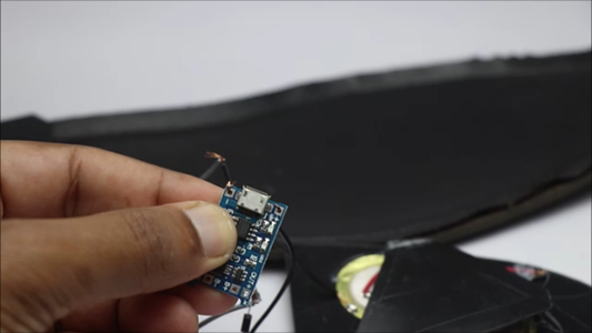

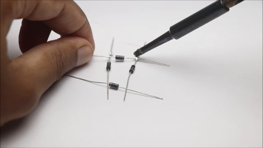

Diodes here serve 2 purpose, The first is the regulating the voltage and the second purpose is converting alternating power to stable dc power.
The diodes are arranged in this manner and to the top and bottom connection i have connected power input pins of the battery charging module.
The other terminals are connected to the piezoelectric disc plates.
You can use thin wires to establish connections between all these components, Solder the joints and trim off the excess wires this may lead to misconnections and cause problems later

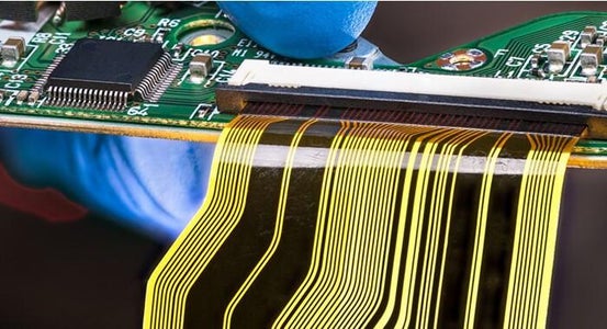

Check Here for Rigid-flex Pcbs with this your circuit becomes flexible! I have added the images to this step kindly check.
A revolutionary solution that combines the best of both rigid and flexible circuitry to elevate your electronic projects to new heights.
With their expertise in advanced manufacturing techniques, they offer a seamless integration of rigid and flexible components, ensuring enhanced reliability, durability, and space-saving benefits.

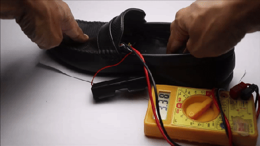

Step 5: Testing

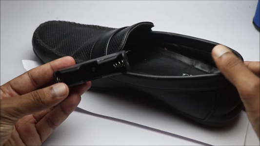

This part of the step is very important, why because you should hide all the electronics keeping in mind about the safety of the electronics and the foot.
There should not be any parts that is peeping out which may cause discomfort to the walking person.

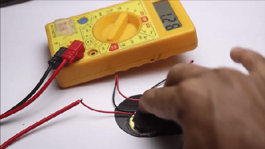

I installed all the electronics below the sole and tested the project by tapping my hands on the shoes, it was generating 5v with my light pressure from the hands, When i press the same on my foot it will generate close to 7v which is sufficient to charge the battery.
I will use battery case to hold the battery when its in charging and the double sided adhesive to hold the powerbank with the shoes.

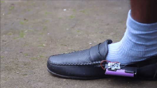

Step 6: How to Use
Using this is not a great deal, all you have to do is search for a good walking spot!
I recommend to wear socks whenever you are wearing the shoes, Connect the 18650 battery to the holder and start walking.
The charging board that I'm using comes with a blue LED when no battery is connected, and if the battery is connected and when you start walking the red led from board starts blinking.
This means that the battery is charging and your walking is generating electricity, You can use this power from the battery later to charge your other electronics.
