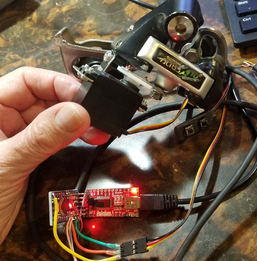

Step 3: Electronic
We recommend prototyping on a breadboard before making modifications to your bike. Copy the Fritzing diagram to a breadboard and see if you can make the the servo move then start soldering using the protoboard.
Tip: Adafruit sells a protoboard that looks like a breadboard called the Perma-Proto. When you are done testing your circuit on a breadboard just transfer the design without any modifications. They also sell one that fits in a Altoids mints size tin.
Step 1:
Take the Protoboard and create the circuit using the Fritzing diagram and schematic.
Note: Always wear googles while soldering or doing machine work.
Picture 1 and 2
Step 2:
Connect the wires through the back and put jumpers on the connections that attach to the servo and buttons
Cut the wires from the back and make the connection according to schematic.
Picture 3 and 4
Step 3:
Solder wires to the center pin and one other pin of the switch. Make sure to put heat shrink on the wire first. Attach the Molex pin terminal to one pin. Drill a hole in the top of the project box and mount the switch.
Picture 5 and 6.
Step 4:
Route the wires through holes in the side of the project box then attach the other to the positive output of the Lipo Boost converter.
Picture 7
Step 5:
Attach the negative output of the boost converter to another Molex terminal. Attached the wires with Molex pin terminals to the Molex connector as showin in Picture 8. Make sure the orientation matches the connector on the protoboard.
Step 6:
The end result should look like Picture 9. Connect the Lipo battery to the boost convert and the Molex connector from the switch to the protoboard. After checking for shorts with a multimeter turn on the power.
Picture 10
Step 7:
Program your board by installing arduino on your computer and loading this sketch
Turn on the your board and make sure your servo functions to your button presses
Step 8:
Using heat shrink solder two wires to you buttons after flattening the pins. Use a heat gun or the barrel of a soldering iron to shrink the heat shrink. Do this for each button
Picture 11 and 12
Step 9:
Tape the buttons in a comfortable position on your handlebar. Twist the wires to get them out of the way.
Picture 13 and 14
Step 10:
Attach Molex pin terminals to each wire for each button. Attach one wire from each button to a Molex connector.
Picture 15
Step 11:
Route the wires on your handlebars using hockey tape.
Picture 16
Step 12:
Test the circuit so far pressing the buttons.

Step 4: Metal Work
Step 1:
Take the Aluminum sheet and print out the template
Picture 1,2,3
Step 2:
Cut the bracket out of the aluminum sheet according to template using a metal saw and bend the bracket tab according to picture
Picture 4 and 5
Step 3:
Cut out the mount arm from the aluminum sheet
Picture 6
Step 4:
Cut holes into the mount arm (according to template) and attach the servo wheel to it using #3 bolts. Cut any excess bolt length after attaching a nut.
Picture 7, 8
Picture 1,2,3
Step 2:
Picture 4 and 5
Step 3:
Picture 6
Step 4:
Picture 7, 8
Step 5: Mounting
Step 1:
Mount the servo to the bracket using #3 screws such that the tab is away from the servo head
Picture 1
Step 2:
Take out your old derailleur and clean it reapplying grease when your done.
See http://www.utahmountainbiking.com/fix/rderailr.htm for instructions
Remember to tape your gear cable to the bike.
Step 3:
Since the servo is not strong enough to move the derailleur we must remove the spring. NOTE: This means your derailleur will not without a servo. I do not believe it is possible to remove it without cutting it so use your dremel or heavy duty wire cutters for this. This is difficult so have some patience and wear goggles.
Picture 2
Step 4:
Attach the servo and backet to the derailleur as pictured using a #4 screw.
Picture 3 and 4
Step 5:
Attach the servo wheel and mount arm on the servo and screw in the other arm of the mount arm to the derailleur using the old bolt. Make sure the servo can move freely through the entire range of motion.
Picture 5
Step 6:
Test to make sure that the derailleur moves when pressing the buttons
Step 7:
Remount the derailleur
Picture 6
Picture 1
Step 2:
Step 3:
Picture 2
Step 4:
Picture 3 and 4
Step 5:
Picture 5
Step 6:
Step 7:
Picture 6

Picture 1 and 2
Step 2:
Measure and cut a length of ribbon cable long enough to reach the front of the bike. Connect Molex pin terminals to the other end of the ribbon cable and insert them into the 3 pin Molex connector. Make sure the orientation is compatible with the the connector on your protoboard.
Step 3:
Route the ribbon cable to the front of the bike following the original cabling using hockey tape. Secure the original cable to the frame with tape if you don't want to completely remove it from your bike.
Picture 3 and 4
Step 4:
Place the buttons comfortably near the derailleur lever on the handle bar and velcro it in place
Picture 5
Step 5:
Attach the controller to your bike and connect the wires to the servo and button using the Universal Ram Mount
Picture 6 and 7
Strip the servo wires and the ribbon cable. Solder them together with heat shrink.
Picture 1 and 2
Step 2:
Step 3:
Picture 3 and 4
Step 4:
Picture 5
Step 5:
Picture 6 and 7
