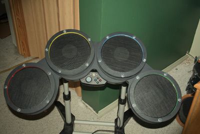

Converted my Roland TD3 KW Electronic Drum Kit. Upgraded it to a TD6 module with meshhead drums.
Step 1: Cut Tom Drum in Half With Jigsaw
I found this tom on eBay for $30.00. The price included shipping. This tom was cut in half with a jigsaw to create two 10" toms. I used tape around the cut line to prevent splintering.

I tried the foam cones. Had triggering problems like double triggering, miss triggering . Made many adjustments to the module with no success in getting it to trigger properly.
The sanding block foam blocks work great. I was able to set the module back to the default settings. No triggering problems at all.

One down and three to go. Now I need to create some DIY mesh heads using fiberglass window screen.
