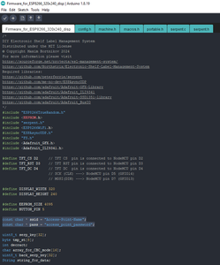

Step 8: Modify Firmware
Open the .ino file with the firmware for ESP8266 and replace my access point credentials with yours.

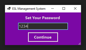

Step 11: Launch the ESL Management Software and Set Your Password
Launch the "ESL Management System.exe" file from the "...\V1.0\ESL Management Software\bin\Debug\net6.0-windows" and set the password to the software.
Note that the cryptographic keys used to encrypt and decrypt data are derived directly from your password. As a result, you will not be able to change your password once it has been set. Additionally, if you lose your password, the data stored in the database will be inaccessible, as the software won't be able to decrypt it.

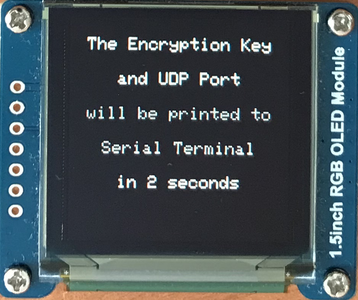

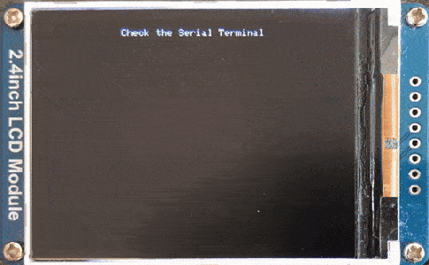

Step 12: Power Up the ESL in Configuration Mode
Put a jumper wire between the "D1" and "G" pins and connect the ESP8266 to the USB Port.

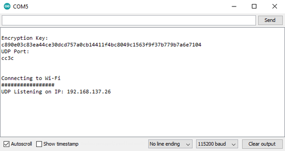

Step 13: Get ESL Credentials
After powering up the ESL in configuration mode and opening the Serial Terminal, switch the ESL to the operating mode by disconnecting the "D1" pin from the ground and connecting it to the "3V" pin.
After doing so, you should get the ESL's encryption key and the UDP port. Once the ESL connects to your access point, you should also get its IP address.

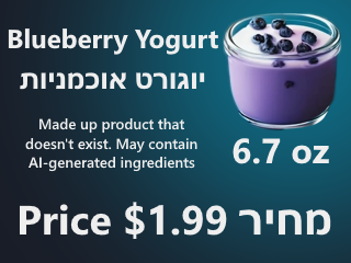

Step 15: Make Images for the ESLs
It's entirely up to you how to make the images for the ESLs.
To avoid accidentally using copyrighted images, I asked Craiyon to generate a few images and spent several minutes in paint.net making price tags with these images.
*All products and product-related information demonstrated in this tutorial are entirely fictitious. Any similarity to actual products and product-related information is purely coincidental.
