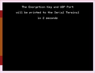

Step 12: Power Up the ESL in Configuration Mode
Put a jumper wire between the "D1" and "G" pins and connect the ESP8266 to the USB Port.
Step 13: Get ESL Credentials
After powering up the ESL in configuration mode and opening the Serial Terminal, switch the ESL to the operating mode by disconnecting the "D1" pin from the ground and connecting it to the "3V" pin.
After doing so, you should get the ESL's encryption key and the UDP port. Once the ESL connects to your access point, you should also get its IP address.
