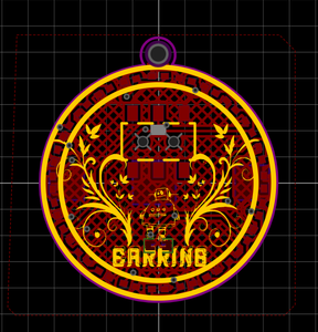

I move to EasyEDA to create the circuit schematic (I attached a screen-shot of the made schematic) you can use whatever EDA tool of your choice.
The circuit is so easy based on 24 small package LEDs powered by a CR1220 Coin battery, and a slide switch (for ON/Off).
All the LEDs are connected together in parallel to the coin cell battery.
Once you make the schematic, you move to the circuit board design, make the board outline in the desired shape (in my project I made it in a regular circle shape) and then place all the components inside to finish the routing.
Make sure to keep a hole in your design from where you can clip the earrings to the ear.
