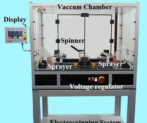

Electrospinning is a fiber production method which uses electric force to draw charged threads of polymer solutions or polymer melts up to fiber diameters in the order of some hundred nanometers. Electrospinning shares characteristics of both electrospraying and conventional solution dry spinning of fibers. The process does not require the use of coagulation chemistry or high temperatures to produce solid threads from solution. This makes the process particularly suited to the production of fibers using large and complex molecules.
Uses of electrospinning technique in
1 Filtration
2 Textile manufacturing
3 Medical
4 Pharmaceutical manufacturing
5 Composites
6 Catalysts

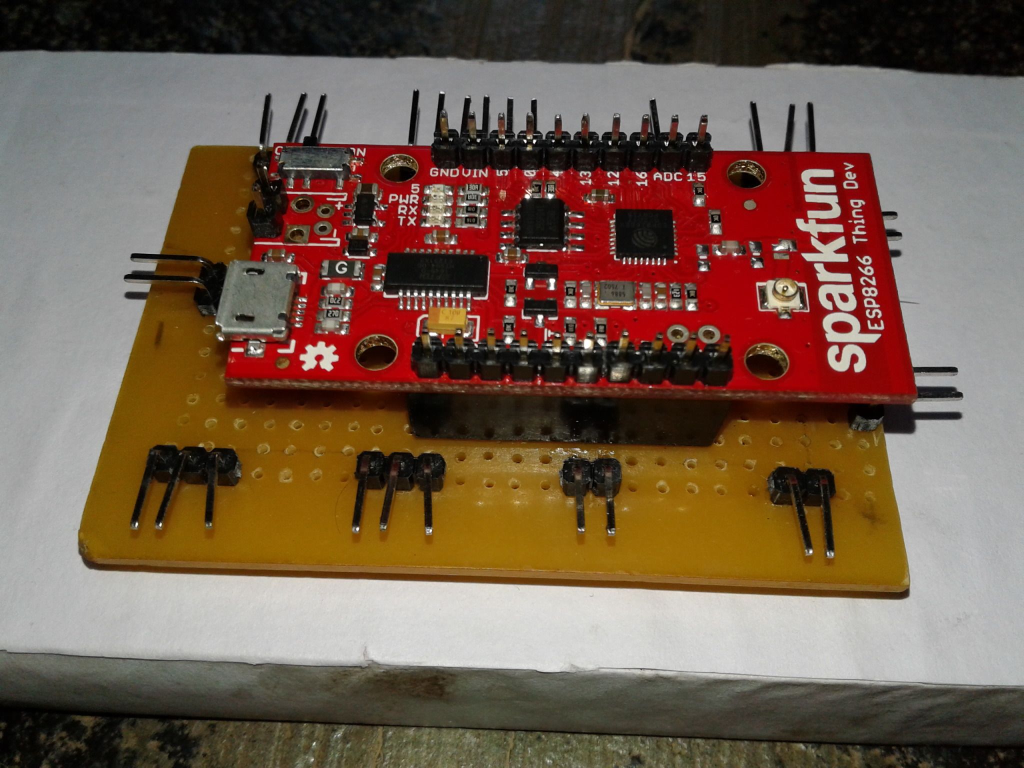

Intel edison devkit: to control all the peripherals,

Grove shield: to interface the sensors to the edison board via GPIO pins,

Step 4: Interfacing Sensors to the Edison Board Via Grove Shield.
The sensors and actuators are connected to the Intel Edison board through Grove kit. The components like Temperature sensor, LCD display, Relay, Button switch are used for this electrospinning system.

Step 6: Hardware Setup
The required components are connected and interface to the Intel Edison board and the gear motor is controlled with relay and button, LCD display is used to visualize the temperature values and the color of the LCD is change according to the temperature range.
