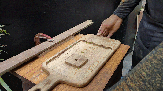

  • Take a wooden chopping board.
  • Mark the chopping board where the epoxy design will be made.
  • Grind the depth onto the chopping board using a palm router.
  • Make a hole in the chopping board by using a drill machine. This hole will make way for the clock's dial.
  • From behind the chopping board make a space for the clock's machine.
  • Using a wood carving tool, make some abstracts on the front side of the cutting board to resemble higher grounds and shorelines.
  • To give the wood some depth, we burn the surface using a flame torch.

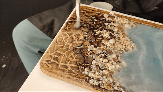

Step 2: Creating the Seashore and Island

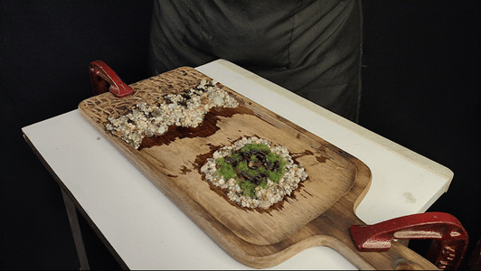

  • Mix Epoxy + hardener (2:1) with gravel.
  • Put the mixture on the surrounding edges of the centre and the coasts of the wooden mass to make it look like a seashore and a nearby island.
  • Now decorate the island with some green artificial moss (Diorama Powder).

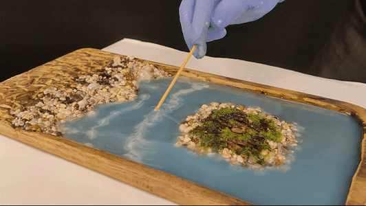

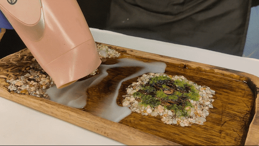

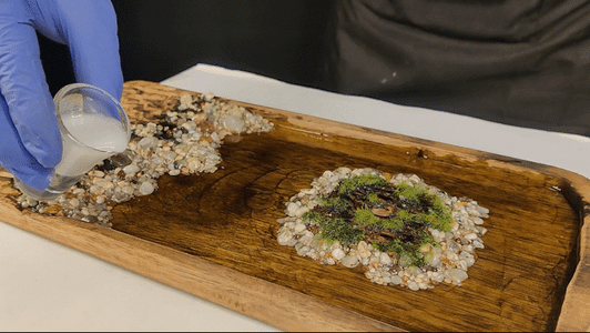

Step 3: Creating the Sea

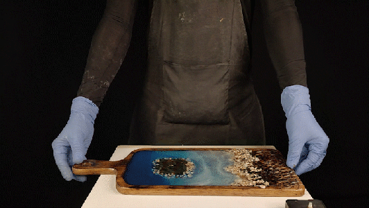

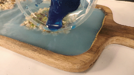

  • As our base layer, pour the clear Epoxy resin mixture.
  • We started making waves on our canvas now that we had added white colour to our epoxy mixture.

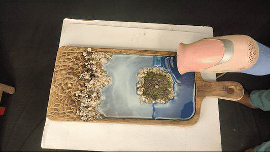

  • Using a hot air blower, we started giving the waves their natural look.
  • Now that we've added a light blue colour to our base layer and spread it with a hair dryer,
  • Again, using the chicken stick, add white to create a wave effect.
  • To create the effect of a deep sea, add a deep blue color.
  • We used a slow-dying epoxy that takes 24 hours to cure fully.

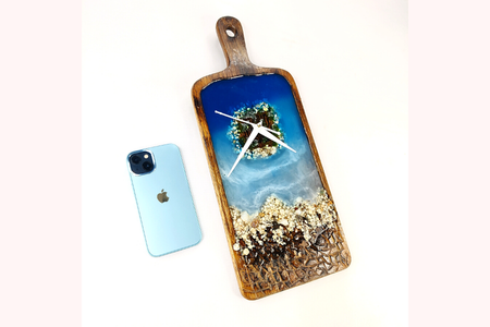

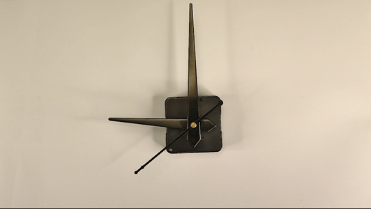

Step 4: Fixing the Clock Machine
  • Here we are using a wall clock machine with an hour, minute, and second dial.
  • Place the clock's machine and dial onto the back side of the cutting board.
  • Finally, secure the clock's machine and dial with screws and glue.

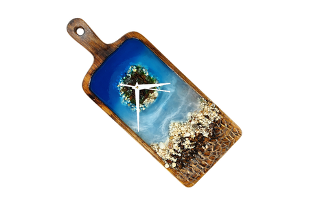

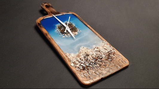

  • Now, our stylish timepiece that resembles an ocean is ready.
  • This clock can be hung on the wall or set on a table.
