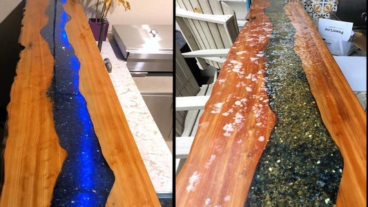

Introduction: DIY Epoxy River Bar Top That Glows in the Dark
About: I am a father, husband, craftsman, artist, woodworker, furniture maker/designer, and overall DIY'er. Most of my projects involve making unique furniture incorporating many different designs, materials, and ele…
In this instructable, learn how to build a DIY live edge epoxy river bar top table for an outdoor kitchen. Also, I show you many useful epoxy tips and woodworking techniques.
Even if you don’t need to build an epoxy river bar top, the DIY tips and techniques can be directly applied toward other epoxy resin and woodworking projects.

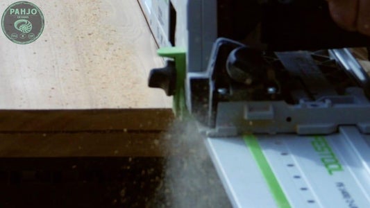

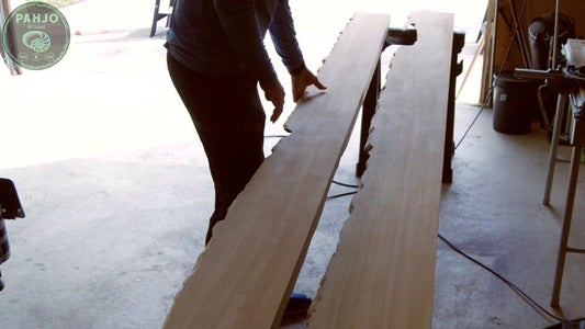

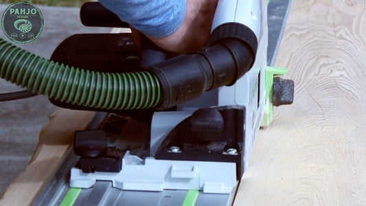

Step 1: Cut Live Edge Wood Slab
First, I used my track saw to cut the live edge wood slab directly in half.

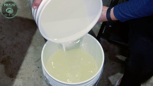

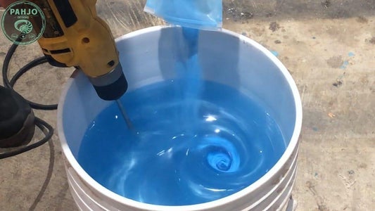

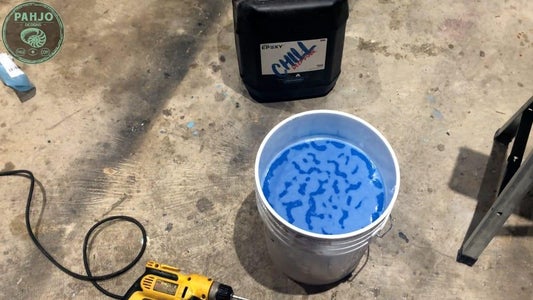

Step 5: Mix Epoxy Resin
First, I should mention I performed 2 epoxy pours for this live edge river table. The first layer filled the epoxy river roughly 3/4 and the second layer filled the remaining 1/4. More on this later in this tutorial.
Deep pour epoxy normally requires a 2:1 mixing ratio. So, 2 parts A to 1 part B.

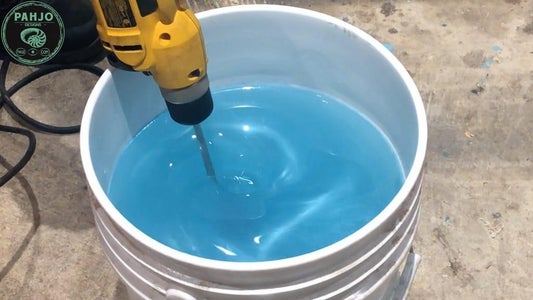

I used 3 buckets to mix epoxy resin. By using 3 buckets, I make certain the measurements of part A and part B are accurate.
Next, I pour part A and part B in the third bucket. Then, I use my drill with a paddle mixing bit to mix the epoxy resin.
Epoxy resin turns cloudy when it is initially mixed. When it is appropriately mixed, it turns clear.

Step 6: Add Pigment Powder & Glow Powder
After the epoxy turned clear, I slowed down my drill speed and added a small amount of blue pigment mica powder.
It is a good practice to add a little pigment powder at a time – especially if this is your first time using a certain color or pigment brand.
Obviously, you can always add more if needed.
I use glow in the dark powder (Photoluminescent Powder) in epoxy for various tables and crafts. Photoluminescent powder is charged by natural or artificial light and glows based on the amount of light it receives.
As a result, the epoxy resin glows in the dark without lights.
I added and mixed the fluorescent blue epoxy glow powder immediately after the pigment powder.
Also, I used 16 ounces of glow powder which is plenty for this glow in the dark table top.

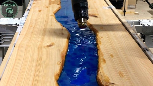

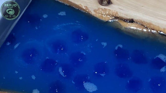

Step 7: Remove Air Bubbles
To remove air bubbles form deep pour epoxy, I allow the epoxy to sit for roughly 8 to 10 minutes after mixing. Due to the thin viscosity of deep pour epoxy, the bubbles rise to the top.
Then, I use a heat gun to remove the bubbles.

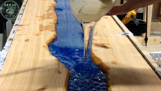

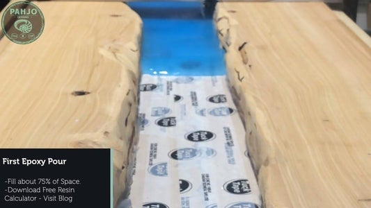

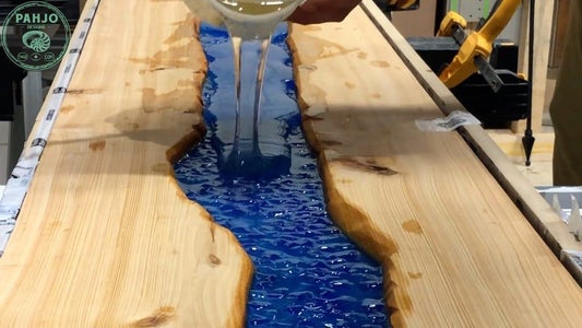

Step 8: Base Layer Epoxy Pour
Once the all the bubbles, I slowly pour the resin on one end of the live edge bar top river table. As a quick reminder, this epoxy pour will only fill the river bar top about 3/4 or 1.5”.
Next, I carefully inspect the sides, ends, and bottom of the epoxy resin table for leaks. Use hot glue to quickly seal an epoxy leak.

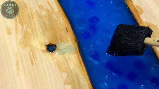

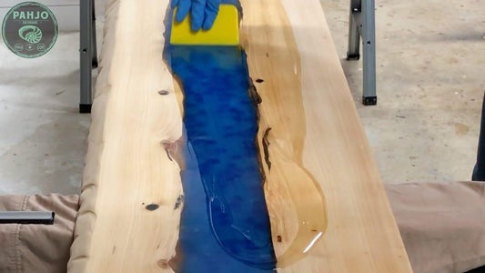

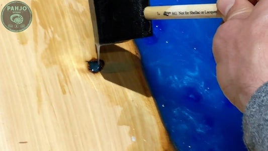

Step 9: Fill Wood Knots
I used a finish sponge to fill wood knots with epoxy in the live edge wood. I placed the sponge in the epoxy and moved it around to absorb resin.
Next, I quickly placed it over the wood knot and allowed it to fill the knot with epoxy.

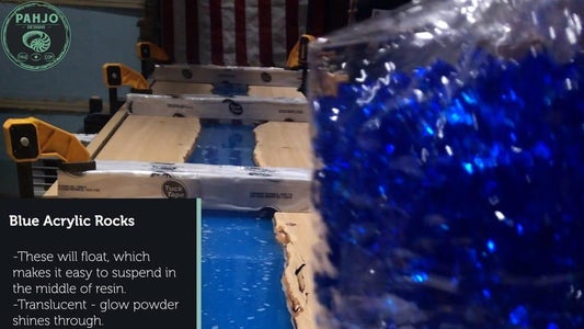

Step 10: Embed Rocks
Immediately after the epoxy pour, I added blue acrylic rocks to the epoxy randomly.
In the past, I used fire glass in river rock tables. However, fire glass introduces a few problems:
  1. Fire Glass reflects light which prevents the epoxy glow powder from charging.
  2. Broken pieces of glass are sharp, which makes it dangerous to work with.
  3. Fire glass ruins or dulls saw blades if the bar top has to be cut.
  4. Glass sinks, which requires an additional step (thin epoxy pour on bottom) to suspend in resin.
Acrylic rocks work best for tables with rocks in the middle for the following reasons:
  1. They are translucent which allow light to shine through.
  2. Acrylic rocks are safe to work with and easy to cut.
  3. They float, which makes it easy to suspend in epoxy.
Since the acrylic blue rocks partially float, I left 25% (1/4” of space between the first epoxy pour with acrylic rocks and the second pour.
In other words, the second pour will adequately cover and submerge the acrylic rocks in epoxy.

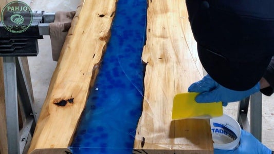

Step 12: Top Layer
Table top epoxy cures faster, requires a 1:1 mixing ratio, and generates more heat than deep pour epoxy.
With this in mind, I chose to allow the deep pour epoxy completely cure before adding the second layer of total boat table top epoxy.
I proceeded to the top pour. For the top epoxy pour, I determined the amount of resin I needed to fill the live edge epoxy bar top river table up to the surface. Next, I mixed the resin according to the manufacturer’s instructions and poured the table top epoxy in the river.
Due to the thickness of table top epoxy, I distributed the pour down the river instead of pouring only at one end.

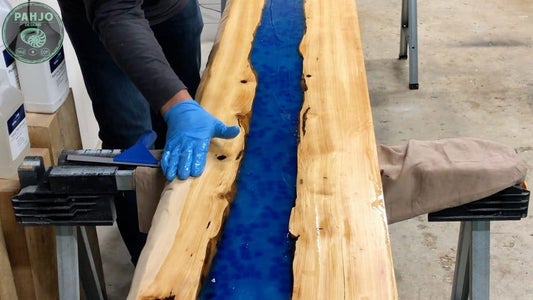

Step 13: Remove Air Bubbles
Next, I used my heat gun to remove epoxy air bubbles from the table top epoxy.

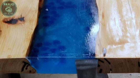

Before I removed the DIY live edge river table from the mold, I turned off the lights to see it glow in the dark.
Since the table sits in the dark for most of the day in my shop, the glow powder doesn’t charge that much. Keep in mind, glow powder needs sunlight or artificial light to charge.
To demold the epoxy live edge bar top, I simply used a pry bar and gently lifted up all around the river table. The table released from the resin mold very easily.
Obviously, sheathing tape and vaseline work really well for epoxy molds. In fact, I reuse most of my resin molds numerous times before I discard them.

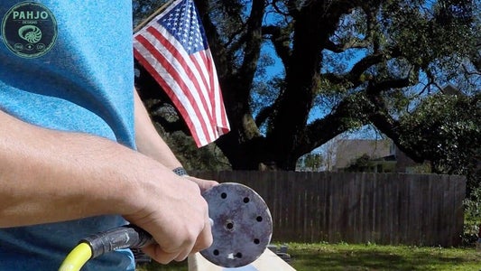

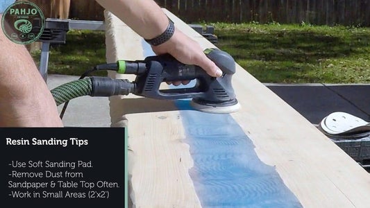

Step 15: Sand Epoxy
First, I always sand epoxy tables outside if possible. So, I carried the epoxy table outside and placed it on my saw horses. I use an air compressor to clean the resin build-up on the sandpaper while sanding. This produces an enormous amount of dust so be sure to wear a mask.
I wrote a detailed tutorial explaining my technique on how to sand epoxy resin. Be sure to check it out.

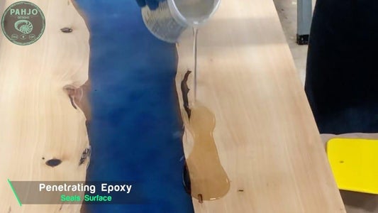

Step 17: Apply Penetrating Epoxy

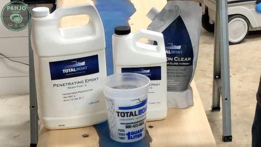

The marine industry makes great products to protect wood surfaces as well as epoxy. So, I called my friends at TotalBoat and explained my project to them. Essentially, they recommended I use 2 products to protect my live edge epoxy river table from the outdoor elements.

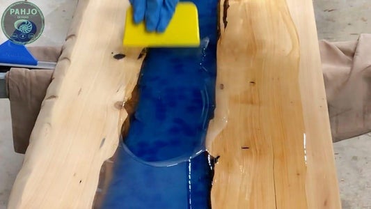

First, I used penetrating epoxy on the epoxy wood river table to seal the surface. Penetrating epoxy is super thin which allows it to penetrate deep into cracks and crevices.

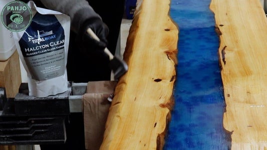

Step 18: Apply Wood Varnish
I used Halcyon Clear Gloss Varnish to protect the epoxy river bar top.
Halcyon varnish is great to use because:
  1. Water Based Formula
  2. Dries quickly
  3. Allows up to 5 coats in one day
  4. Doesn’t require sanding between coats
I applied 5 coats to this outdoor epoxy wood table and it was ready to go. This stuff is truly remarkable – THANK YOU TotalBoat.
