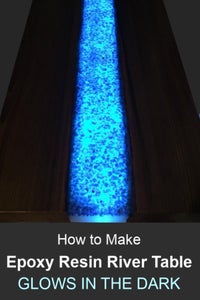

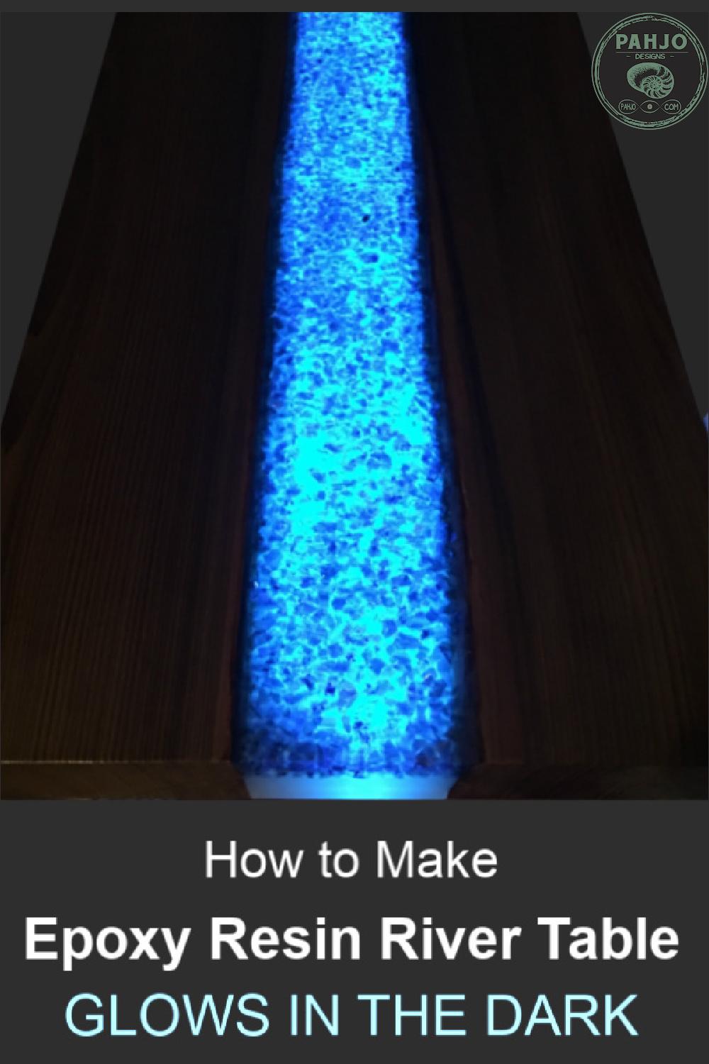

In this instructable, I show you how I made an epoxy resin river table that glows in the dark with no lights.
Even if you don’t need an epoxy resin river table, the techniques covered in this DIY tutorial can be directly translated toward other epoxy, woodworking, or glow in the dark projects.
