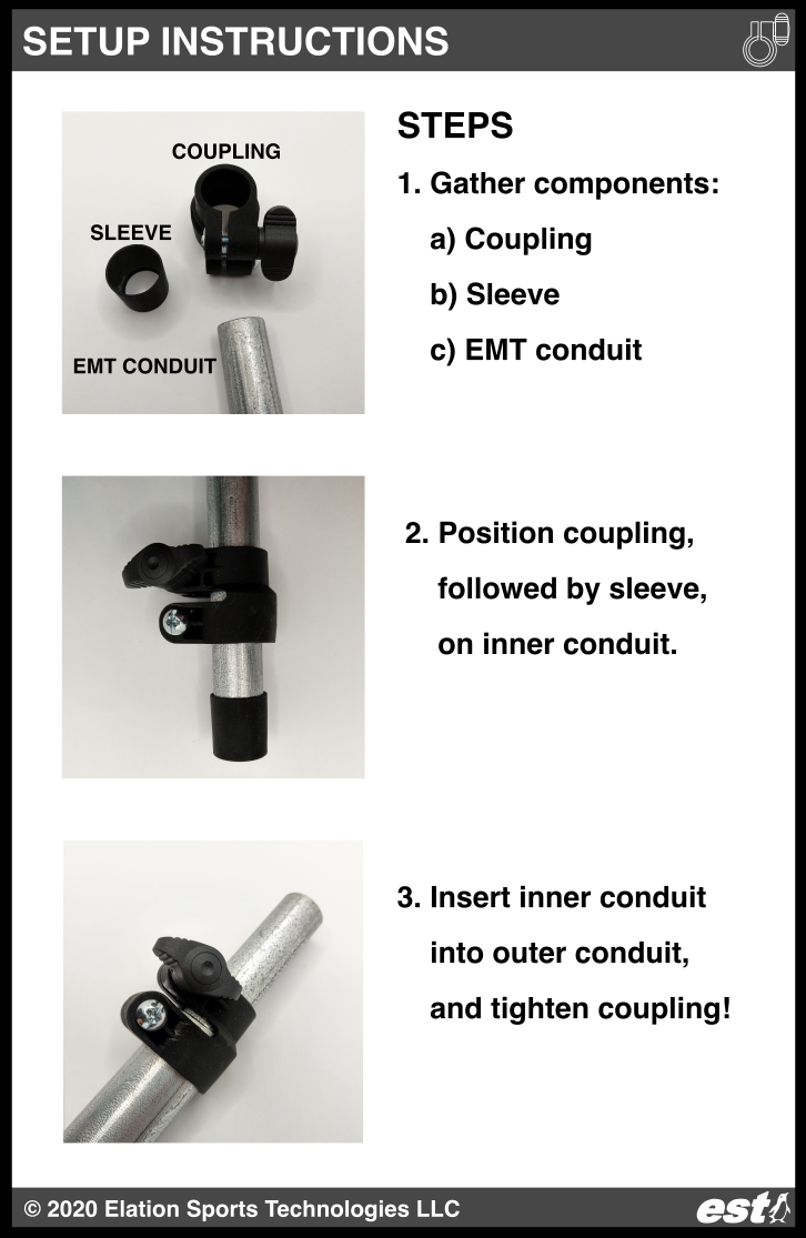

These injection-molded, UV-resistant EMT conduit telescoping couplings/clamps make it easy to create a telescoping pole out of EMT conduit with no drilling required! Assemble the telescoping coupling and sleeve on the 2 x conduit pieces as shown below.
