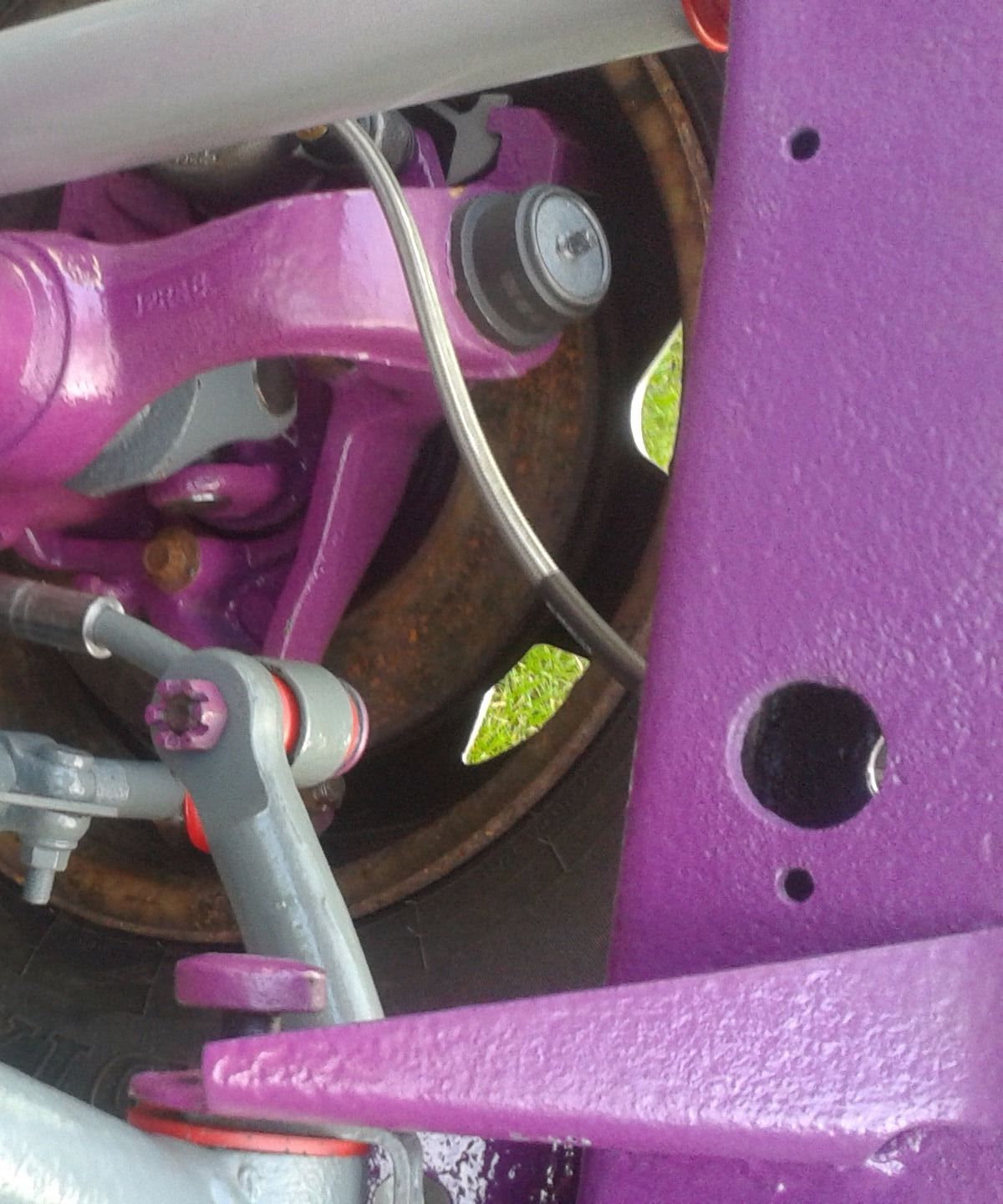

After installing a 2 1/2 lift kit on my jeep YJ I couldn't get the track bar to bolt back in. I shopped around a bunch and found a lot of solutions but most were expensive aftermarket replacement track bars. The others needed welding.
I devised this solution after seeing a youtube video on the installation of a Spohn adjustable trackbar on a lowered Tahoe. Additionally there were some blog posts that show lengthening the track bar by cutting it and welding in/on an insert or sleeve.

Step 6: Installation
Now with the bar reassembled I could install it back in the jeep. Normally, and as the Spohn bar does, the threaded rod would have had both right hand and left hand threads but again this wasn't my case for $$ reasons.
My extended track bar is adjustable but you have to disconnect one end and rotate it to change the length. Due to asymmetry in the bar, this means the bar can only be adjusted in 1/14 inch increments.
Some Jam nuts and Loctite on the threaded rod preload the threads keeping things tight and strong.
