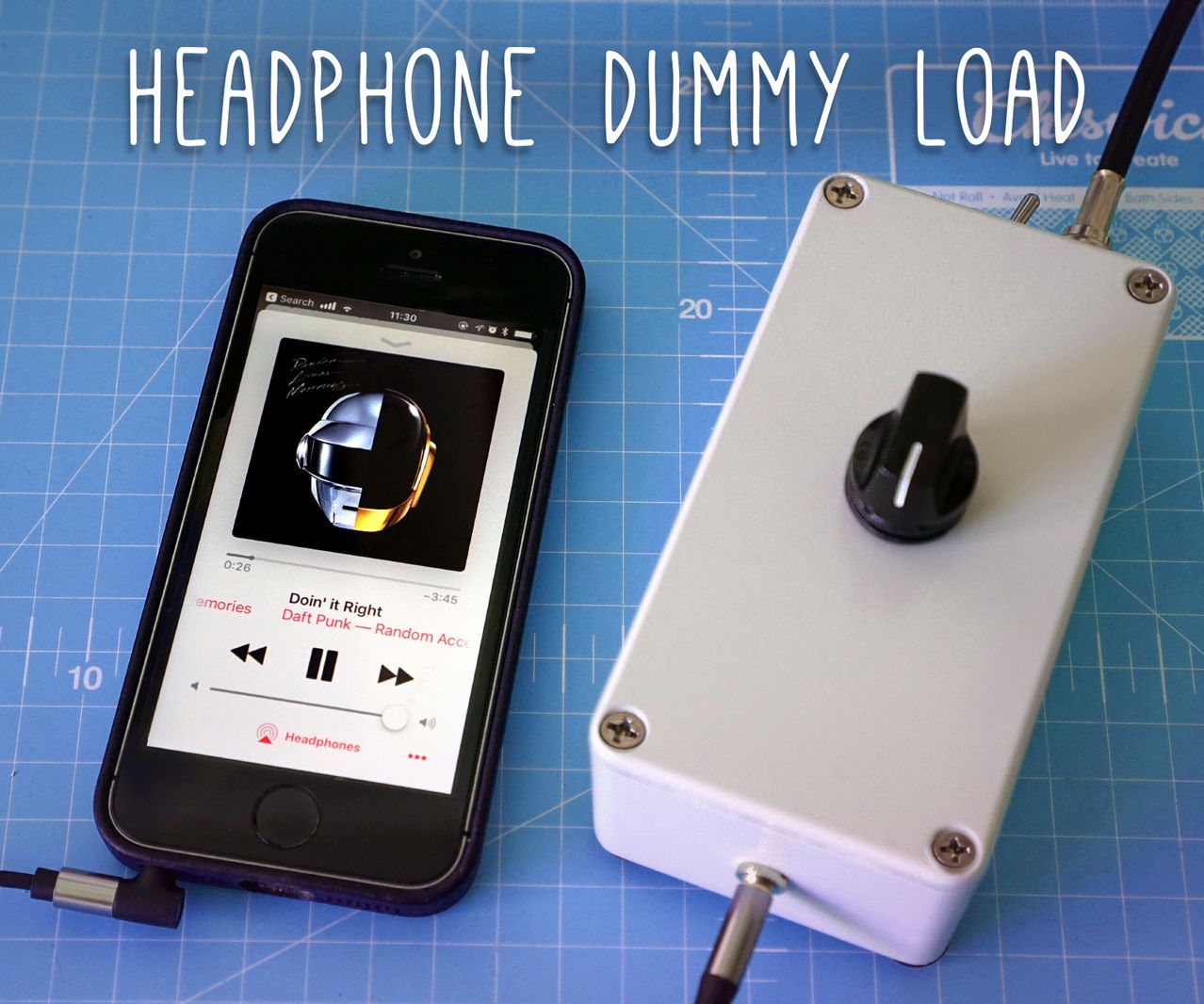

But there’s no reason why a big, awesome, solid metal volume knob should remain the sole domain of expensive audio gear - I’ve got a design for an external control that’s dead simple, cheap to build and looks good. It’s also entirely passive, so it won't make your music any louder or sound any better. So... why would you want one?

For my design, I chose BNCs as the main input/output connectors but added a couple of 3.5mm stereo jacks for the sake of convenience.
The BNCs make piping the signal to various pieces of equipment dead-easy. Although only single channel, BNC "T" adapters, BNC-to-RCA plugs and plenty of coaxial cable can be used to split the signal and route it to any combination of scopes, analysers, dummy loads or amplifiers.
Keeping the unit switchable between the input/output methods will also let me have a quick "hardware" method of flipping between (say) playing the signal back through some speakers and running it to an oscilloscope.

Step 6: Solder It Up!
Wiring up the components was a bit tricky - not because the circuit is particularly complex, but because I was using such a small enclosure. Which meant that the parts were all extremely close together.
The best strategy I found was to assemble the circuit outside of the enclosure, and then carefully use tweezers to nudge each component in place inside the box afterwards.
The enclosure itself was used as ground - meaning each component needed contact with raw aluminium on the inside of the box. I used one of those tiny, hourglass shaped washers to tie the two ground poles of the pot together, putting them directly in contact with the metal case. From there, each of the other connectors either bridged to this point using short wires or made direct contact to the case themselves.
Total time was about an hour, with liberal use of helping hands to make the job easier.
Step 7: Assemble!
Fortunately, assembly was a breeze, mainly owing to the old adage of "measure twice, cut once, fix your mistakes, measure again, cut again, learn from your mistakes, make promises you can't keep".
I ended up swapping out the smaller grey knob for a huge black aluminium one, which matches the aesthetics of the case and makes finer adjustments a little easier.
