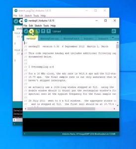

 Next let's focus on the part with the Arduino microcontroller. Namely the signal needs to be processed to remove the noise and unnecessary components, that the filters serve, and then converted to a form that is recognizable by the PC software (converted from analog to digital signal). For this purpose, "nerdaqII" code is uploaded to Arduino.
NERdaq is a data acquisition system developed at New England Research to support slinky-based seismometers in schools. The daq is built around an arduino and streams 16-bit (oversampled) values to a usb port; the data are sampled at about 18.78 samples/second. Arduino code is provided for unrestricted use. Installing the code on the arduino follows a standard procedure. In arduino IDE, in tools we select Arduino Nano and a corresponding com port. Then we go to open and locate the folder with the nerd software and select the nerdaqII.ino file. Now we press the upload button and when it's done, the part with the Arduino is done. The consumption of the whole assembly is very low, so there is no need for an external power supply, but it is powered through the USB port of the computer. The signal from the Arduino microcontroller through the USB-to-Serial port is transmitted to the Amaseis PC software. This software actually performs signal visualization as well as its logging for further processing.

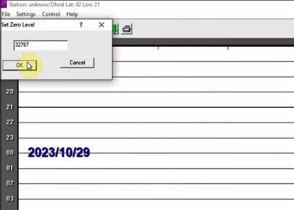

  Now we need to install the Amaseis software.Then we start it and go to settings - this station - and enter the name, and latitude and longitude of the place.
 - Next, in the settings - COM port - we enter the COM port to which the Arduino is connected, in our case it is COM4.
- Then, in setings - device - we select SETUPK1,
 and in SET Zero Level we enter 32768 .
 - We need to set the filters, duration of one line of the graph and gain.
 - For this purpose, we go to settings and helicorder - horizontal time limit represents the duration of one line of the graph. If we leave 1 hour then the whole graph contains data for the last 24 hours.
 - We adjust the gain value according to the amplitude of the signal, in my case 25.
 - Next we set the lowpass and highpass filter, and that's it for now, we restart the software and the logging starts.
 - During the operation of the software we can constantly change these settings. We can also zoom in and analyze a specific time period from the graph.
