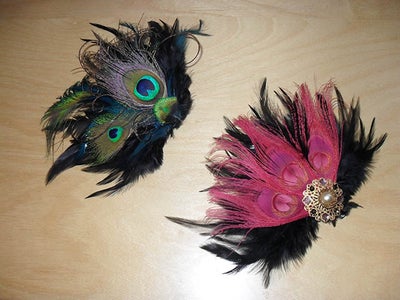

My mother recently mentioned that she wished she had a fascinator. I've been making ones to match my various party dresses for several years now, so for her birthday I've assembled a custom piece to send her. There's no reason to pay big bucks on Etsy or in a boutique when you make elegant pieces right in your own living room. Using a simple layering technique and knowledge of feather types, I'll walk you through how to make one of a kind feather fascinators of your very own!

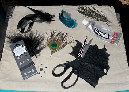

Step 1: You Will Need...

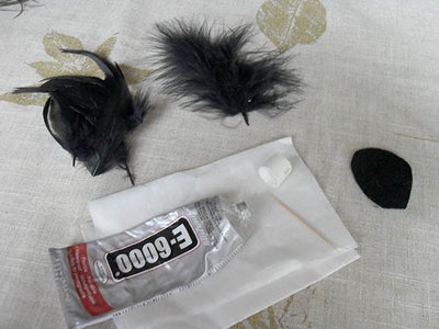

Barrett/Hair Clip --preferably the kind covered in a layer of ribbon, as this will ensure a better bond than trying to glue your feather pad to metal. I found a 4 pk in the ribbon section of my local Michaels' Crafts.
Scissors
Craft Felt --preferably a color that reasonably matches your base feathers.
Multi-Media Adhesive --I suggest something like E-600 or Craft Goop. DO NOT use regular Elmer's Glue because it is too runny and takes too long to dry.
Toothpick --for applying said adhesive
Feathers --We'll talk about choosing feather types in the next step. For a finished piece, I'd suggest using at least 3 different types of feathers.
Rhinestones/ Sequins/ Buttons --you may wish to add a little bling as a final touch at the end. This is a great way to use up that random button, loose earring, or stray sequin you've been holding on to in the craft box. Up-cycle that "junk" into an accessory!

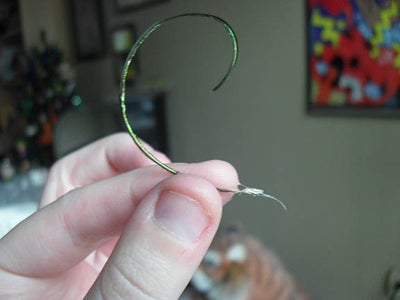

A) Peacock Wisps --These are the little wisps that go up the shaft of a long peacock feather before you get to the eye. They are sometimes sold in bundles or pads, packaged in cart stores, or you can strip them from long feathers you buy. These are great little accents and can be curled with scissors like ribbon (you'll see).

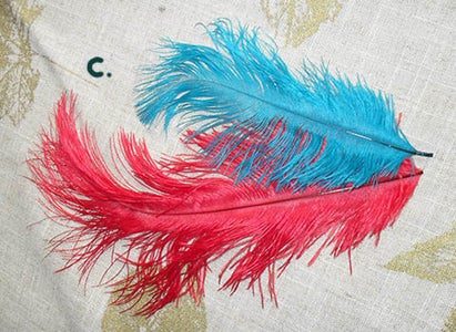

C) Mini Ostrich Plumes --great for costumes and more dramatic pieces for their volume and movement. "Mini" is anything under 7 inches. I don't use any in this tutorial because they do take a fascinator to a level beyond casual wear, and I don't want mom to have to wait for a formal ball invite before she can wear it.

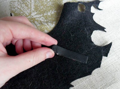

Step 3: Base Pad
Cut out a petal shaped piece of felt that is just slightly longer than the hair clip you'll be using.
This felt piece will really never be seen, so you can just eyeball this without worry for how symmetrical it is.
Step 4: Base Feather
I've decided that the base color of my feathers is going to be black.

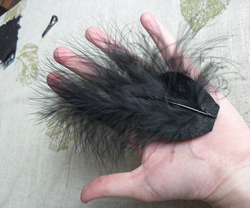

As a base, I've chosen 1 voluminous marabou feather. These are typically too wispy to feature out front, but they give a nice little "foof" of volume to your piece.
Flip the feather over to the back.
Using a toothpick, apply your clear drying adhesive along the shaft,going a bit less than half way up from the base.
Apply to your felt pad and press gently. Allow to dry for a minute.

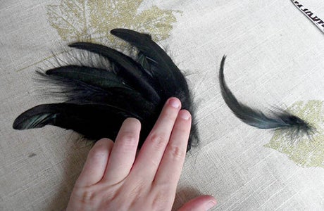

My second layer is Rooster Schlappen.
Repeat adhesive application steps, attaching each feather to the base of your felt petal shaped pad.

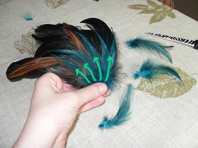

Apply feathers in a "fan" configuration for the most body.Secure the base of each feather as if they are all headed toward a single point, then tilt the tip outward. See 4th photo. This will effectively cover up the base layer beneath.
I used 7 Schlappen feathers. You may use more or fewer, depending on your final design goal.

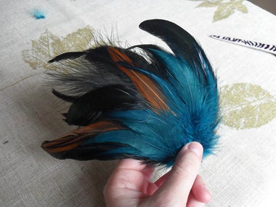

My 4th layer is more rooster saddle, but shorter feathers that are dyed turquoise.
If your saddle feathers came sewn to a strip of fabric, you'll need to extract some to work with.
Grab a chunk of feathers near the base and pull. Many times they will slip right out of the stitching. If this doesn't happen easily, snip the fabric strip with your scissors to free the stitches holding the feathers.
Repeat adhesive application steps.
Fan out your feathers, as with previous layers (see 3rd pic).
I used about 10 turquoise saddle feathers to get nice body, coverage, and a definite opaque color in front.

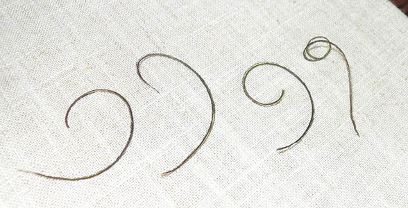

Step 8: Preparing Accents
Remember how I said you can curl peacock wisps like ribbon? Now is a good time to practice that technique and prepare a few for potential use on your fascinator.

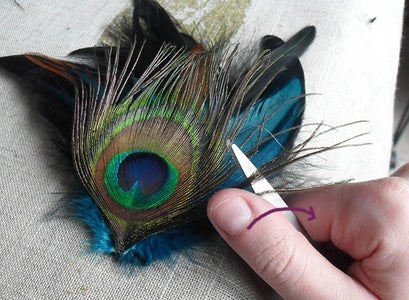

Run a wisp between your thumb and one side of your scissors, just as you do when curling ribbon.
The more times the run a wisp over the blade, the curlier it will get. 1 times gives a natural curl while 2-4 times will get you tight spirals and curly-Qs.
Have fun with this and save a few on the side in case you want them later.

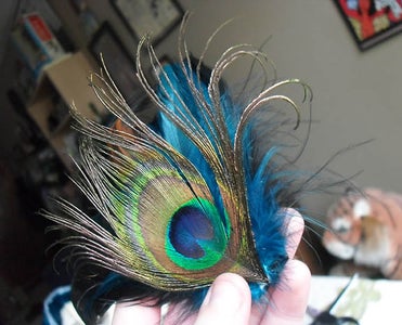

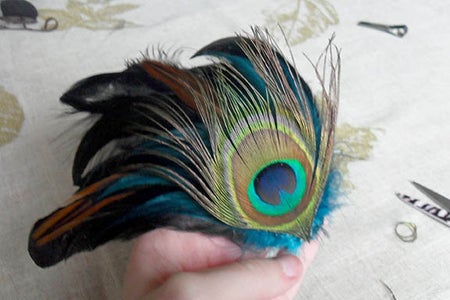

Step 9: Focal Point

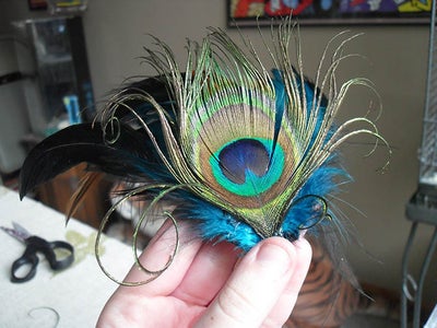

Peacock eyes make an excellent focal point for a fascinator. Not only are they beautiful, but we owned a flock of peacocks when i was growing up, so this bird has some significance for mom and I.
My last layer will be a single eye feather. You could try two smaller eyes or throw a sword feather in there if you want to get more elaborate.
Apply adhesive to the back of the eye feather. You won't have much shaft as a guide in this case. Apply a line of adhesive extending up a little less than half way into your eye area. Take care not to use too much adhesive, as you don't want it soaking through to the front.
Press on to the front of your feather pad. Allow several minutes to dry.
If you wish, you can curl the sides of your eye feather using the same scissor technique. Be gentle and do this only after you're sure your piece is dry.

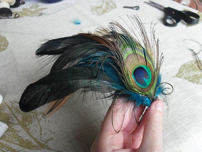

I added a few curled wisps to finish off the sides.
Use a minimal amount of adhesive on the base of the wisp.
Apply as close to the base of you eye feather as possible for an organic look.

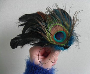

Step 13: Done!
You're dressed to impress! Who cares what the rest of the outfit looks like??
Now that you know just how easy these are to make, have fun experimenting with different combinations and make custom pieces as gifts or for themed parties. These are also a great project to do as a group for something like a bridal shower. If the bride is really creative/relaxed, all the bridesmaids could make their own semi-matching fascinators to wear during the wedding.
