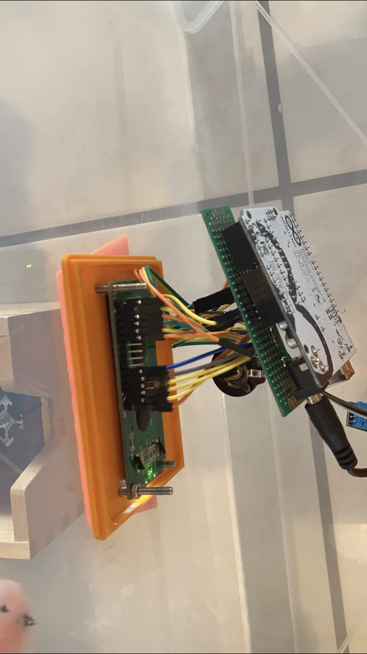

Step 1: Wiring/Soldering/ Upload the Code
First I have a circuit board ( to plug in the arduino) with a 10k Ω potentiometer (for te LCD display) and soldered a few more VCC and GND connections. Next I connected the components and uploaded the code.
