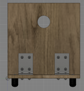

First, we need to start with the base plate that will carry all of our parts. I used a 20x40cm wooden plate and screwed four 3D-printed feet onto each corner. To hold the extruder, we will need two 20x20cm wooden plates positioned about 10cm apart, which will be secured with angle brackets (it doesn't matter which ones you choose as we won't be handling a lot of force). Drill a 35mm (its the outer diameter of my tube) hole in both plates at the same height (I measured 5cm from the top). Take your time with this step because it is crucial for the motor to be aligned at a 90° angle relative to the tube.

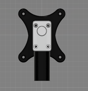

Now for the most important part: the extruder. We start with the aluminum pipe, which we then insert into the holes of the wooden pieces. After this, we insert the drill bit as the spindle and attach the motor via the 3D-printed holder to the back.
