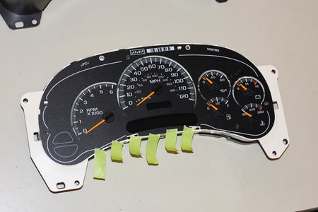

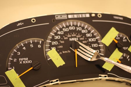

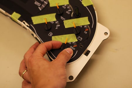

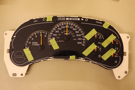

Step 3: Removing the Needles the Right Way
Ok now you'll need a few pieces of masking tape and a pen or marker. Rotate all the needles counter clockwise gently until the come to a stop, they should all stop at or just below the zero marks. Now make a pen mark on the tape just below the top of each needle. This will be important when you put it back together to maintain calibration so don't skip this step.

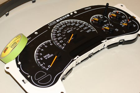

Step 4: Needle Removal
Now that you've made your calibration marks firmly rotate each needle further counter clockwise a few inches. You'll be rotating the needle around the motor's shaft so there will be some resistance especially at first. Don't worry, you won't break the needle if you keep your fingers near the base of the needle and away from the tip while you do this step.
Now pry upwards with a needle removal tool or even a fork, try to pry straight up and not at an angle, the needle will slide right off the motor shaft. Remove all the needles.

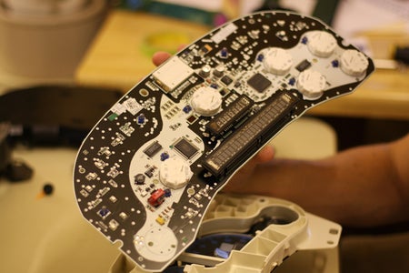

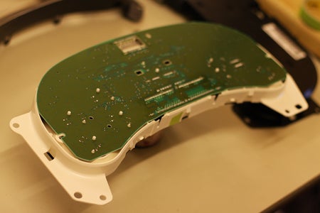

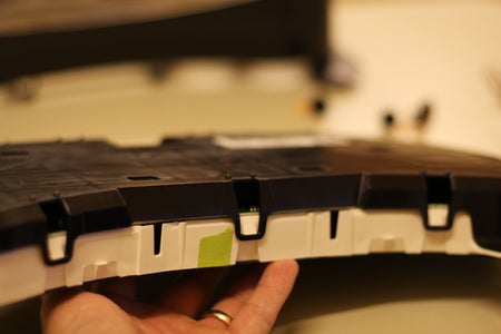

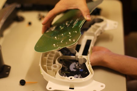

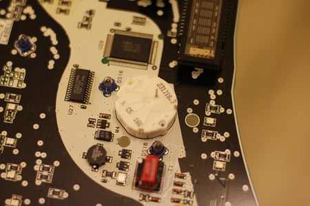

Step 5: Removing the Back Case and Circuit Board
Now pry outwards on the tabs of the back case to remove it, similar to how you removed the front lens.
Now you can simply lift out the circuit board. In the final pic you can see 7 white stepper motors you'll be replacing.

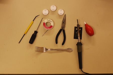

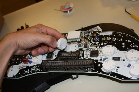

Step 6: Motor De-soldering and Tools You'll Need
Ok you're now ready to remove the old gm stepper motors and replace them with new ones.
Tools you'll need:
- Solder iron (not solder gun, they're too hot)
- Solder
- De-soldering bulb
- Pry tools
- GM stepper motors (one for each gauge, replace them all while you're in there!)
Use the de-soldering bulb and the solder iron to suck off the old solder on each of the four pins of each motor. Do not get it too hot for too long or you can damage the circuit board. Now you can pop the motors off the front of the board once all the old solder has been removed. If it's they're too difficult to remove you need to suck off more solder.

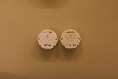

Step 7: Replacing the Old Stepper Motors With Your New Ones
Now you simply need to pop your new GM stepper motors where the old ones were, they will only install in one direction so you don't have to worry about mixing them up or getting it wrong. Make sure you get the correct part number when you buy your stepper motors (see link above for correct parts). Then you use the solder and iron to solder on a small amount of solder to each motor's pin. The solder should flow on smoothly, quickly and cool to a even shiny finish if done properly.
Place the circuit board back into the white center housing and snap on the black back housing. Now slide each needle back onto the shaft of each new motor being careful to slide it on smoothly and straight down not at an angle, to prevent bending the motor shafts. It doesn't matter what angle the needle is pointed at this step but, to make it easy slide them on pointing roughly at the 12:00 position.
Finally, rotate each needle counter clockwise until the tip of the needle points right to the mark on the masking tape that you made in a previous step. Remove tape and snap clear lens back on making sure to line up the odometer selector stalk. Clean the lens before installing if needed.
