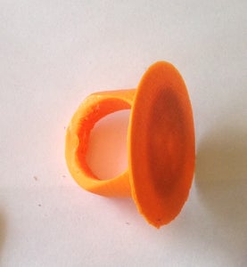

  • 3D printed base and the Lid for the ring, pick up the STL files from Step 2 and Step 3.
  • Super Glue
  • And Sand paper to smooth out the rough edges of the 3D printed part

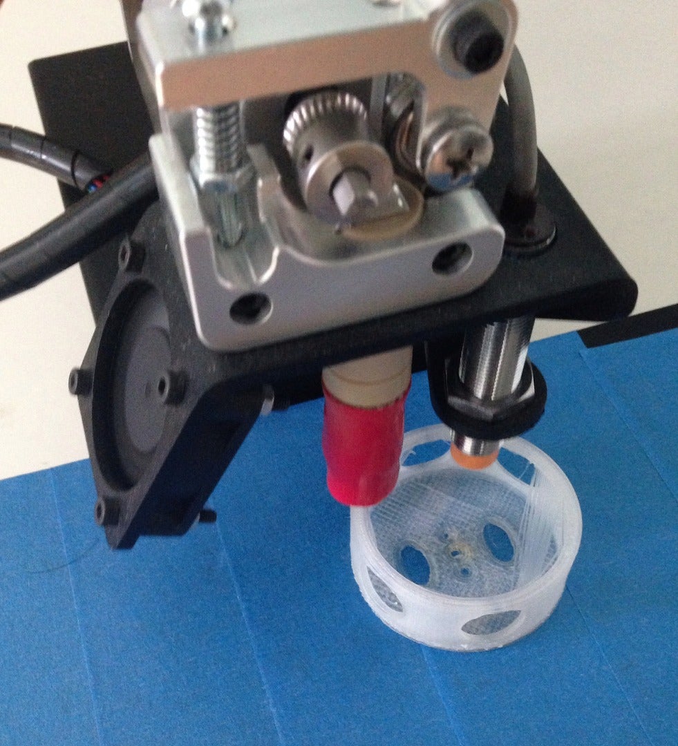

Step 2: 3D Print the Base
Download the 3D printing software that you printer supports, in my case I am using the Printrbot Simple Metal which use Repetier-Host as a software to
  • Slice the STL files attached,which basically means cutting the part into various layers
  • And send commands to the 3D printer while printing
In my case I am using the following filament HATCHBOX 1.75mm Transparent white PLA
Download the FingerJingleBase.stl file attached and using your printer software
  • Slice the file, this should take about 45-50 seconds
  • And printing the file should take about 45-50 mins and is dependent on your printer settings.

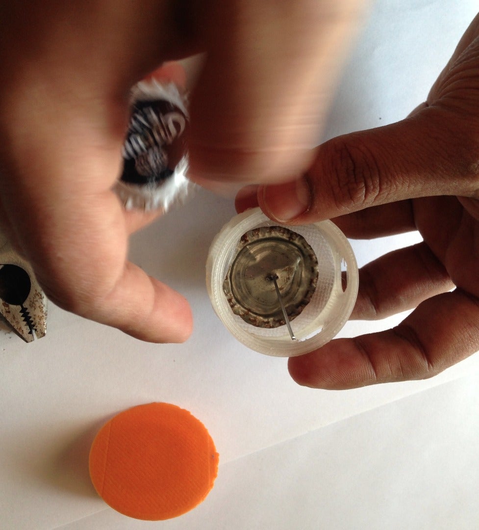

Step 5: Securing the Caps to the Lid Using Paper Clips
Bend the paper clip, and thread it through the Base of the 3D printed part as shown in the first two pictures above.
Cut of the end of the paper clip if you feel it is too long.
Add the caps through the paper clip so that the bottom of the caps are facing each other as shown in the picture above.
Use a set of pliers to bed the paper clip towards the bottle cap.
Now run a quick test by placing the orange lid on top of the base, adjust the paper clip using a set of pliers if you are not happy with the sound.

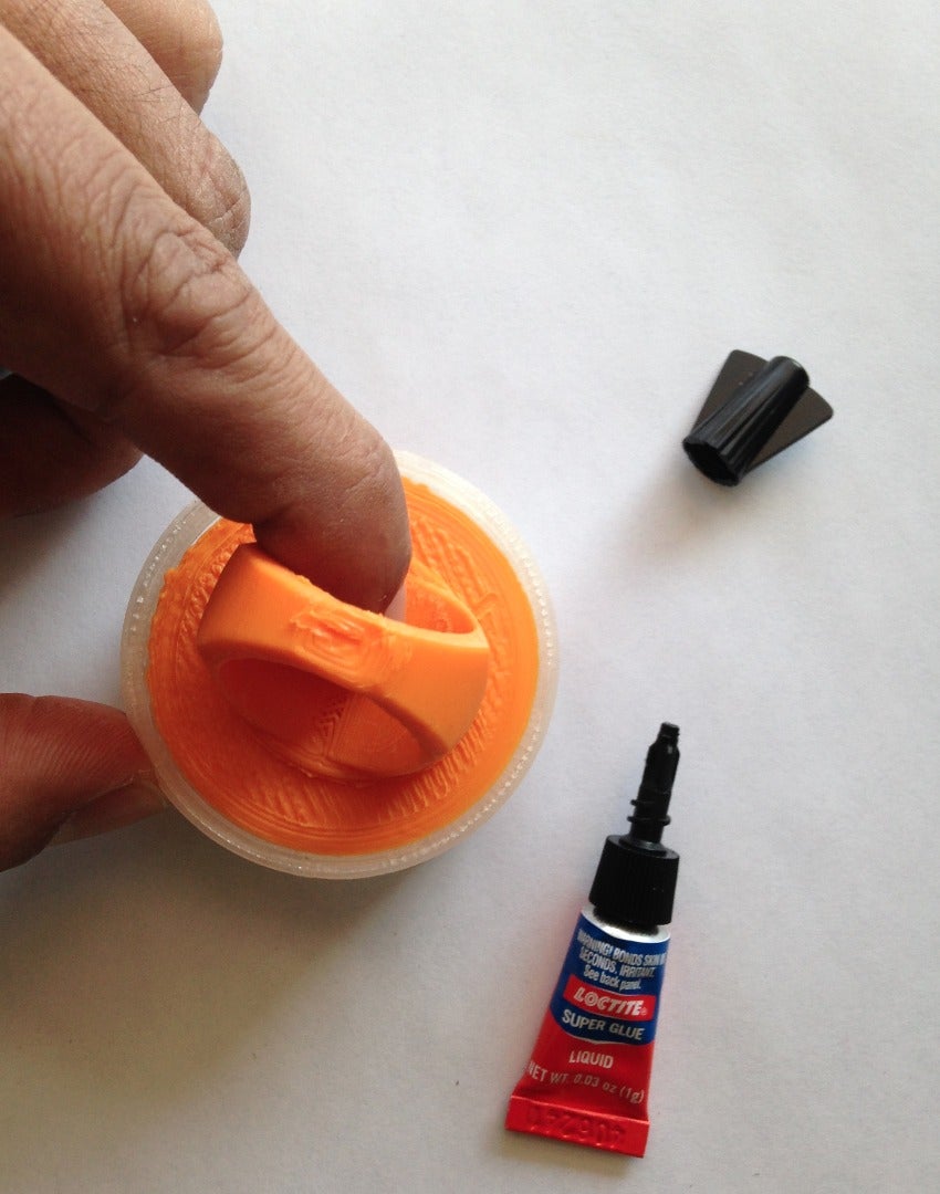

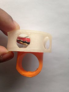

Step 6: Use Super Glue to Secure Base to the Lid
Apply super glue to base and place the lid on top.
Press and hold the lid for 2-3 mins till the super glue drys off..
Congratulation your done !! Enjoy your new Finger Jingles and add percussion to your finger drumming..
