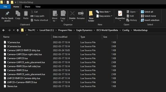

DCS comes with a bunch of "monitor setup" presets. They allow for things like expanding the view across multiple monitors and showing the MFDs in different places. Each monitor setup is stored as a .lua file in .../DCS World (OpenBeta)/Config/MonitorSetup by default. I started with the 1Camera.lua file and added the LEFT_MFCD and RIGHT_MFDC with an x, y, width, and height.
My second monitor is left of my main monitor, and (0, 0) is at the top left of Monitor 1 (my main monitor), which means if I were to put the MFCDs on the left monitor without changing the display layout, their x coordinates would be negative. However, I could never get this configuration to work with DCS. I solved this problem by moving the second monitor to the right of the first in Settings (I didn't bother to physically move the second monitor), and making the x coordinates of the MFCDs positive. I also had to change the horizontal resolution in DCS to have it stretch across both monitors. Applying these changes requires a restart of the simulator.

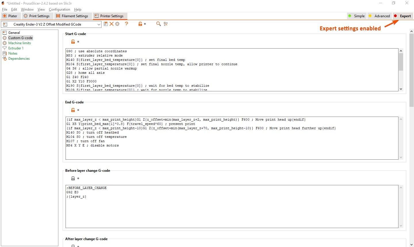

I modeled and printed the parts to attach on top of the button boards. I tried to print with sharp square corners on the outside at first, but they peeled up so I switched to rounded outside corners. I kept the sharp inside corners to make sure the whole display would remain visible.
The holes in the model for bolts are quite large relative to the bolt because 3D printers print horizontal circles a little small.
