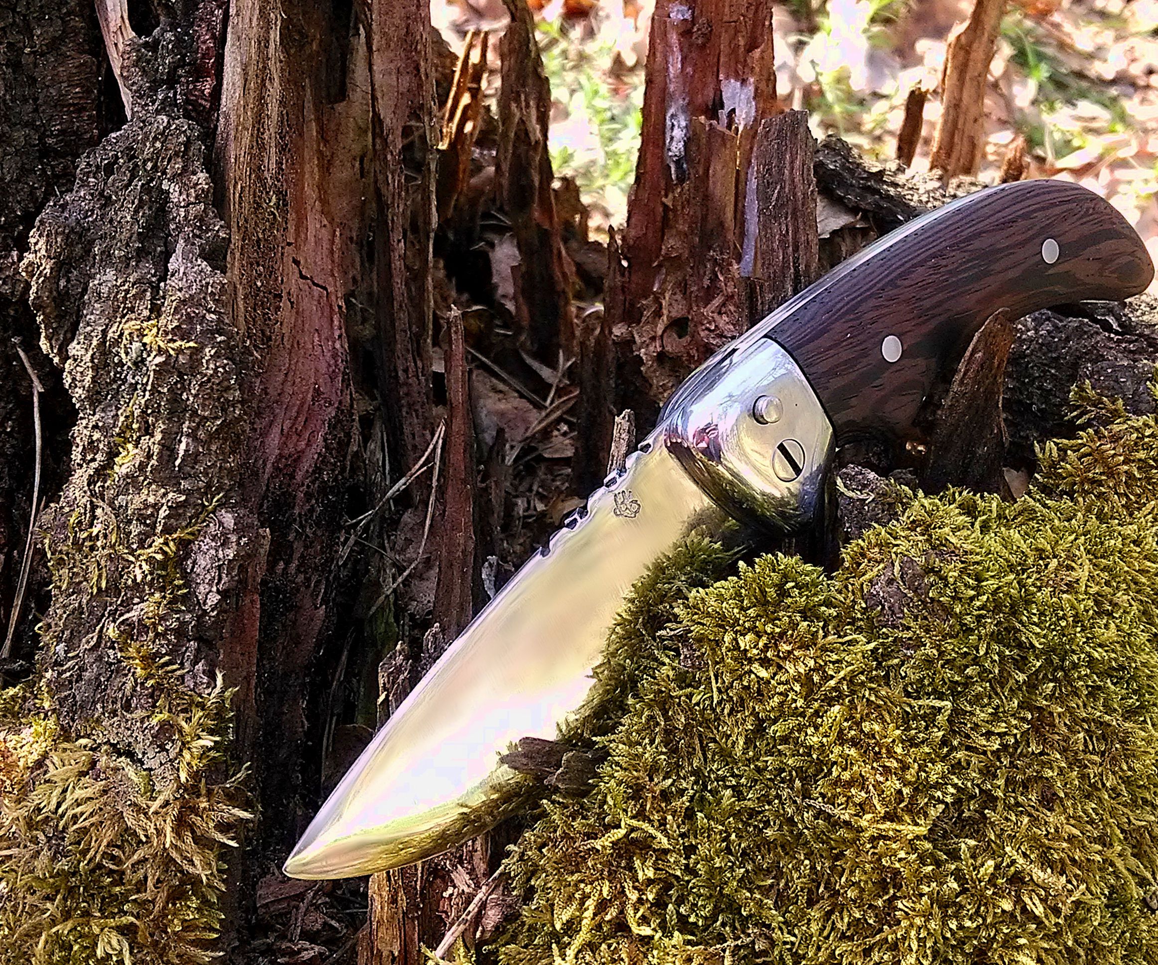

There is a sumup of almost everything about this knife
Dimentions : blade : 8cm long
1,3 mm thick
mirror polished
razor sharp
custom etched logo
handle: 10,5 cm long
1,5 cm thick
made from stainless steel and black zebrawood
with button locking system
Materials + costs : old saw used to cut metal - FREE
stainless steel from old washing mashine - FREE
zebrawood - FREE (because my father works with wood colours and got some samples of different type of woods)
another pieces of iron found throughout garden - FREE
so it costed me just time, sanding discs and electricity

Because I wanted to mark it somehow I etched my logo to the blade using two nine volt batteries and a vinegar. You pour some vinegar to small container and put there some salt - enough to the point that the salt no longer disolves. Now take a q-tip and dip it into the solution. Than connect two batteries. The positive wire connect to the blade and the negative put on the q-tip so it touches the cotton saturated in the solution. Prepare your blade by cleaning it with alcohol or soap. Use nail polish to cover the area where you want your logo. Scratch your desired image with toothpick. Now you can start etching. (I recommend trying it on some spare metal, because you won't do it well on first time.)
Another good thing is to punch out of plastic paper organiser two small circles with holes inside. Take these and put them between the blade and the steel part of the handle. With a bit of lubrication using WD-40 the knife opens and closes much smoother.
The last thing is to sharpen it. I used wet stone and some rod used to sharpen kitchen knives and finished with a strip of leather. I compared the sharpness with my old razor blade and I must say that it's almost the same.
And that's it. 40 hours of fun, dubstep music, sweat and blood (yes blood I am not the most careful guy so with literally every knife I own, I have cut myself at least once). But it was worth it. The best thing that you can hear from others is when they ask you where you bought it and if your job is going to be making and selling knives.
