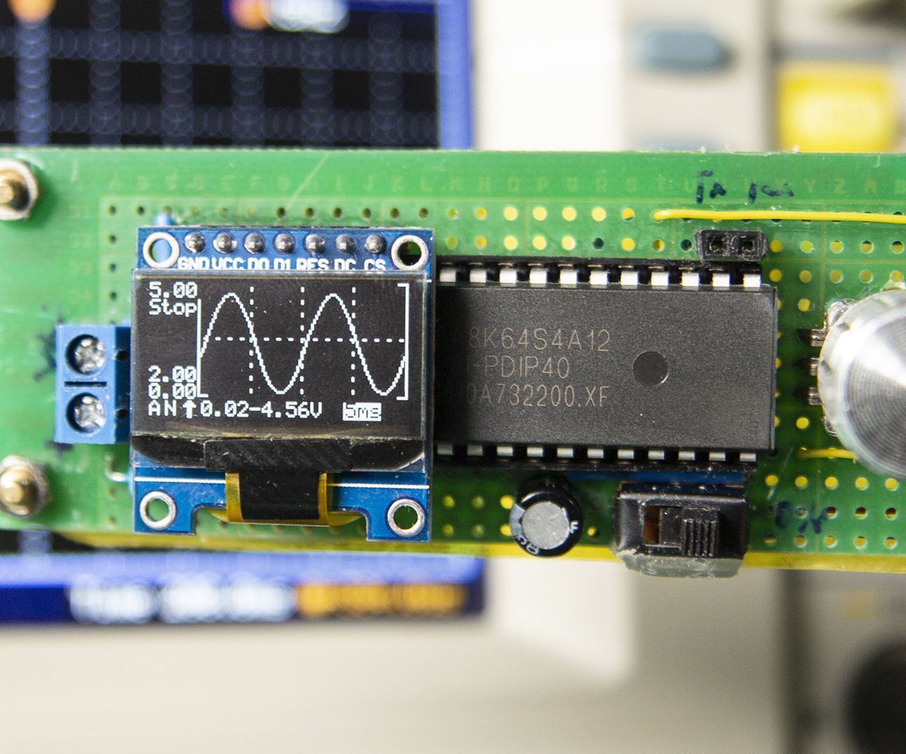

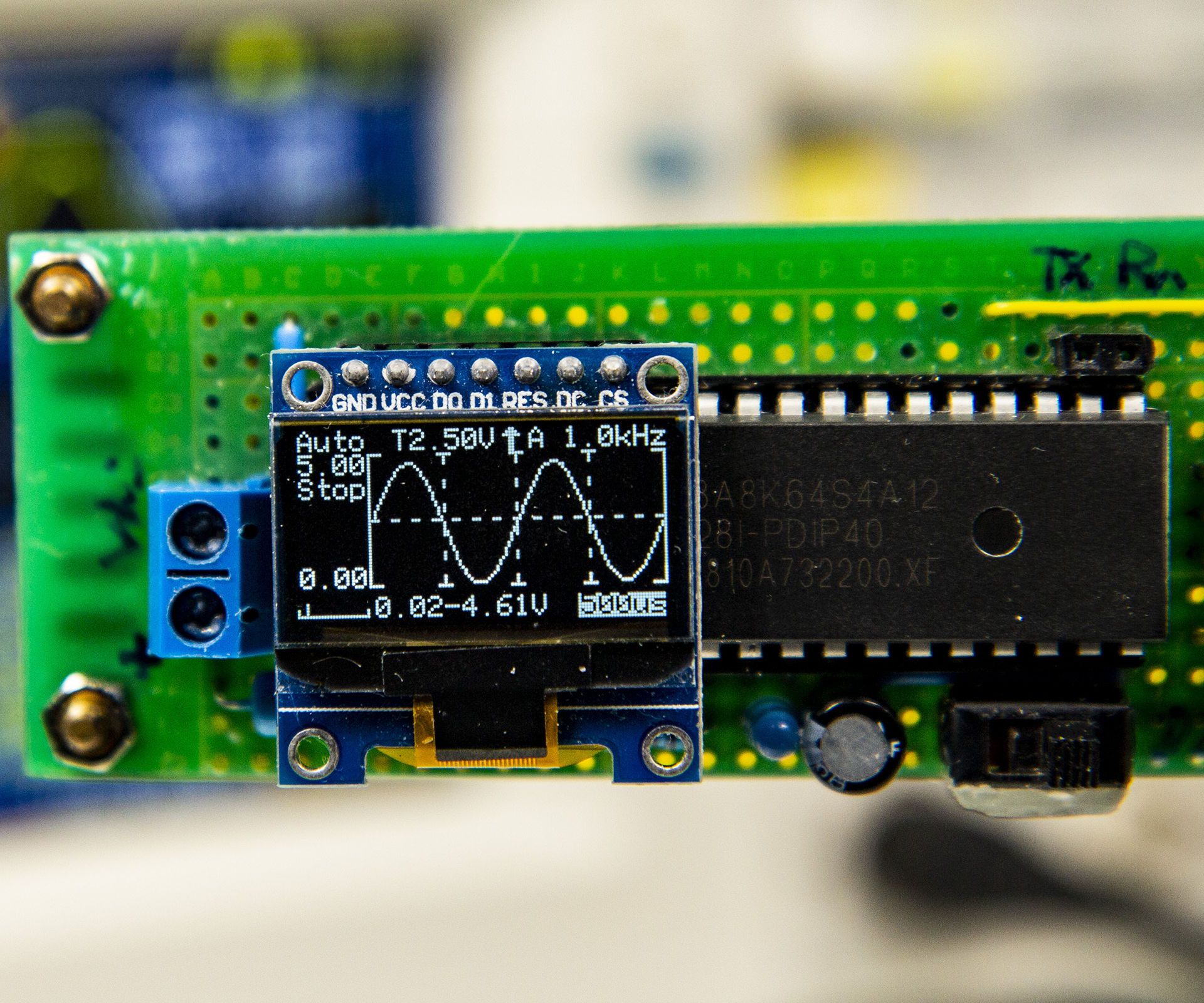

You could use this DIY Function Generator to output Square waveform or Sine waveform signal.
Interface:
- Bottom left shows the type of waveform(Square/Sine) and output status(ON/OFF)
- F: Frequency
- D: Duty of Square Waveform
- CD: Clock Division Coefficient (For information only)
- P: PWM frequency for generating Sine Waveform (For information only)
- Pt: Number of points for generating Sine Waveform (For information only)
Operations:
- Single Click Encoder: Switch Frequency and Duty in Square Waveform Interface
- Double Click Encoder: Start/Stop Signal Output
- Long Press Encoder: Switch between Square Waveform/Sine Waveform/Voltage Information
- Rotate Encoder: Adjust Parameters
