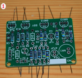

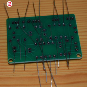

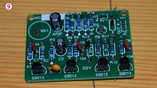

Step 1: Solder the Resistors Into the PCB
Resistors do not have polarity, just follow image 1 to 3 to solder the Resistors into the PCB. The corresponding position of each resistor on the PCB has the resistance value printed within the white rectangle area. Before inserting the resistors into the PCB you should make sure each resistor is in the correct place or the circuit won’t work properly. How to identify the resistance value of the resistor? There are two approaches to do so, one is to read the value from the color bands printed on its body and the other is to use a multimeter to test it out. But in this project, I highly recommend you to use the multimeter to measure it out that can save you a lot of time. If you would like to know how to read resistance value from the color bands please go to How to Read Color Codes from Resistors.

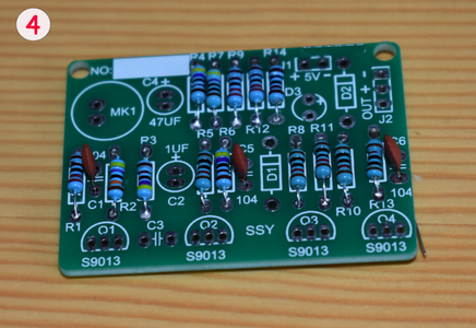

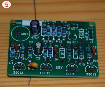

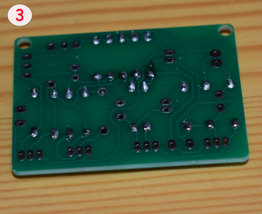

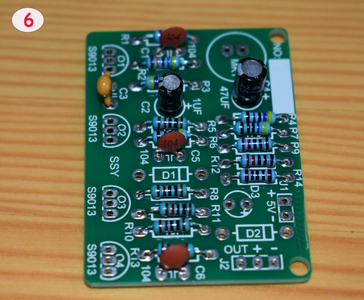

Step 2: Solder the Capacitors Into the PCB
Follow the image 4 to 6 to solder the 104 Capacitors and Electrolytic Capacitors into the PCB. Please note that electrolytic capacitors have polarity, the long leg should be inserted into the hole near the ‘+’ symbol on the PCB while the short leg near the white band should be inserted into the hole in the shadow area on the PCB. The 103 and 104 Capacitors have no polarity that no need to care about the direction.
Step 3: Solder the 9013 Transistors Into the PCB
The flat surface of 9013 NPN Transistors should be at the same side of the diameter of the semicircle printed on the PCB. To identify the model number of the transistor just need to read the number carved on the flat surface of the transistor, as shown in image 8.
Step 4: Solder the Diodes Into the PCB
Diodes have polarity, the black end marked with red circle in image 10 is connected to the negative end(Low Potential End).
Step 5: Solder the Header Pins and Microphone and LED Into the PCB
Solder the short end of the header pins into the PCB and leave the long end for outer connection. The white circle on the PCB should almost be fully covered with the microphone as shown in image 12. The LED has polarity that the long leg should be inserted into the hole near the ‘+’ symbol on the PCB. As of now the project has been finished.
