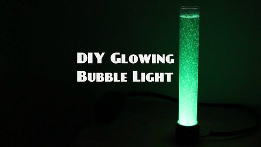

In this video, we will be building a one of a kind futuristic desk light. Not only is this light unique and cool to look at, but the air bubbles make quite a relaxing sound. Let’s get started with the build!

And that’s it for the construction of the light! All that I have to do now is add some liquid.
Step 12: Making the Glowing Liquid
I will be using the assorted package of highlighters to make the glowing liquid for the light. First I removed the inner tubes of the highlighters that hold the dye and let them soak in cups of water for about an hour. Once the hour was up I squeezed out as much dye as I could and I was left with these very colorful liquids that will glow bright when exposed to the ultra violet LEDS.
The green definitely glows the brightest, and the blue doesn’t seem to glow at all.
Filling up the tube with water and then adding a ¼ cup of the highlighter solution is enough to make the light glow very bright. I am going to keep my highlighter solutions in water bottles so that I can switch the color of my light whenever I like.
