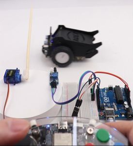

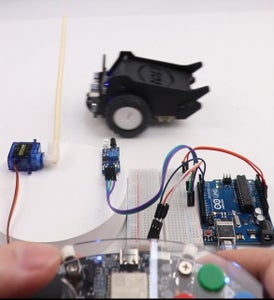

Embarking on the journey of learning Arduino opens up a world of possibilities for enthusiasts to create innovative projects. In this article, we'll delve into the exciting realm of simulating a garage door opener using Arduino. By following these steps, you'll not only gain a better understanding of Arduino modules but also have a functional garage door opener of your own.

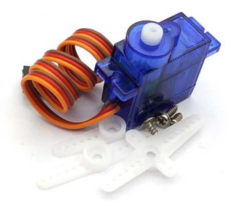

Step 1: Understanding the SG-90 Servo Motor
The SG-90 Servo has 3 wires, with two of them being VCC and GND for power, while the third wire is for the signal input. The control signal for the servo operates on pulse width modulation (PWM) with a period of 20ms. The pulse width ranges from 0.5ms to 2.5ms, corresponding to a rudder position of 0 to 180 degrees. Essentially, providing the servo with a specific pulse width will maintain its output axis at a corresponding angle, regardless of external torque, until it receives a pulse signal of a different width to adjust to a new position.

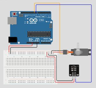

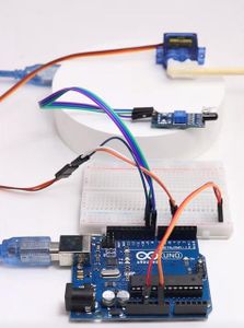

Step 2: Connecting the Components
When connecting the components, ensure that you correctly identify the positive and negative terminals to avoid damaging the components. You can choose the ports for connecting the servo and the infrared (IR) sensor according to your preference, but ensure that the servo is connected to a port capable of generating PWM signals.

Step 4: Testing
After uploading the code to your Arduino board, adjust the trigger distance of the IR sensor manually to ensure it detects the proximity of passing objects, such as a car. Proper calibration ensures that the IR sensor triggers the servo motor to actuate the garage door opener mechanism.
