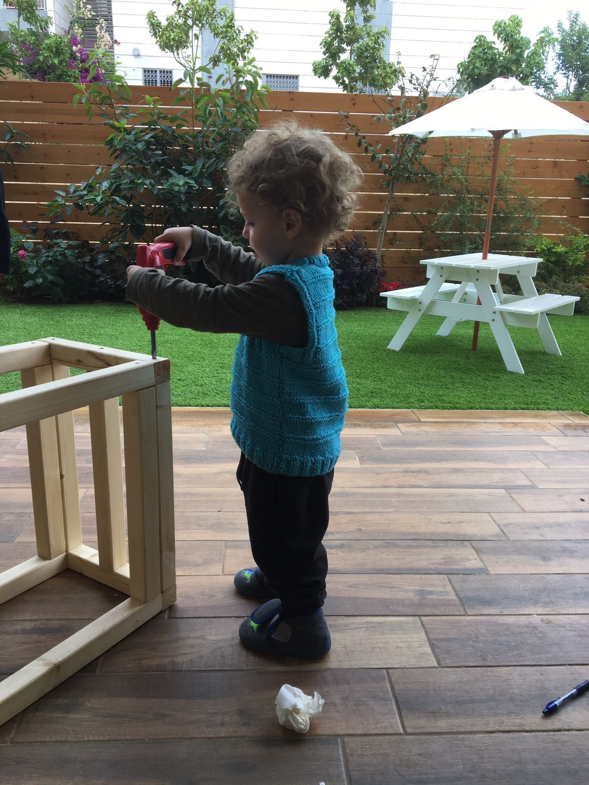

Step 5: My Little Helper
My little son brought his set of toll in order to help me
