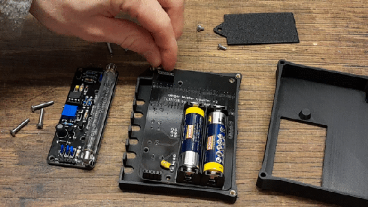

Step 6: Printing the Housing & Preparing
First, print the top and bottom of the case, as well as the battery lid. If you've added the ICSP header, make sure to print the top with the corresponding cutout. You can even print the radioactive symbol in a different color and glue it on top — it really makes your Geiger counter pop!
Next, take the eight threaded heat inserts and press them into the holes as show in the pictures. The smaller heat insert goes in the back to hold the battery lid.
Step 7: Assembly

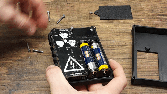

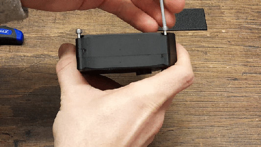

Now, place the Geiger counter into the top housing and screw it in securely with two screws. Attach the bottom part and fasten it with three screws. The battery lid will snap into the cutout on the other die of the screw.
And just like that — your very own Geiger counter is fully assembled! Pop in the batteries, flip the switch and enjoy your new tool.

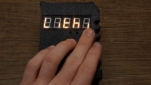

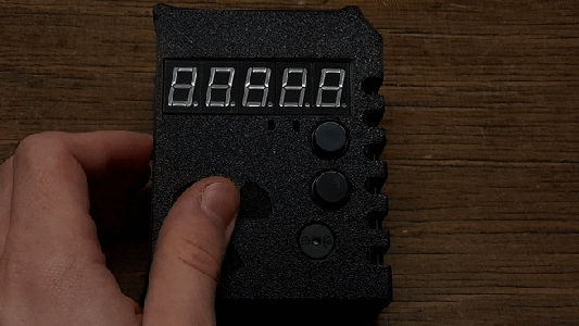

Step 8: How to Navigate
The two buttons on the Geiger counter let you navigate through its features. When you power it on, you'll see a quick boot animation. Before launching into the main loop, it will display the battery percentage — the display brightness will reduce if too low.
Pressing the lower button cycles through the different measurement modes: µS/h (microsieverts per hour), cpm (counts per minute) and counts.
The upper button resets the counts back to zero, which also restarts the µS/h and cpm readings. Holding down the upper button takes you into the settings menu. Once there, the lower button cycles through the options and the upper button changes the selected setting. A long press brings you back to the main display.
All your settings are saved in the EEPROM, so nothing is lost when the power is turned off.
Here's what you can adjust right now:
  1. Battery type: Alkaline, NiMH or Lithium
  2. Sound: On or Off
  3. LED: On or Off (note: the warning LED can't be turned off)
I might add more options later, but for now, these are plenty to keep things simple and functional.

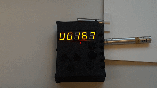

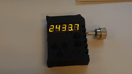

Let's wrap things up: I'm happy to say that I've met all my goals for this project! The Geiger Counter is fully portable, has that nice retro vibe, makes satisfying clicks, and — most importantly — it actually works. So far, I've learned that I don't own anything particularly radioactive at home, which is probably a good thing... even if I wish the numbers would climb a bit faster!
To really put it to the test, I reached out to my od physics teacher, who kindly offered to check the counter with some actual radioactive sources. From those experiments, I can say with confidence that the counter performs great. We even managed to overload the display. Since the progam uses interrupts to detect pulses, an extremely high pulse rate doesn't give the MCU enough time to update the display between events. Just imagine the buzzer going absolutely wild!
A quick note on the calibration factor — while researching, I found this excellent article:
https://sites.google.com/site/diygeigercounter/technical/gm-tubes-supported
It suggests that a conversion factor of around 153.8 works reasonably well for converting CPM to µS/h. Because this is a DIY project, you should expect some accuracy limitations. Ideally, you'd test your own tube and determine a more precise conversion factor — but for general use, this values seems pretty good.
