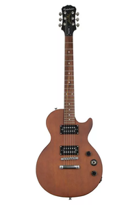

I always dreamed of building a guitar but didn't know where to start. One day I came across the Fender acoustasonic and I loved the Idea (but not the look). so I bought a used Epiphone les paul special ii and decided to turn it into a Gibsosonic guitar. I had fun and it sounds great.

Step 1: Take Apart the Guitar
First, I needed to strip the guitar to its bare bones.
that includes:
  • removing the strings.
  • removing the machine heads from the headstock (optional, but I changed the headstock as well)
  • removing all the electronics (knobs, pickups, switch, bridge, volume and tone pots)
at this point, you can also sand the body to remove any existing paint/stain/finish from the bottom and sides.
