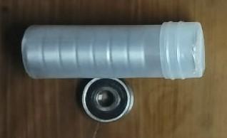

  3. 2 x bearings ID=8mm, OD=24mm, Width=8mm (₹62 - $0.71)
  4. 4 x bearings ID=5mm, OD=8mm, Width=2.5mm (₹420 - $4.78)

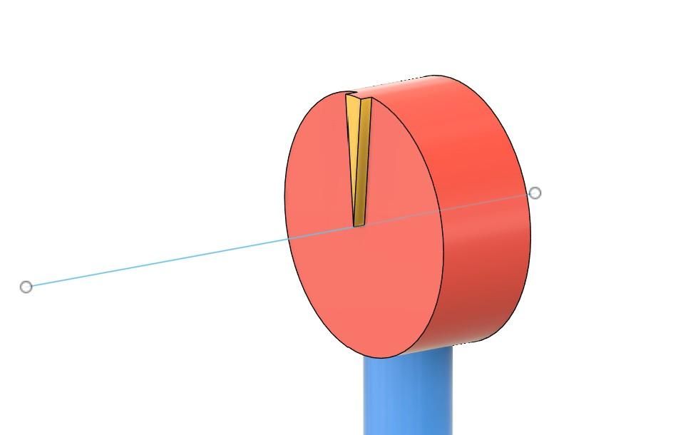

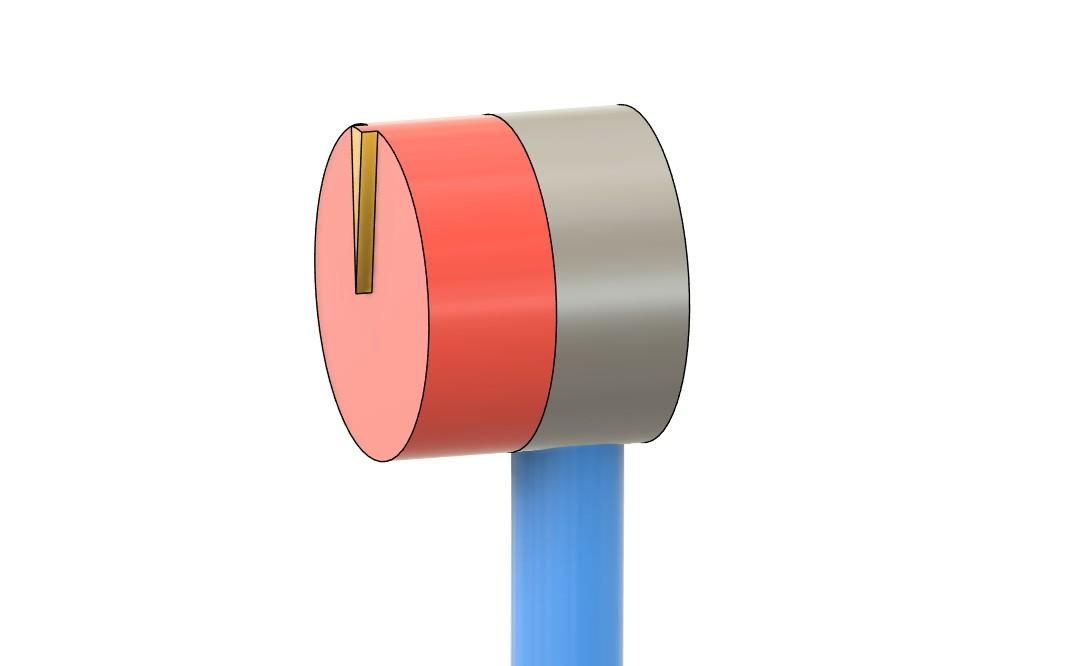

To explain this: lets take a disk and a rod as shown in the picture below:
here the disk with a marker (in yellow) on the red surface. If the blue rod solidly attached to it is rotated at an axis perpendicular to the face of the disk (axis as shown), the disk rotates along with the rod (as shown in the below gif).
Now to make the disk stationary, we need to attach a bearing (in metallic colour) or any contraption that helps the rod move freely and the disk stays in place (take it as an example, ignore the other physics for now) as shown in the picture and the gif below.

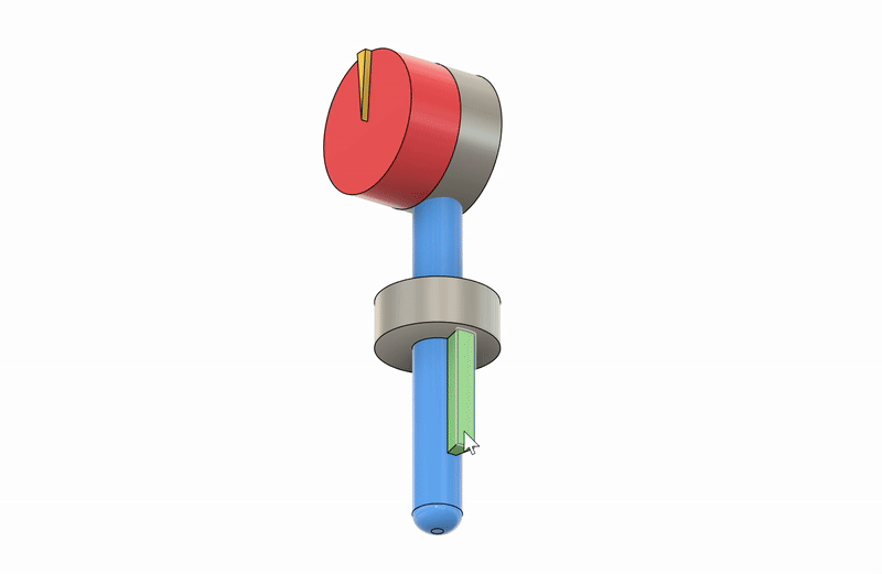

Now, if we wish to make the rod rotate along the axis of its length, we can see that the disk also rotates with it like a table fan (as shown below).
So to make the disk stationary, we would need to add another bearing to make the rod rotate freely along its length without the disk turning with it (as shown in the gif below).
this way we finally have a simple bearing that stabilizes 2 axis. Now, the question arises on how the disk can stay still? even if we use the best quality bearings (which is very expensive), the disk would still move a bit when turning the rod whichever way. This balance and physics we shall see in the next step!

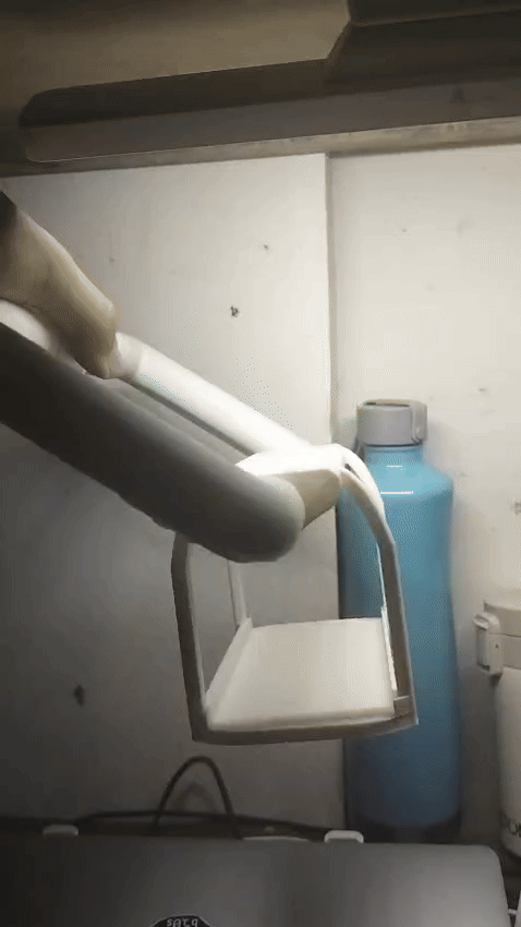

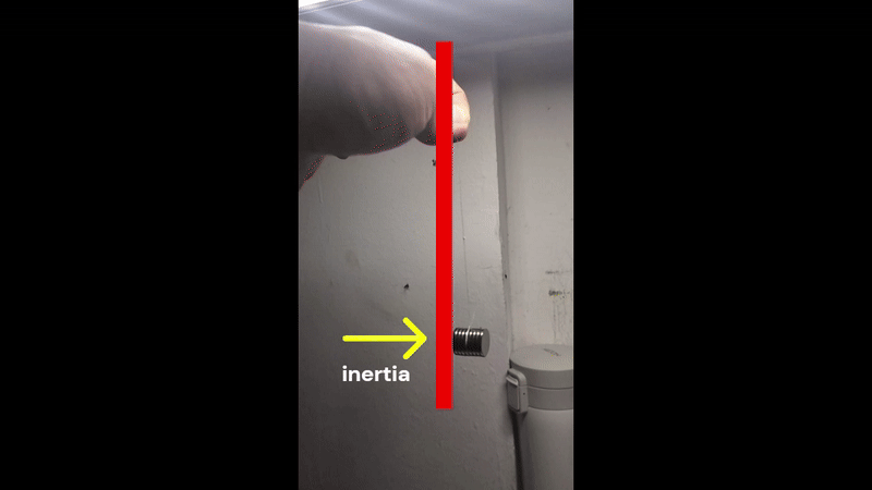

So for a passive gimble (The one which we are focussing on now) requires the inertia of the object that we are stabilizing. If the object is not heavy enough, we can either add counter weights that oppose movement or a spinning disk that has high inertia due to angular momentum (gyroscopic effect). The more the weight of the disk is near the edge, the more it resists against changing motion.
To better understand this, in the gif given below, I attached a few neodymium magnets to a string and let it dangle freely.
Once the magnets are stable, I quickly yank the tip of the string that I am holding to one side. We can see that the magnets stay near the same position for a split second. This is due to its inertia, the magnets wants to continue staying stationary.

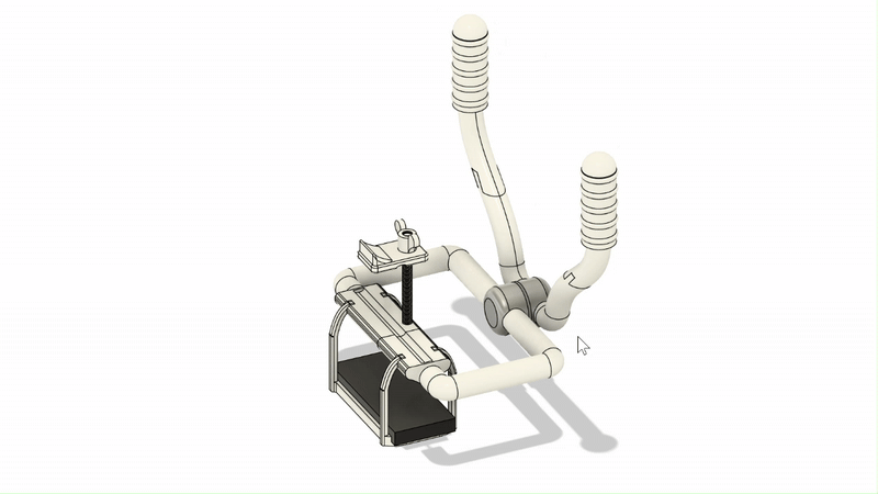

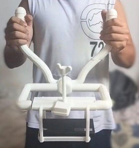

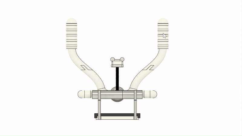

The concept here is very simple, make a 2-axis gimble that we can hold with two hands and can stabilize the twist sideways and from top to bottom. (better explained further)
The gimble consists of two handles and is connected to a common hub that has a bearing in it. Then to another hub directly opposite to it with another bearing, it connects to an arm that holds the mount where the phone/camera can be attached. (As shown in the picture below)
The movements of the gimble are shown in the gif below:
I was thinking to add a spinning disk, but that will increase the cost and also make it a lot more complicated. So I decided to ditch that idea and also the idea to stabilize the z-axis (up and down movement).
The goal of this gimble is to provide a cheap alternative to the other ones available in stores that can go upwards of 5000 rupees ($56.93). And for some reason... a passive gimble is wayyy more expensive...

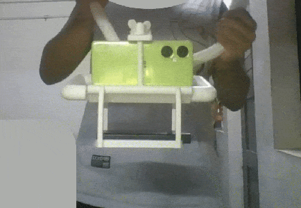

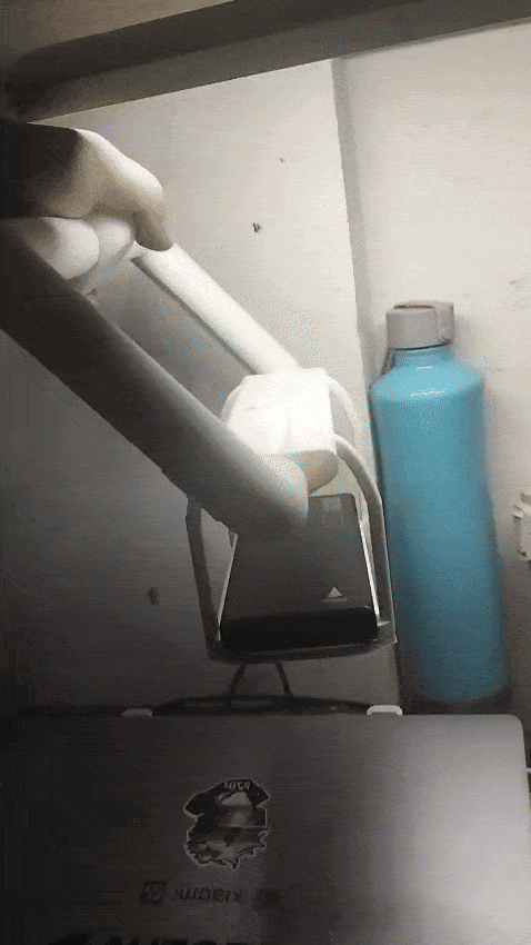

Also we can see the difference in stabilization when the holder has no weight and the holder has weight.
No weight:
With Weight:
As the weight increases the stability increases.
Step 4: 3d Designing the Handle
To design the handles:
  1. I first sketched out an outline for the handles.
  2. then on a different plane, I made the profile of the tube (2 concentric circles)
  3. Using the sweep tool, I used the profile to make the curved handle.
  4. For the grip, I used the standard extrude and revolve tool for the curved end.
Step 5: 3d Designing the Arms
To design the Arms:
  1. I first sketched out the outline of the arms,
  2. Then on a different plane I made the profile of the tube.
  3. Then using the sweep tool, I made the full tube of the arm.
  4. made a small hole for the small bearing using extrude.
Step 6: 3d Designing the Mount
To design the mount:
  1. Firstly, I made the profile of the mount(where the phone goes on top).
  2. Then I extrude the required length.
  3. Offsetting another plane, I draw the profile of the groove(where the phone will sit in) and used the extrude tool to cut it out.
  4. For the bolt, I made a sketch and extruded its length, used the 'thread' tool and selected the 'modeled' option.
  5. For the hanging counter weight, I made the profile of the bottom and extruded it.
  6. Then for the connecting pillars, I first made a path which is the curve of the pillar.
  7. Then using the previous profile, I used the sweep tool to make the pillar.
  8. Then I carved out the part that the pillar and the mount overlap, Then used the mirror tool the do the same at all four sides.
  9. I selected all the bodies and used the analyse tool to see its centre of mass and adjusted the base counterweight to get the centre of mass at the middle of the whole mount system.

Step 10: Trying It Out!
Step 11: Conclusion/reflection
Assembling this DIY gimbal was a tremendously rewarding and enjoyable experience. What began as a mere thought to stabilize my phone camera shots so they would not be shaky became a full-fledged design–print–assemble process that taught me not only the inner workings of gimbals, but also how inertia and balance were crucial in stabilization.
Of course, this gimbal is not as flawless or sophisticated as commercial 3-axis motorized ones, but it demonstrates how simple passive design can significantly enhance stability with minimal bearings and a few 3D printed components. The contrast in smoothness between using the gimbal both with and without weight clearly demonstrates how much inertia helps achieve more smoother footage.
