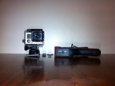

Step 1: Get Parts
For this simple project you will need
One 1/4″ bolt
Two 1/4″ washers
Two 1/4″ nuts
Also
Power drill
1/4″ drill bit
Hack saw
1/4″ wrenches
One 1/4″ bolt
Two 1/4″ washers
Two 1/4″ nuts
Also
Power drill
1/4″ drill bit
Hack saw
1/4″ wrenches

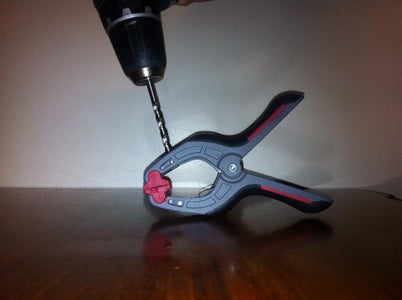

Step 2: Start Drilling
Now get your drill and drill a hole so the bolt can go through. Choose a spot that's not on the handle so it won't be hard to clamp..

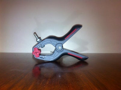

Step 3: Insert the Bolt
Then put the bolt through the hole and add the nuts to stop it from coming out

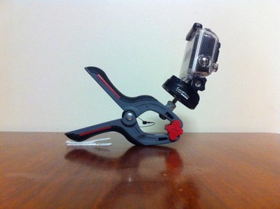

Step 4: Attach the GoPro
Now attach the GoPro with the GoPro tripod mount
