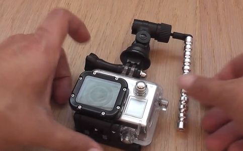

This steadycam hack for your gopro consists of
  • suction cup mount
  • tripod mount
  • grip
Step 1: Build

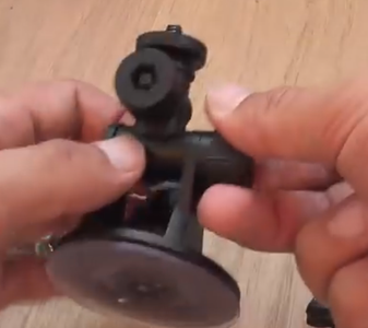

  • remove the 2 axis joint of the suction cup mount, screws have to be quite loose in order to work as gimbal

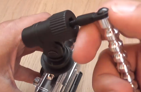

  • add the tripod mount
  • add the grip for the 3rd axis
The gopro faces downwards. Its weight will act as a stabilizer.
