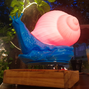

You can also make your own beautiful lamp bases using wood, acrylic, or by printing. I also hope that this tutorial will give you many ideas to DIY lamps or other unique products using the technology of the Magnetic Levitation Base or wireless power supply circuits.

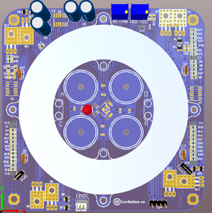

Step 2: Detailed Main Board

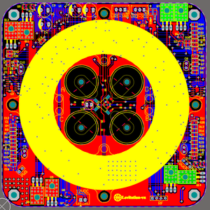

Here is the main circuit diagram of the Magnetic Levitation Base.
It uses magnetic effects (resonance, magnetic energy compensation) to balance and levitate an object with a magnet.
The circuit diagram, PCB layout (Designed on Altium software), and component list are attached in the link below.
Source Magnetic Levitation Base

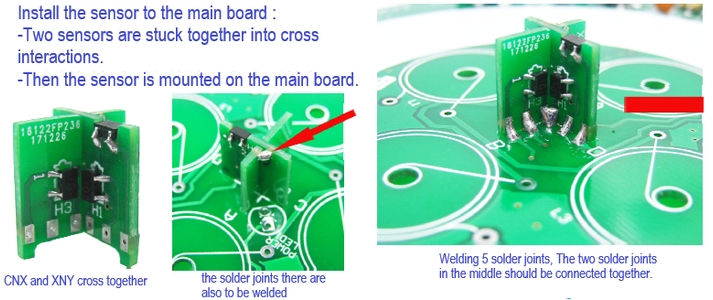

Step 3: Magnetic Field Sensor
This is the magnetic field sensor,
which helps balance the system based on the magnetic field values.
The detailed soldering method for the sensor is described as shown in the image above.
Source magnetic field sensor

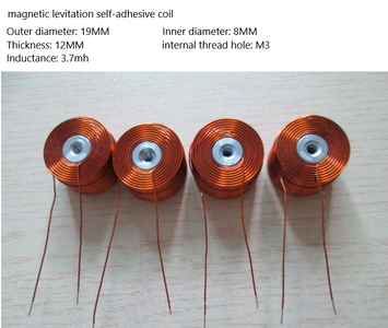

Step 4: Install Inductor
This is the position and soldering method for the coils providing the magnetic field for the main circuit.

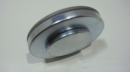

Step 5: Attach Special Components to the Main Board
Here is an image of the main board after the electronic components have been assembled and soldered onto the PCB.

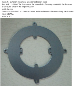

You can also see the silver screw from the back into the iron sheet.
fixing the inductor on the circuit board.

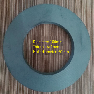

A metal iron sheet has been attached to help secure the round magnet of the board.
we will attach the round magnet to the metal sheet on the main board.
This magnet provides the primary magnetic force, which, combined with the automatically adjusted magnetic forces from the four coils, helps balance our Magnetic Levitation Base system.

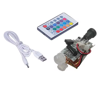

Step 7: Module Led
This is the LED module used, which is a 16-color module controlled remotely via a remote control with a rechargeable battery.
Additionally, you can choose different types of LED modules, as they come in a wide variety of qualities, designs, and colors, like some of the modules I have here.
Remember to choose an LED module with a built-in rechargeable battery.

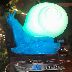

Step 8: 3D Printing Snail Lamp
I have also provided you with the design file of the snail lamp so you can 3D print it.
Based on the file I sent, you can also customize the shape, size, and choose to print it in your favorite color.
Actual image of the snail lamp model after 3D printing.
Here are some beautiful color combinations for the snail lamp that you can refer to.
The 3D printed file of the Snail Shell is larger than 25Mb, so you can download it from this link : 3D Snail Shell

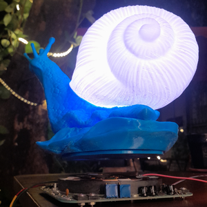

The last job is to attach the snail shell to its body to complete this interesting Snail Lamp.

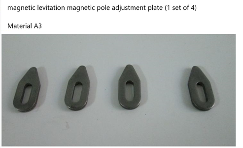

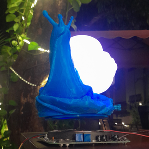

Step 13: Check the Functionality of Magnetic Levitation Base
The next step is to check and adjust the magnetic field of the Magnetic Levitation Base so the snail lamp can float in the air.
Use a 12V adapter to power the board.
Slowly move the magnet from top to bottom, if the magnet can balance and float, you can skip adjusting VR1 and VR2.
If the magnet cannot be hung, it is necessary to adjust VR1 and Vr2. The adjustment method is as above.
