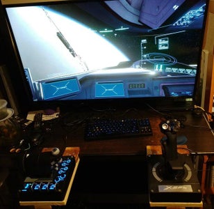

Third, put your joystick in place and screw it down to the platform. I needed quite long screws for this and didn't have any quite the right size, so I screwed in some longer ones to make holes, then clipped the ends and rescrewed. I used the impact driver for most of the length of the screw, then screwed the last cm or so by hand with a screwdriver, so as not to crack or scratch the plastic on the joystick.
Step 5: Pad the Support
The final step is to pad the support with non-slip padding, which holds the mount firmly against the bar under my desk, and stops it coming away. Combined with the grips you added in step 3, this provides 3 good points of contact and makes the mount stable.
My desk has a metal bar under it which the support can contact - depending on your desk, you might need to screw an extra spacer block on top of the support, potentially even shim that block so that it makes firm contact with the underside of the desk.

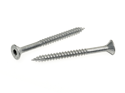

It's kind of the same idea, but with a long spacer board in the middle, and four top and bottom "grips" attached to it. Underneath the middle of that you'd put your support, then a 2x4 or equivalent as a post, and screw a couple of large beefy screws (like the ones pictured) down through all three to hold them together.
At the bottom of your 2x4, you'd have your joystick platform, a chunk of 2x4 screwed underneath, then more screws sideways through that chunk into the post. Doing it this way means that you can adjust the platform up and down easily, then maybe saw off the bottom chunk once you've got it right.

Well, my setup changed, so here are some pics of the 'Drop Dad Mount'. The upgrade only took a few hours, easily doable in an evening.
The only real change I made to the plans above was to make the lower grip one long board, mainly because I was too lazy to cut it into two grips. In theory that's a bit weaker, but since it only stops the mounts lifting, that's plenty - and these mounts are overbuilt anyway...
