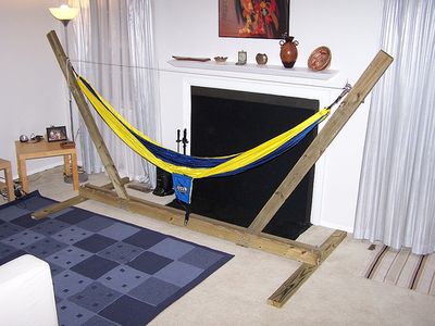

We recently bought a portable hammock and we've enjoyed so much on our hiking and camping trips that I decided I wanted to hang it at home to enjoy on our backyard. I looked at the available hammock stands and they seemed quite expensive but very simple so I decided to give it a try. I based the design on some of the available commercial options. This is what I used:

Step 1: Angled Cuts.
The first step is to make the angled cuts of the beams that will hold the hammock, the 6' beams. I made a 30 degree cut so that the angle to the floor would be 60 degrees.
Step 2: Drill the Holes
There are quite a few holes to drill for the bolts. The most tricky ones are the ones to attach the angled beams to the base.
The angled beams will be "sandwiched" between the two 8' beams and the bolts will go through all three pieces. To make sure I had a straight hole for the bolt to go through all three I laid down all three four pieces on the floor just as they would when standing and drilled once through all the wood. As you can see in the picture I made the holes 1" from the edges.
I should also note that the angled beams are not flush with the base beams. This is because the base will rest on top of the 4" pieces and hence be elevated about 2" from the floor. Having the angled beams reach all the way to the floor adds stability. You could also cut a "bed" in the base beams to fit the two 4" pieces so that the base would rest on the floor.
The other holes to be drilled are holes for they eyebolts where the hammock will hang, and the holes to secure the base to the "feet" the two 4" beams.

Step 3: Assembly
The final step is to bolt everything together. I used a washer on each side the bolt and a tightening washer on the nut side.
After using it a few days I've thought of a couple of improvements. The angled beams flex quite a bit when the hammock is rocking so I think some tensioners running from the top of the beams to the edge of the feet would increase the stability. however they could become tripping hazards!
I should also note that I choose these dimensions based on my hammock's length.
So far it's held pretty well up to 200 pds.
