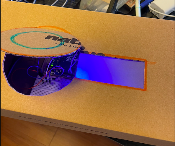

Step 4: Step 4: Arduino and Sensor
Place the Arduino inside the box beneath the servo
Drill two holes on the cover of the box for placing the sensor on it
And Drill one big hole at the size of the spray bottle
After placing the spray bottle, place the piece of hot glue that attaches with the copper wire onto the top.
Step 5: Step 5: Paper Roll (optional)
Use the left copper wire to make a small paper roll that can attach the side of the box.
