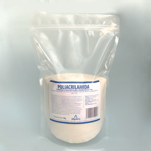

  1. Polyacrylamide (water-absorbing crystals)

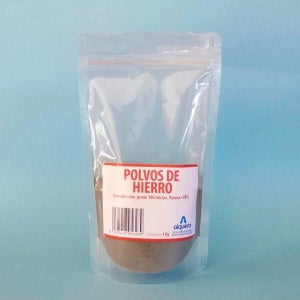

  2. Iron powder

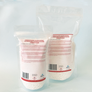

  3. Calcium chloride

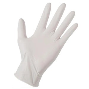

  7. Latex gloves (for safety)

  1. Polyacrylamide
  2. Iron powder
  3. Calcium chloride

Start by adding four spoonfuls of polyacrylamide into the sealable plastic bag. Always wear latex gloves while handling chemicals to protect your hands.

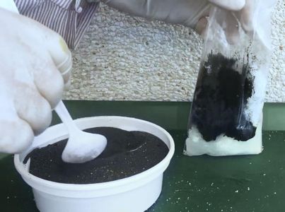

Step 3: Adding Iron Powder for Heat Generation
Once the polyacrylamide has expanded, add two spoonfuls of iron powder and mix everything thoroughly.
At this stage, a slow oxidation reaction begins. When iron comes into contact with water, it oxidizes (rusts) and releases heat. However, this process is quite slow on its own.

To speed up the oxidation reaction, add four spoonfuls of calcium chloride (double the amount of iron powder used). Calcium chloride enhances the reaction in two main ways:
  1. It increases the temperature of the water in the polyacrylamide, promoting faster iron oxidation.
  2. It provides chloride ions (Cl⁻), which act as oxidizing agents, making iron rust more quickly and generating heat faster.
Essentially, calcium chloride helps kickstart the process, making the heat release more noticeable and effective.

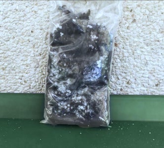

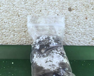

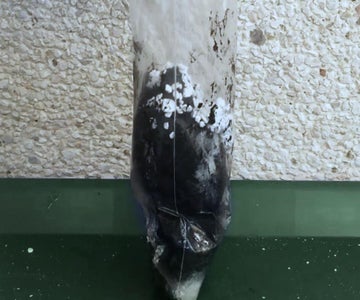

Step 5: Testing the Heat Output
Once all the components are inside the bag, seal it and wait for a few minutes. The mixture will start to generate heat. To measure the temperature, insert a thermometer into the mix—it should reach around 40°C (104°F), which is warm enough to keep your hands cozy without causing burns.
