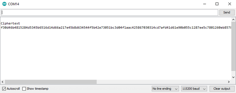

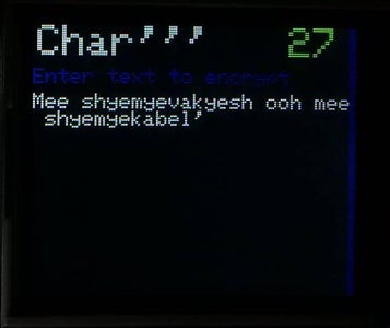

Since there's not that much space available in EEPROM, I've decided to use a single IV for a record stored in the EEPROM and to verify the integrity of the whole EEPROM area utilized by the Midbar (Teensy 4.1 Version) V3.0 instead of individually verifying the integrity of each record, the way it's done for the records stored on the SD card.

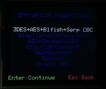

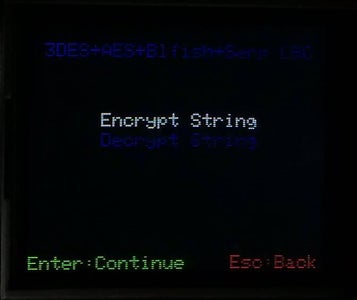

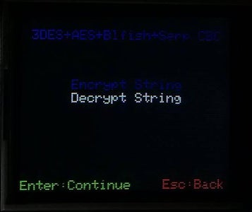

Step 4: 3DES + AES + Blowfish + Serpent in CBC Mode
The "3DES + AES + Blowfish + Serpent" encryption algorithm in cipher block chaining mode first appeared in the Midbar V2.5. And since then has been utilized by the Midbar (Raspberry Pi Pico Version), Midbar V3.0, Midbar V4.0, KhadashPay V2.0, Midbar (Raspberry Pi Pico Version) V2.0, KhadashPay V2.0 (Raspberry Pi Pico Version), Midbar V5.0, Midbar (STM32F401CCU6 Version), KhadashPay V3.0 (STM32F401CCU6 Version), KhadashPay V3.0, Midbar (STM32F401CCU6 + Arduino Uno Version), KhadashPay V3.5, Black Swan V2.0, Midbar (Teensy 4.1 Version), Hash Latch, Midbar (Teensy 4.1 Version) V2.0, Midbar (ESP8266 Version) V2.0, Midbar (STM32F407VET6 Version), Midbar (STM32F407VET6 + Arduino Uno Version), DIY IoT Data Vault With Google Firebase (Midbar Firebase Edition V1.0), DIY IoT Payment System With Google Firebase (KhadashPay Firebase Edition V1.0), Midbar (STM32F407VET6 Version) V2.0, and Midbar V6.0.
Although the "3DES + AES + Blowfish + Serpent" encryption algorithm ain't exactly what I would call "a cryptographically weak encryption algorithm," operating it in a weird derivation of the ECB mode, the way it was done by the Midbar V2.0 wasn't the best idea that I had. Even though that wouldn't've allowed the attacker to produce the legitimate ciphertext by swapping the blocks within the ciphertext, an attacker could still make a legitimate ciphertext by replacing the nth block of the ciphertext N1 with the nth block of the ciphertext N2. To fix that vulnerability (instead of just notifying the user that the decrypted ciphertext might've been forged), I made the "3DES + AES + Blowfish + Serpent" encryption algorithm work in CBC mode. So, if an attacker replaces a block of ciphertext, they spoil not just that block but also the subsequent one.
I'll be honest with you, the bit-flipping attack "kinda works," but I doubt that it would ever go unnoticed because of the "HMAC-SHA256"-based integrity verification feature
And let's not forget that this encryption algorithm performs the operation called superencryption.
As defined by NIST, superencryption is an encryption operation for which the plaintext input to be transformed is the ciphertext output of a previous encryption operation.
Such organization of the encryption algorithms makes a combined encryption algorithm that is at least as strong as the strongest one in the cascade, has a longer key, might be more resistant to some attacks, and might produce a ciphertext with higher entropy. Anyway. It won't hurt to have an additional layer of security (or several of them).
*Note that when using the "3DES + AES + Blowfish + Serpent In CBC Mode" encryption algorithm to encrypt data stored on an SD card, it takes 10 bytes of plaintext and 6 random bytes and produces 16 bytes of ciphertext. The same scheme applies when calling this algorithm from the "Encryption Algorithms" menu. On the other hand, it takes 16 bytes of plaintext and produces 16 bytes of ciphertext when it encrypts data stored in EEPROM.

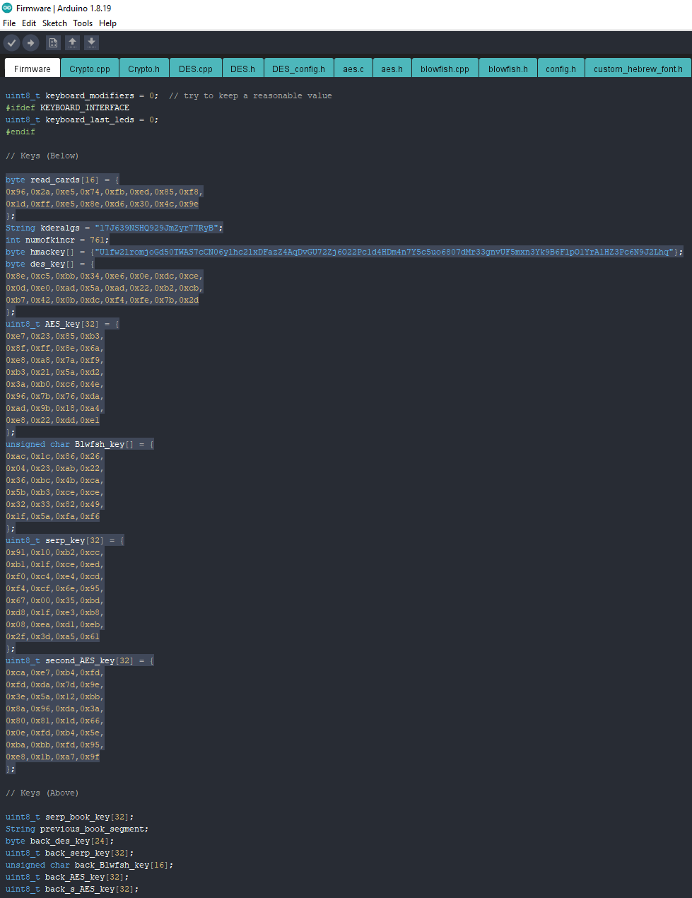

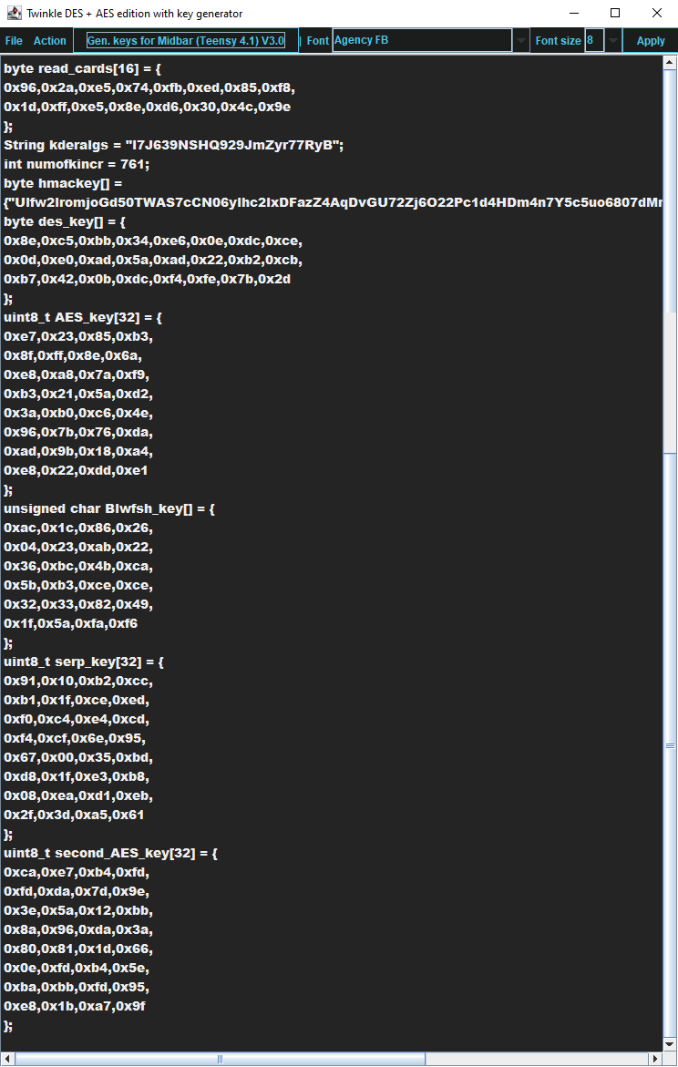

Step 10: Generate Keys
To make the unauthorized deciphering of your data computationally infeasible - It is crucial to generate your own keys and never reuse them
It's entirely up to you how to generate the keys. I can only offer you an option to do so.
I've modified one of my previous projects to work as a random number generator, the generated output seems "random enough" for me, but I haven't run any tests. So, I can't guarantee that it's random.
Use it at your own risk!
To generate the keys for Midbar - launch gen.exe from the "Teensy 4.1 Version\V3.0\Untested RNG" folder and click the "Gen. keys for Midbar (Teensy 4.1) V3.0" button. The background turns from dark gray to light gray when you press that button.
Step 11: Modify Firmware
Open the "Firmware.ino" file from the "Teensy 4.1 Version\V3.0\Firmware" folder, and then replace my keys with those you've generated.

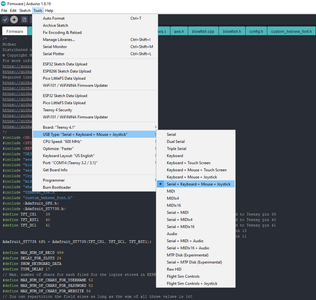

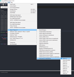

Step 12: Upload the Modified Firmware Into Teensy 4.1
Upload the modified firmware from the "Teensy 4.1 Version\V3.0\Firmware" folder into Teensy 4.1.
Don't forget to set the value of the "USB Type" line to the "Serial + Keyboard + Mouse + Joystick."

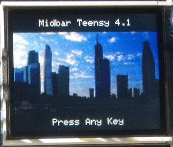

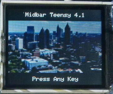

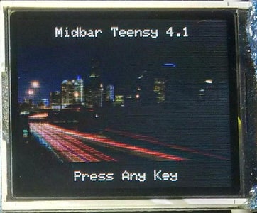

Step 14: Power the Midbar Up
After being powered up, the Midbar displays the "Midbar Teensy 4.1" and "Press Any Key" inscriptions alongside the lock screen.

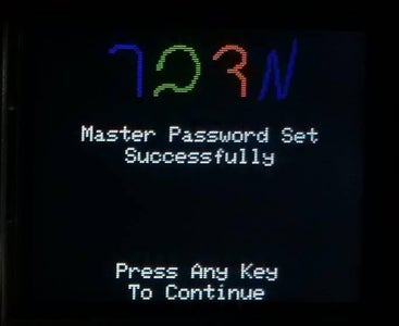

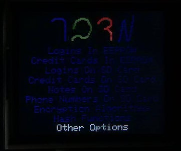

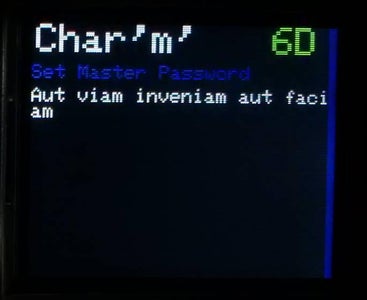

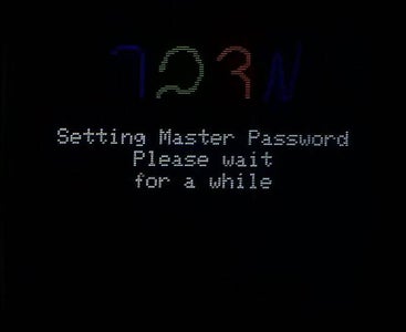

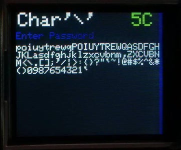

Step 15: Set Master Password
To use the Midbar, you first need to set the master password.
You can't change your master password without performing the factory reset first!
Midbar won't be able to decrypt your data without your master password because the keys for the encryption algorithms are partially derived from it. Perhaps it won't even unlock without the correct master password.
When you're done entering your master password, press either the "Enter" or the "ESC" key on the USB keyboard.

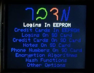

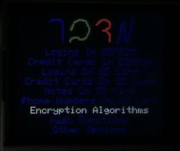

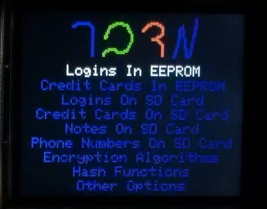

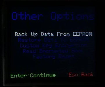

After you've unlocked the vault and got to the main menu:
- Press the "↓" (DOWNWARDS ARROW) key on the USB keyboard to go down the menu.
- Press the "↑" (UPWARDS ARROW) key on the USB keyboard to go up the menu.
- Press either the "Enter" key on the USB keyboard to open the selected menu.
- While in the submenu, press either the "Esc" or the "Backspace" key on the USB keyboard to return to the main menu.

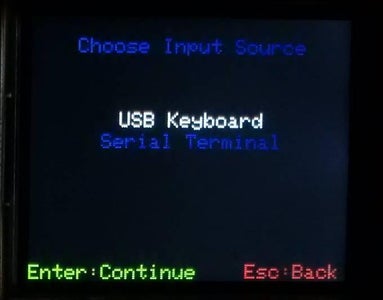

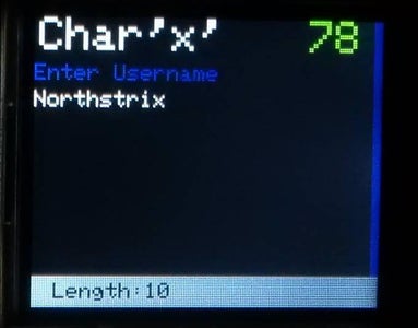

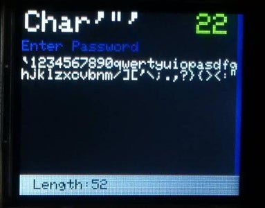

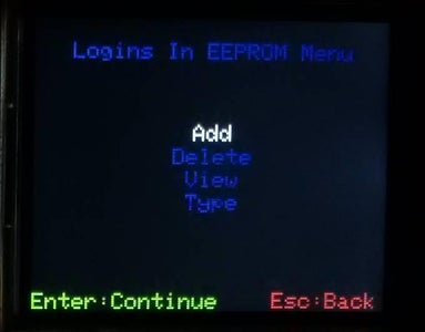

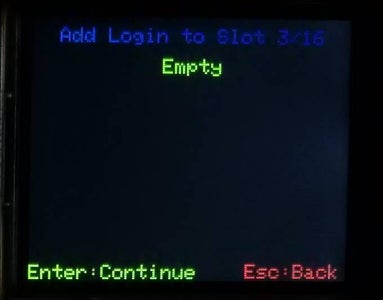

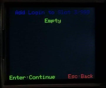

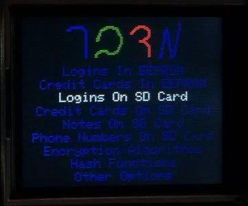

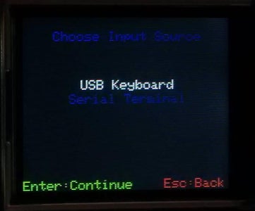

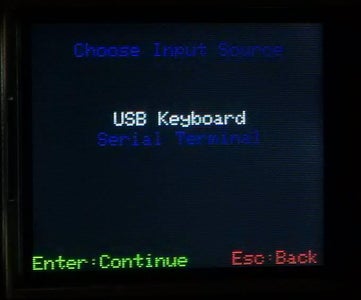

Step 16: Add Login to EEPROM
The Midbar (Teensy 4.1 Version) V3.0 offers 16 slots to store your login credentials in the EEPROM.
To add a login to the EEPROM using a USB keyboard:

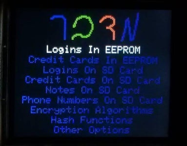

- Select the "Logins In EEPROM" line in the main menu;
- Press the "Enter" key on the USB keyboard;

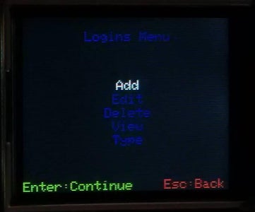

- Select the "Add" line;
- Choose the slot you want to put the login to by using the "←" (Leftwards Arrow) and "→" (Rightwards Arrow) keys on the USB keyboard;
- Select the "USB Keyboard" line;

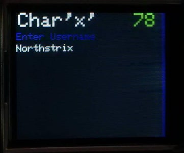

- Enter the username;
- Enter the password;

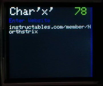

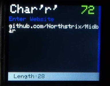

- Enter the website;
- Press the "Enter" key on the USB keyboard.
*All credentials demonstrated here are entirely fictitious. Any similarity to actual credentials is purely coincidental.

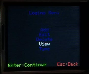

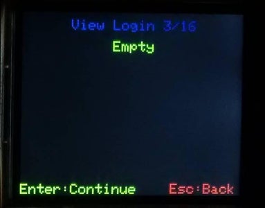

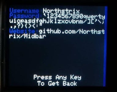

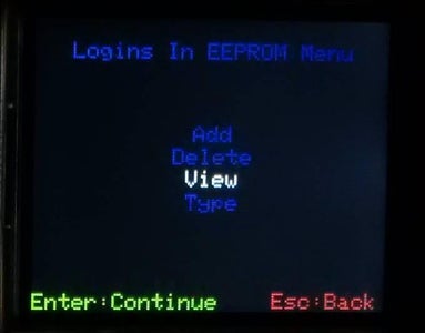

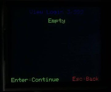

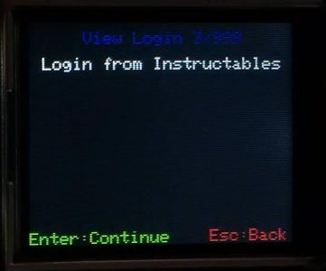

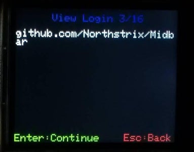

Step 17: View Login From EEPROM
To view a login from the EEPROM:
- Select the "View" line;
- Choose the slot you want to view login from by using the arrow keys on the USB keyboard;

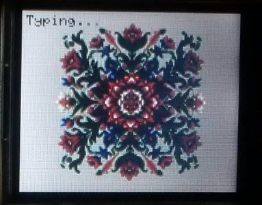

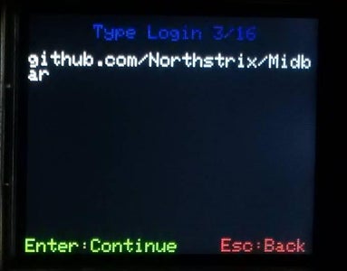

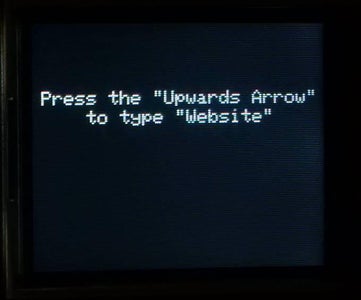

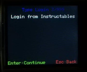

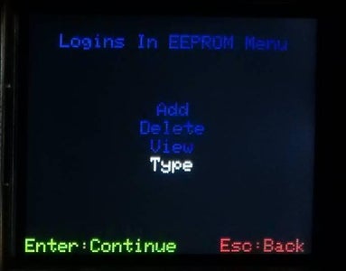

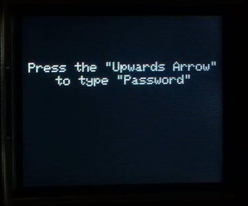

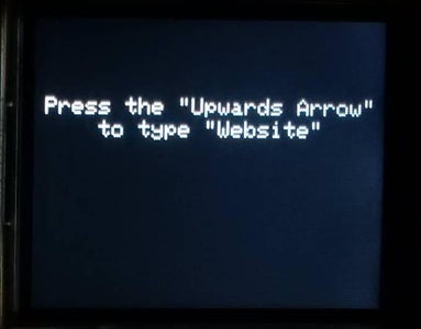

Step 18: Type Login From EEPROM

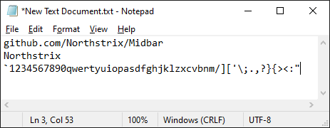

The type feature allows you to use the Midbar (Teensy 4.1 Version) V3.0 as a USB keyboard. In other words, this version of Midbar can input your data to the computer as if you were typing it on a USB keyboard connected to your computer.
To type a login from the EEPROM:
- Select the "Type" line;
- Choose the slot you want to type login from by using the "←" (Leftwards Arrow) and "→" (Rightwards Arrow) keys on the USB keyboard;

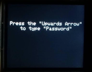

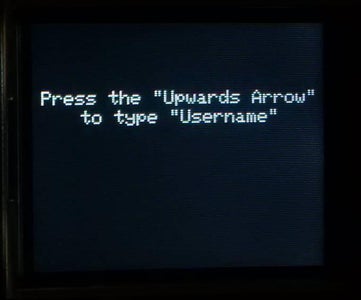

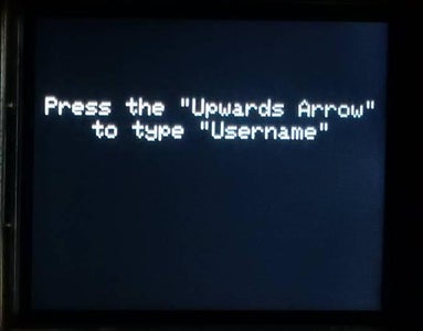

- Press the "↑" (Upwards Arrow) key on the USB keyboard to type the website;
- Press the "↑" (Upwards Arrow) key on the USB keyboard to type the username;
- Press the "↑" (Upwards Arrow) key on the USB keyboard to type the password.

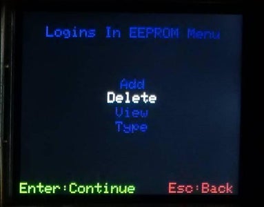

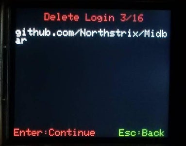

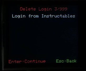

Step 19: Delete Login From EEPROM
To delete a login from the EEPROM:
- Select the "Logins In EEPROM" line;
- Select the "Delete" line;
- Select the login you would like to delete by using the "←" (Leftwards Arrow) and "→" (Rightwards Arrow) keys on the USB keyboard;

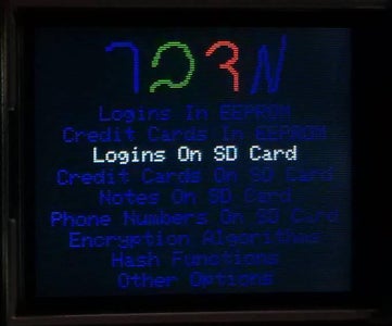

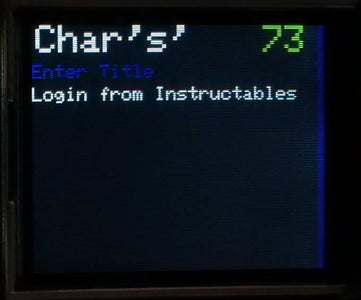

Step 20: Add Login to SD Card
With the Midbar (Teensy 4.1 Version) V3.0, you can store as many records on the SD card as you wish, as long as there is enough space on it.
Each record stored on an SD card has its own encrypted (verification) tag and a unique IV for each field.
To add a login to the SD card using the USB keyboard:

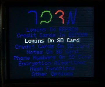

- Select the "Logins On SD Card" line in the main menu;
- Choose the slot you want to put the login to by pressing the "←" (Leftwards Arrow) and "→" (Rightwards Arrow) keys on the USB keyboard;
- Enter the title;

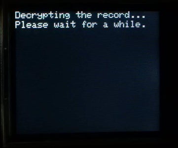

Based on the tests I've conducted, the Teensy 4.1 is capable of encrypting and decrypting a string of 10 000 characters using the 3DES + AES + Blowfish + Serpent encryption algorithm in CBC mode. Technically, you can put 10 000 characters into a field of a record.

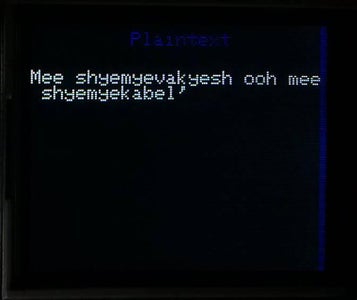

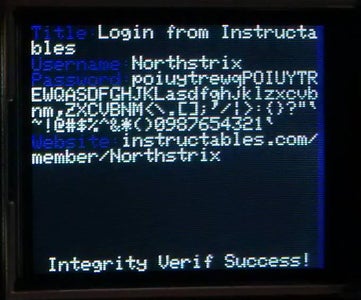

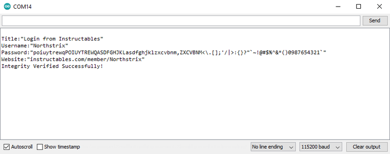

Step 21: View Login From SD Card
To view a login from the SD card:
- Choose the slot you want to view login from by pressing the "←" (Leftwards Arrow) and "→" (Rightwards Arrow) keys on the USB keyboard;

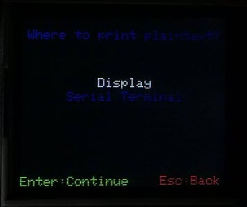

- Press the "↑" (Upwards Arrow) key on the USB keyboard to print the record to the serial terminal. Note that this feature isn't available for the data stored in the EEPROM.

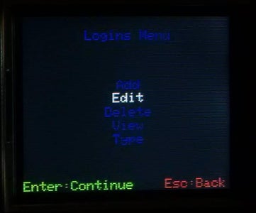

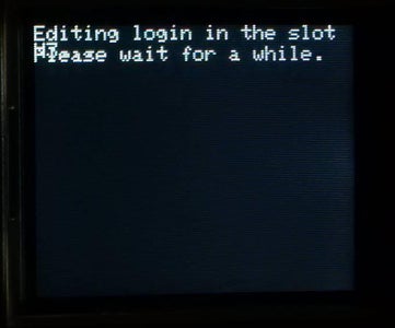

Step 22: Edit Login Stored on SD Card
To edit a login stored on the SD card:

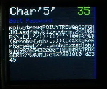

- Select the "Edit" line;
- Select the login you would like to by pressing the "←" (Leftwards Arrow) and "→" (Rightwards Arrow) keys on the USB keyboard;
- Select the input source;
- Depending on the chosen input source, either enter the new password you'd like to set on the USB keyboard or paste it to the Serial Terminal;
- Depending on the chosen input source, either press the "Enter" key on the USB keyboard or press the "Send" button in the Serial Terminal.

Step 23: Type Login From SD Card
To type a login from the SD card:
- Choose the slot you want to type login from by pressing the "←" (Leftwards Arrow) and "→" (Rightwards Arrow) keys on the USB keyboard;
Step 24: Delete Login From SD Card
To delete a login from the SD card:
- Select the "Logins On SD Card" line;
- Select the login you would like to delete by pressing the "←" (Leftwards Arrow) and "→" (Rightwards Arrow) keys on the USB keyboard;

Step 25: Encrypt String
The Midbar (Teensy 4.1 Version) V3.0 utilizes seven encryption algorithms. You can use any of them to encrypt your data.
To encrypt string:
- Open the Serial Terminal (because the ciphertext is printed to it);
- Select the "Encryption Algorithms" line in the main menu;
- Select the line with the name of the encryption algorithm you would like to use;
- Select the "Encrypt String" line;
- Choose the input source;
- Depending on the chosen input source, either enter the text you'd like to encrypt on the USB keyboard or paste it to the Serial Terminal;

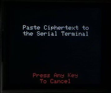

Step 26: Decrypt String
To decrypt string:
- Open the Serial Terminal (because you'll need to paste the ciphertext to it);
- Select the line with the name of the encryption algorithm you've used to encrypt the text;
- Select the "Decrypt String" line;
- Choose where to display the decrypted string;
- Paste the ciphertext to the Serial Terminal;
- Press the "Send" button in the Serial Terminal.

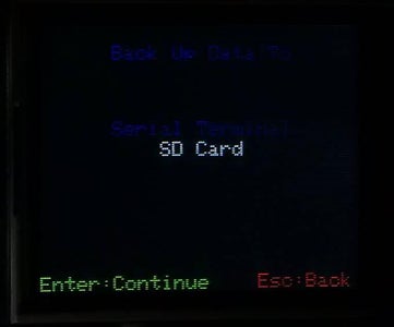

Step 27: Back Up Data From EEPROM
Another handy feature of this version of Midbar is its ability to easily back up the EEPROM data to the Serial Terminal or the SD card.
To back up the EEPROM data to the SD card:

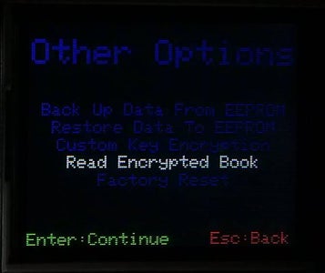

- Select the "Other Options" line in the main menu;
- Select the "Back Up Data From EEPROM" line;
- Select the "SD Card" line;
After you back up the EEPROM data to the SD card, the "Midback" file should appear there.
*Note that the factory reset will also erase the backup of the EEPROM data from the SD card.

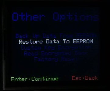

Step 28: Restore Data to EEPROM
You can restore the EEPROM data from the SD card or the Serial Terminal.
To restore data to the EEPROM from the SD card:
- Select the "Restore Data To EEPROM" line;
