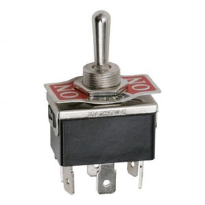

  • Three-position two-circuit switch

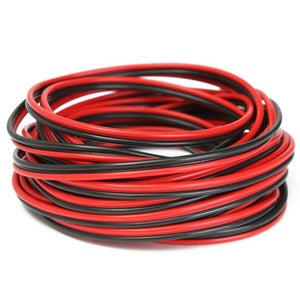

  • Wire

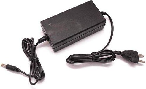

  • 12V 5A power supply

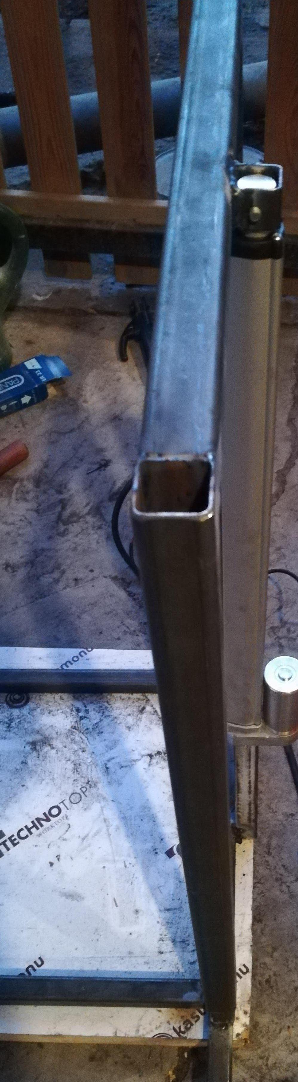

For the base structure I have chosen 25mm x 25mm x 2mm square section steel closed profile. For the sliding item I used a 30mm x 30mm x 2mm square profile, because its inner dimension matches for the other profile's outer dimension pretty well.
Step 2: Make the Sliding Items
I cut some square pieces from metal for the fixing tabs and welded them to the frame. The top items slide on the bottom vertical legs.
After welding I painted them with two layers black paint, and they got plastic plug to the end holes. Finally I built in the actuators with screws.

According to the specification of the actuator their load capacity is 1500 N. I tested them with a regulated laboratory switching power supply and it showed 3-4 amps during the lifting phase.
