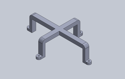

The mechanical design starts from the number of servomotors to be used per leg. In this project it was decided to use 2 servos per leg, giving it a greater number of degrees of freedom and making its naturalness remarkable. It is clear to mention that in any type of mechanisms, machines or robots the more degrees of freedom you have, the greater the naturalness of your movements and actions. Within the plan for this project, requirements and limitations, there are 12 actuators to be used, 2 per leg. As mentioned, the servos motors will be the main components of the legs, let's say they are those points that represent the joints of the robot. By which different movements to the machine are triggered that, together, will simulate the movement making it walk. Based on the dimensions of the previously mentioned servomotors, a casing is designed in which this type of actuator is fitted. The dimensions of this one provide reference points to design a fastening system, for the supporting elements and connectors for what will make up the leg as a whole. One of the servo motors is positioned vertically and the other horizontally, this is mainly due to the direction in which its shaft will rotate and activate the element to which it is screwed and thus develop the movement in x or y, necessary for the walking of the hexapod. When looking at the figures and images, you can see the points where they are assembled to the main based, which are the plates, of the robot. If you take a look at the servomotor in an upright position, you will see it is between both plates. One of them being screwed in the upper part and the other in the lower one. From there, connectors and bars will facilitate the support for the second servomotor in a horizontal position, from which 4 different types of connectors work as part of the leg. These allow the mechanical movement that simulates and activates the lifting and moving of this element; which includes these two bars that hold the largest component of the leg, on which it rests and leaves almost the entire weight of the robot.
As mentioned before, there are limitations that define your design. They can be different types whether mechanical, economic, or any other essential resource for the operation of your machine. These mechanical elements; in this case the servomotors, established the dimensions of the robot. This is why the design proposed in this manual is of such dimensions, since they start mainly from the selected actuators and controller, to which a large battery was added later.
It is important to say that the mechanical design is not defined to be replicated as it is proposed. This can even be optimized through simulations of stress and fatigue of the main elements, bars and / or connectors. Taking into account the selected manufacturing method, additive manufacturing, you can make the most of designing, simulating and printing the solid that best suits your loads and application. Always considering the basic elements of support, fasteners and bearings, for what you need. This according to the role they play in the mechanism. So you should think about the specifications of these elements so that they have the appropriate place in conjunction with the other pieces of the leg.

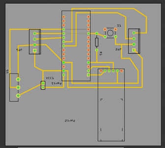

2 PCBs where designed for the robot.
1 is the main board that will be mounted in the robot and the second one is for the electronics in the remote controller. The PCB was designed using the Fritzing software and then machined using a CNC Router for PCB engraving.
The main PCB includes the Arduino Mega as well as the bluetooth module, all the servos are connected as well and using two lines of power that come directly from the battery to 2 screw terminals.
The remote controller PCB has more components but is more compact, starting with the mounting of the Arduino Nano, to it it is connected the two joysticks to control the direction and movements of the Hexapod, one push button with its appropriate 220Ohms resistor, a potentiometer to adjust the height of the robot and its bluetooth module HC05. All of the board is powered using a 9V battery and the elements on it are powered using the 5v Output of the Arduino board.
After the design, the PCB can be manufactured with the special CNC PCB machining tool and then you can proceed to install all the components in the boards.

After having all the printed parts, screws and bearings available as well as the tools to assemble the robot, you can start with the assembly of the corresponding parts, considering that the bases of the vertical servos are assembled having an upper plate and a lower one, 6 of these pieces with a servomotor inside them. Now the coupling to the shaft of the servomotor is screwed and to this the piece is connected: "JuntaServos" that in its counterpart would have its corresponding bearing to facilitate the rotation between both parts. Then it would be connected to the second servo, the horizontal servo and its respective set of bars that link with the other 2 segments, making a direct attachment to the steel tip. Both bolted with the indicated screws. To finish with the leg, the tip printed in PLA is inserted under pressure.
This procedure must be repeated 6 times to assemble the 6 legs that support and activate the robot. Finally; position the camera on the upper plate, adjusting it as desired by the user.
