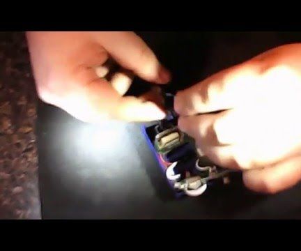

You have several options here. Go with what sounds the best to you. I went with a smart strip from Wal-Mart that claimed that when a master (PC) was turned on and off it killed power to everything else. It does not, but that may be due to the fact that it's a cheap model and doesn't detect my PC. Other strips have remote controls, battery backups, and other cool features. Find what's right for your project, but remember - if you don't use some kind of smart solution you will have to unplug your machine to turn all the components on and off.
Note: My smart strip didn't work as advertised but I have heard other people tell me that theirs worked just fine. I got around the issue by plugging everything into hot ports. When I want everything off, I just unplug it from the wall. My plug is easy to access so it was no big deal for me. Another method is to get one with a remote switch. You can then attach the switch to the back or top of the unit using double stick tape.

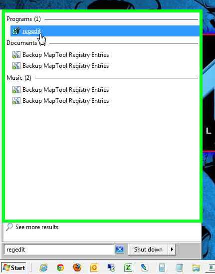

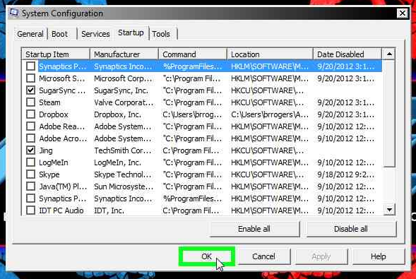

Note: While I'm saving this for another "Software Hack" tutorial a little later, you should set your PC power button to "shut down" windows rather than to cut power. This will safely boot up and shut down your computer with a simple button press and save you from having to keep a keyboard around to navigate windows just for an on/off function.
