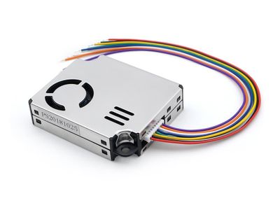

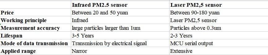

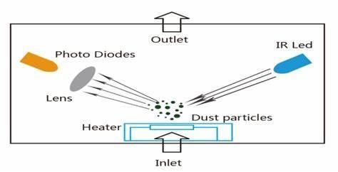

The structure and circuit of the infrared principle PM2.5 sensor are relatively simple. The light source is an infrared LED light source. The air inlet and outlet mainly rely on resistance to generate heat to obtain hot air flow. When particles pass through, reflection occurs after touching the LED light source. The photosensitive detector receives reflected light of different intensities, and then through amplification processing and gets the detection result after operation.
The structure and circuit of the laser principle PM2.5 sensor are relatively complicated. Its light source is a laser diode. The sampled air is pushed by a fan or blower and passed through a complex design of the air duct for detection. When the fine particles in the air enter the area where the laser beam is located, the laser light will be scattered; the scattered light radiates 360° in space, and a photodetector is placed at an appropriate position to receive the scattered light, which is then generated by the photoelectric effect of the photodetector. After the current signal is amplified and processed by the operational amplifier circuit, the fine particle concentration value can be obtained. The output signal can be used in various ways such as serial port, I²C, PWM, etc.
This PM2.5 sensor has the following advantages:
High-precision detection: The PM2.5 sensor adopts advanced laser scattering technology, which can accurately detect tiny particulate matter in the air, including PM1, PM2.5, and PM10.
Easy to use: The PM2.5 sensor is small in size and easy to operate, just place it in a suitable place indoors or outdoors to start monitoring.

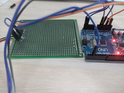

Step 1: Hardware Connection

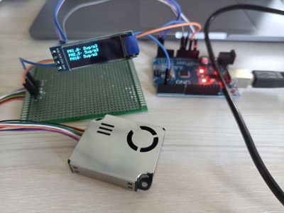

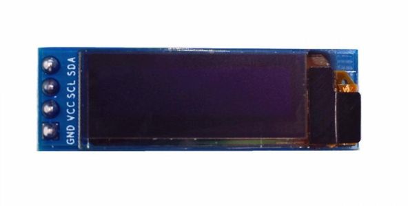

In the PM2.5 datasheet, We can Check the PIN definition to connect the Arduino Uno, the pin5 is in Serial sending mode, so it can connect the digital pin2. The power cable is connected to 3.3V, GND to GND. The SSD1306, can use the SDA to connect the A4, and the SCL to connect the A5. The power cable is connected to 3.3V/5V with Arduino Uno.

Using the Adafruit SSD1306 library, call the display function to display the measurement data.
          display.clearDisplay(); // clear the display
          display.setTextSize(1); // Set text size
          display.setTextColor(WHITE); // Set text color
          display.setCursor(0, 0); // Set cursor position
          display.print("PM1.0: "); // Display PM1.0 data
          display.print(pm1_0_standard);
          display.println("ug/m3");
          display.setCursor(0, 10); // Set cursor position
          display.print("PM2.5: "); // Display PM2.5 data
          display.print(pm2_5_standard);
          display.setCursor(0, 20); // Set cursor position
          display.print("PM10: "); // Display PM10 data
          display.print(pm10_standard);
          display.display(); // Update screen display
Step 3: Result

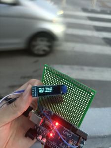

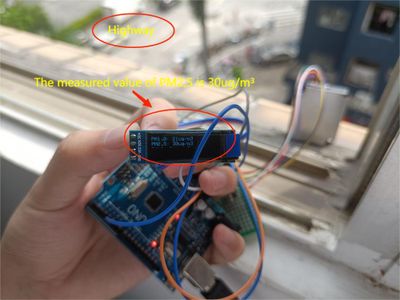

As can be seen from the picture, the PM2.5 content detected by our purchased household air freshener is only slightly different from the data measured by our detector (within the acceptable error range), and when We put the sensor by the window near the road, and we can clearly feel the increase of PM2.5 content in the air. On the road with more dust, the content of PM2.5 also increased again. Therefore, we can check the PM2.5 air comparison table by measuring the value of PM2.5, and we can know whether the place where we live will affect our health and safety.
